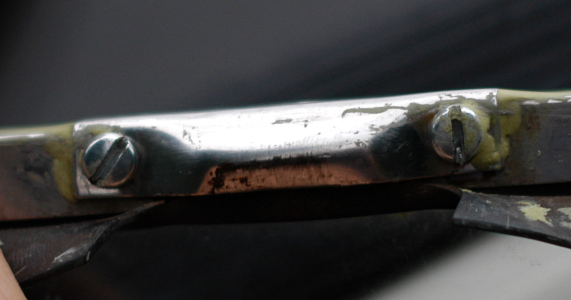

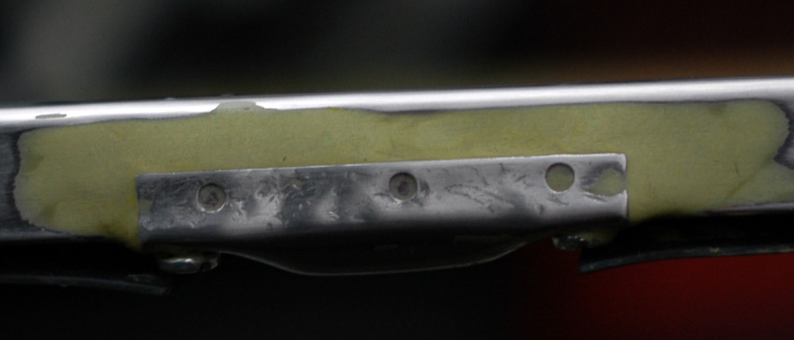

Couple of self tappers did the trick in the end:
then I smoothed off the join with a bit of Milliput (waterproof, dead easy to sand etc) to cut down on the tendency of these things to scratch the door as they shut
Finally, adjusted the catch and now it shuts like a dream.

Had the same problem with passenger door window - I used a metal - metal adhesive as a quick fix before I went to Coventry for the weekend and it still seems to be holding up a treat!

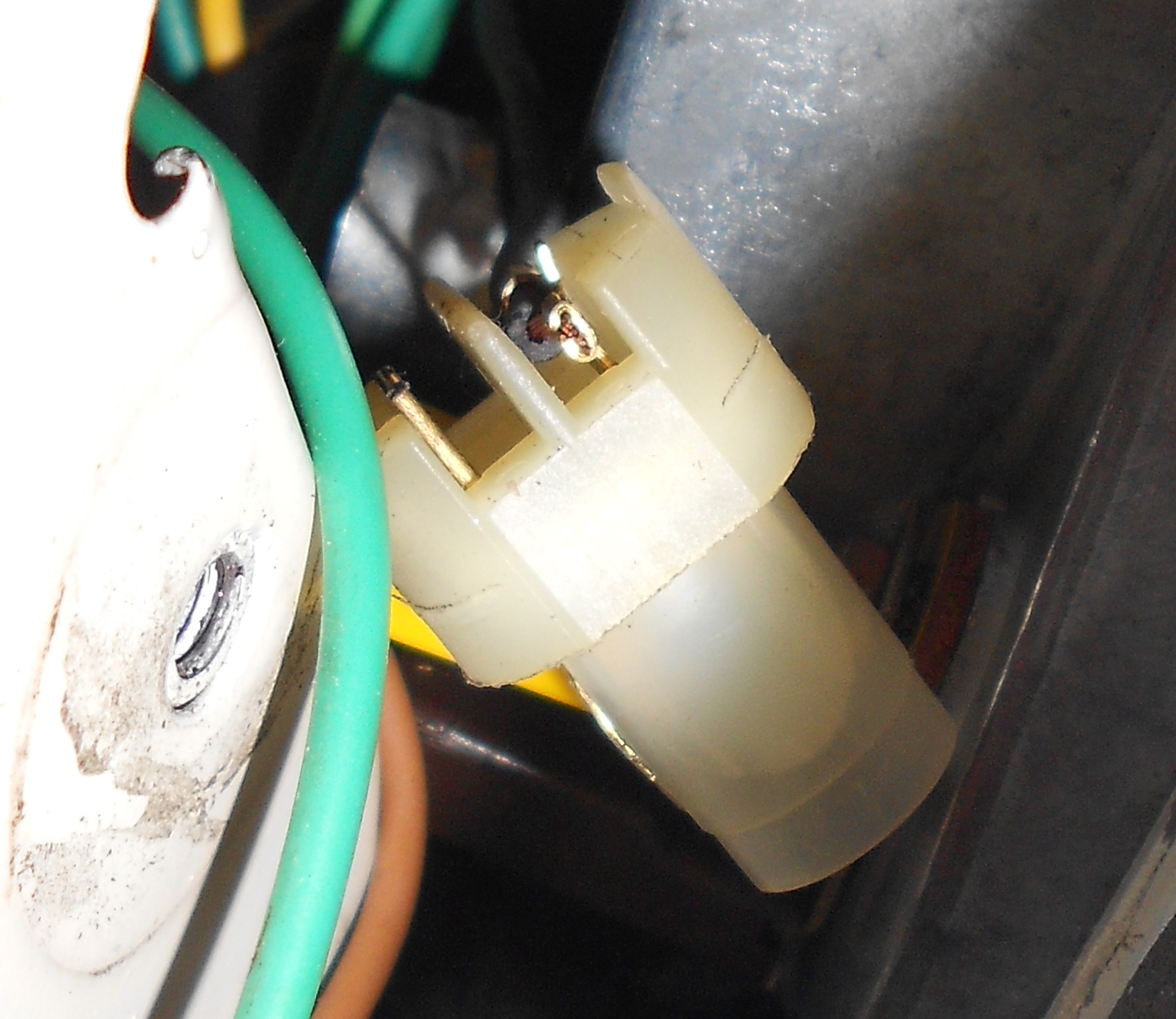

Dashboard light doesn't work. So I wrestled the dash forward, and took a look at the light and the fitting. This is what I saw:
Question is: is there a cable missing here? Should there be another lead, attaching to the connector shown on the left in the pic?
