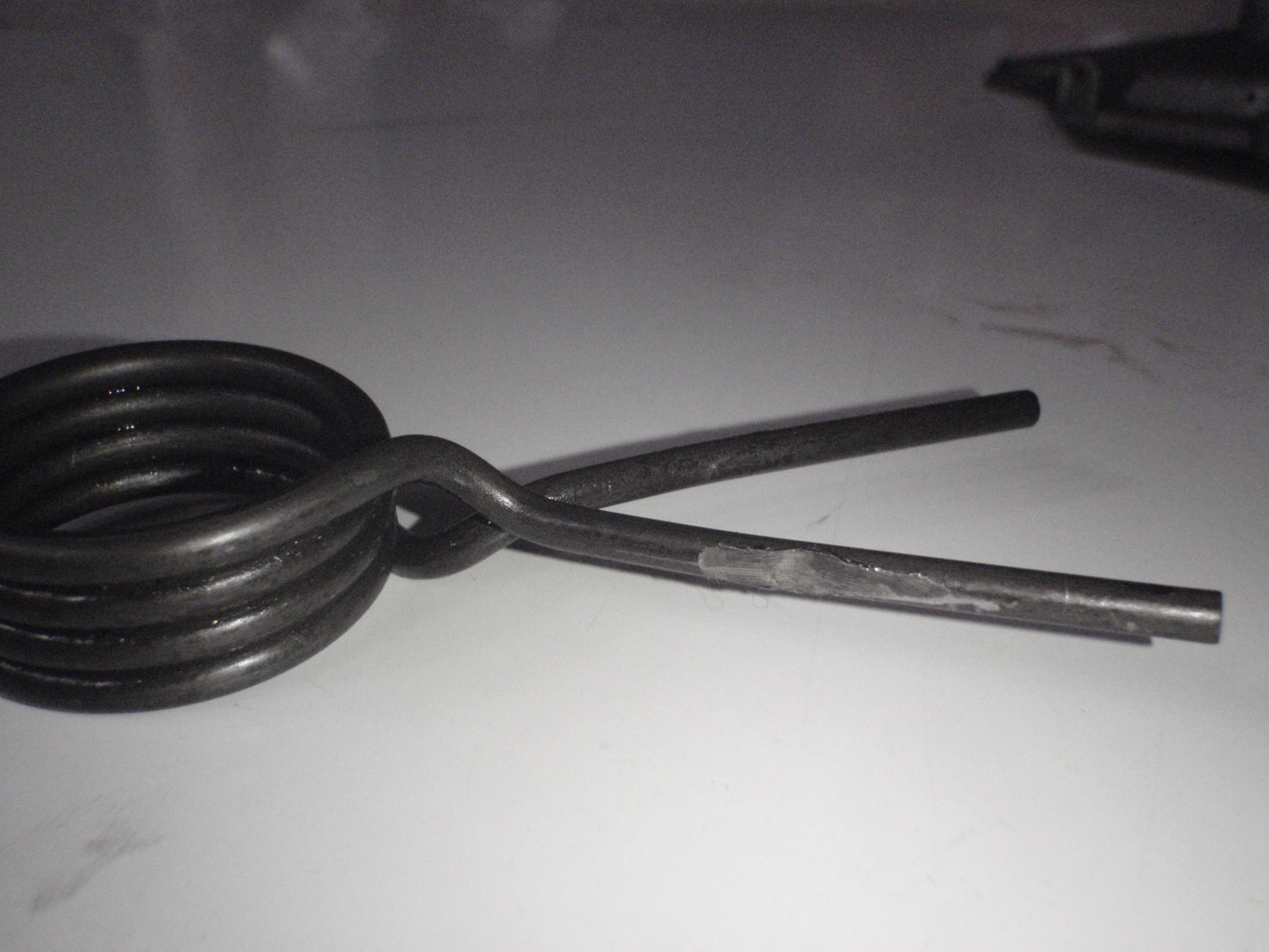

Viking, what does that image show?
March 2nd, 2011, 3:39 pm
Ah ok gearbox pin - my bad.

2CViking wrote:
ken wrote:
Ah,
that'll be another of those gearboxes which have the hairpin spring in the lid almost worn through, then. :roll:
ken.
Jonathan wrote:
I always tend to go sideways and down/in when changing from third to fourth gear, I think it's a much smoother, quicker change than pushing and pulling through neutral.
Like this
Replaced
:? I'm still absolutely none the wiser, sorry. I've no idea what that is, where it is and what it does/doesn't do :roll:
March 2nd, 2011, 6:21 pm
Inside the box lid. The spring is ''returning'' the lever after you pull the lever left or right.
March 2nd, 2011, 7:25 pm
Jonathan,
by 'preloading' the gear change lever towards the 4th gear position, instead of moving it to the neutral position and then twisting it to the right, the rate at which the spring is worn is increased.
Or at least that's what I think must happen, as some springs can be worn almost halfway through, whereas others are almost 'as new'.
March 2nd, 2011, 9:46 pm
ken wrote:
Jonathan,
a habit i need to get out of, ive always love "pre loading" the gear, i thought it was designed to do that, and thought it was a genius piece of engineering, oh well!
March 2nd, 2011, 10:37 pm
I wouldn't worry about it. Most springs are less worn on the 4th gear side as the 1st and reverse is used much more. So James keep doing what you are doing, it won't make any difference. The Spring is not used between 2nd and 3rd since the shift is not sideways. In 1st and reverse the lever always comes from neutral.
