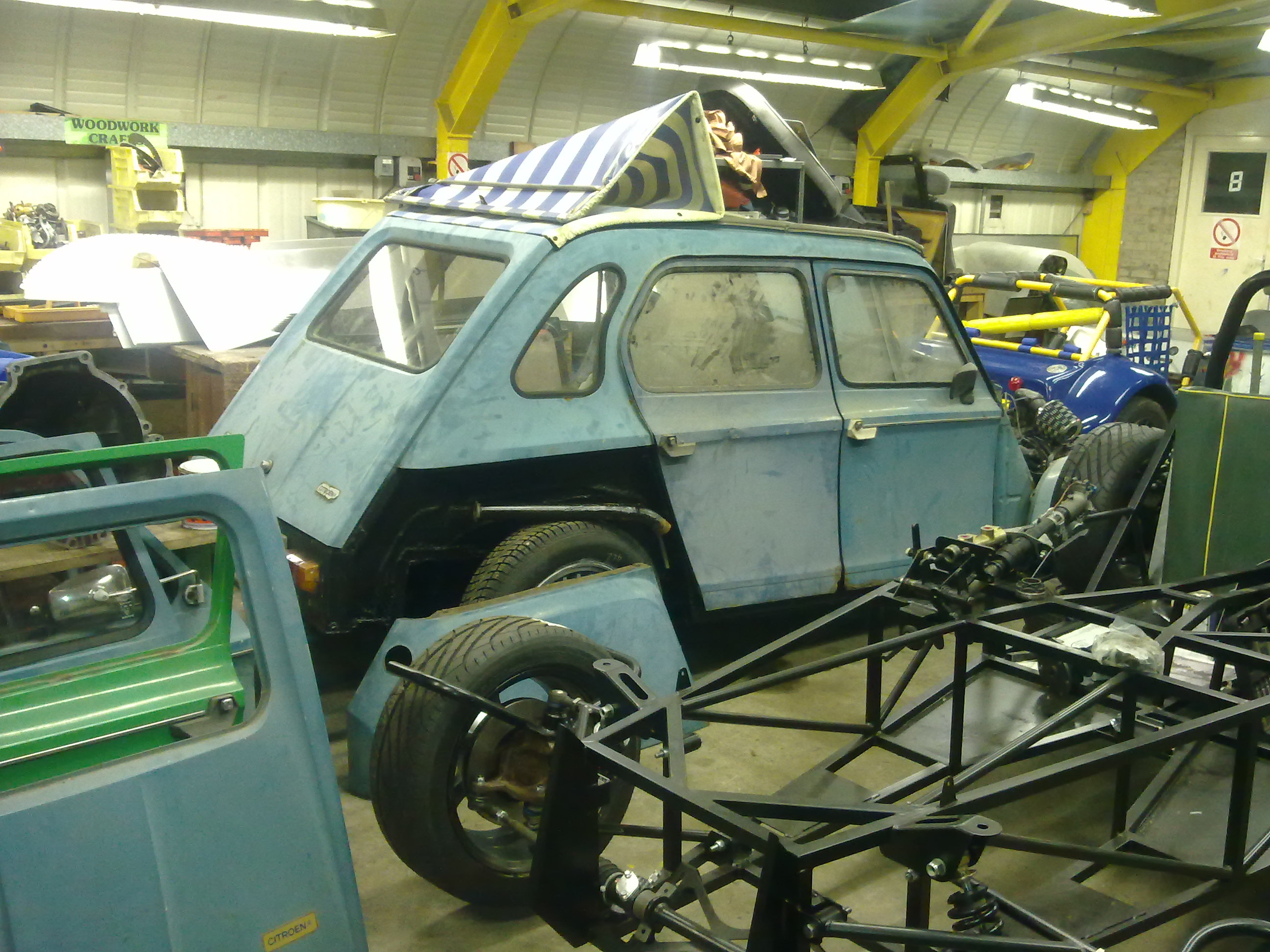

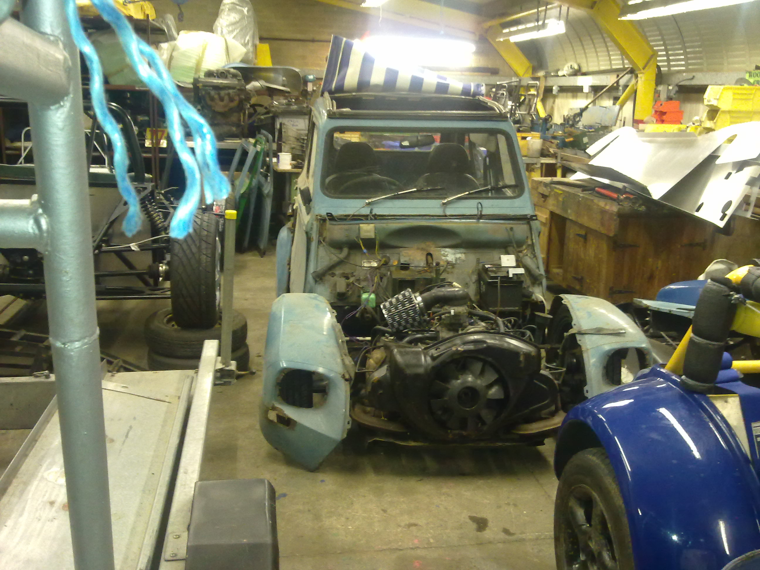

In its new home for the next couple of months or so...Plus its sporting a couple of replacement doors on the drivers side plus the front wings..(great colour match hey!!)

looks like an interesting workshop and sorta warm and comfy, plus the light looks great! I struggle squashed into a garage with poor lights, Neil even more so!
great project and great to see another flat 4! give me a PM if there is anything specific I might be able to help with, wiring, fittings etc... I can try!

Tim.... Isn't it just get about 8 cars in there, only got 4 at the moment and a trailer, great light although does get a bit cold this time of year (unless u stick the heating on!!) working on a Zero kit car aswell as apart of a youth motor project which is what you can see in one of the pics!!
