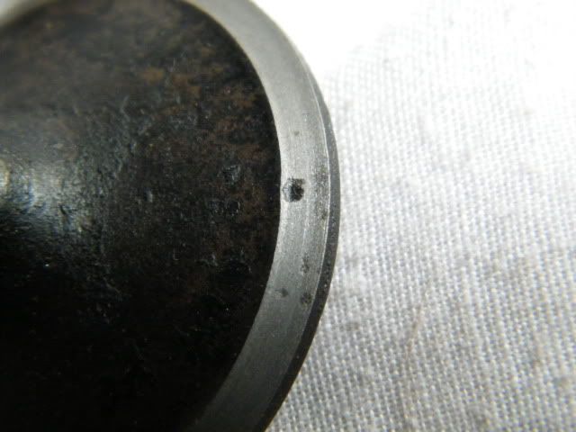

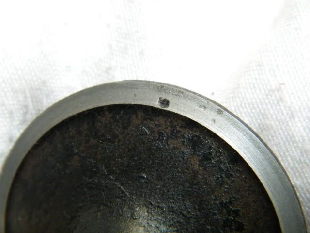

My o/s intake valve.
All the others are fine, the rest of this one is fine but for the patch of pitting shown below (Difficult to photograph)
It seems like rather a lot to grind, just with grinding paste and a stick etc. and I'm reluctant to do too much, because presumably it grinds the valve seat down as well. Reading the description ecas provides, I don't really want to replace valve seats myself OR pay someone else to do it OR buy new heads.
Should I replace that valve? Can one just replace individual valves, or is it best to do the whole lot?

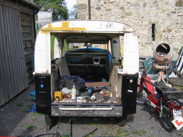

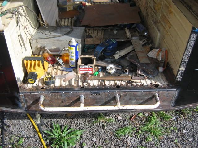

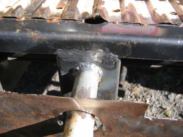

In the mean time I've been doing some more bodywork.
Most of the rear end is either welded or tacked in place now. About an hour of welding should have that done. It's like some Chinese puzzle getting the bumper and all associated gubbins fitted in the right order. Of course I could have just brought a replacement part, and made life much simpler, quicker and easier - but where's the fun in that?
And this picture is to celebrate firstly a mobylette passing it's MOT despite 3 pages of advisories, and secondly picking up an original Citroen style tow bar on ebay for £11. 8-)
^ Max towing weight: 25Kg braked :oops:
