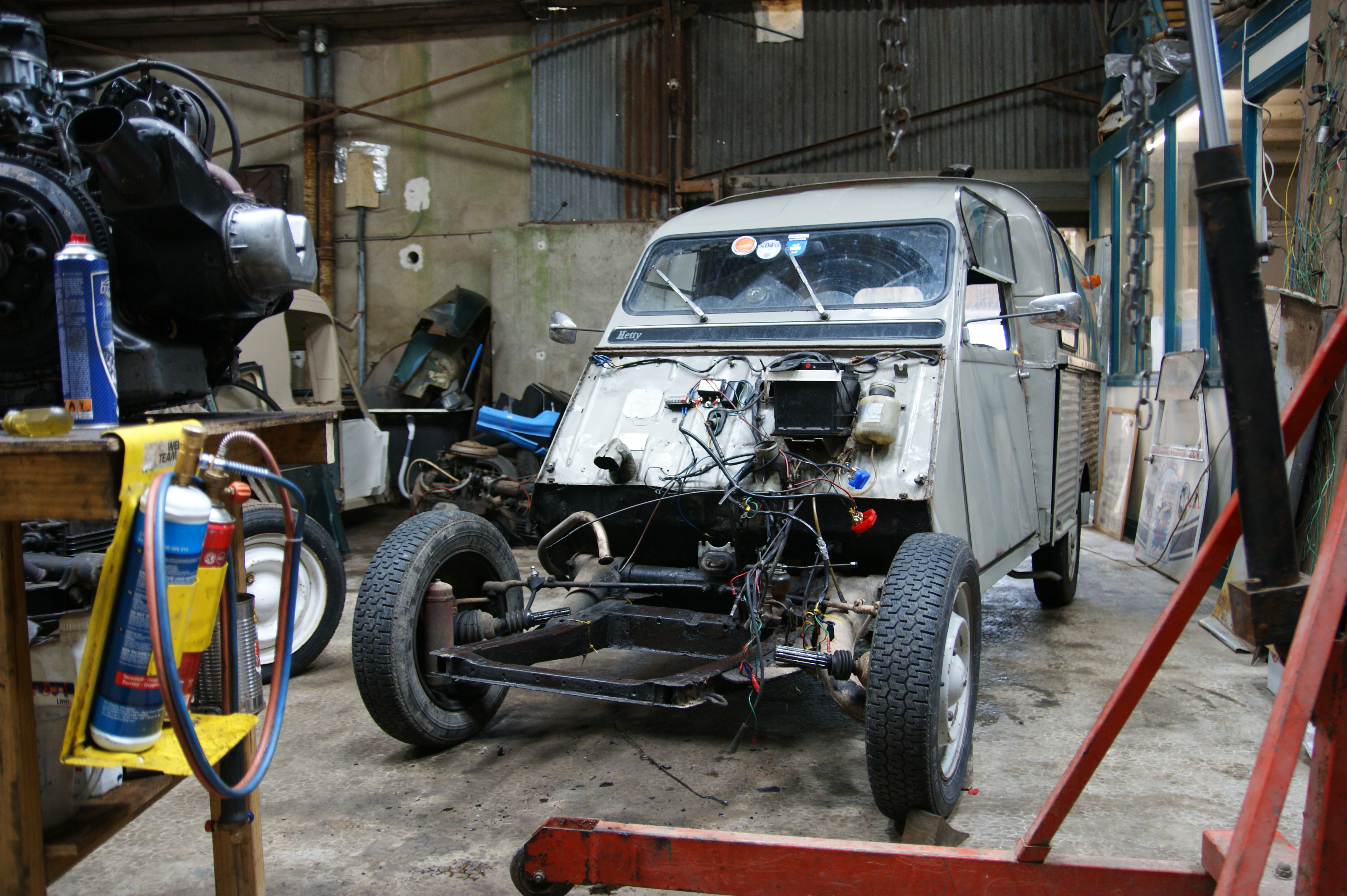

Peter's place is like nothing you can imagine. Pictures tell a thousand words so:
That's Peter's 350 Freya - later model than Hetty with M28 engine.

Coincidence is a funny thing. Hetty's gearbox broke at the year's biggest gathering of 2cvs. I get recovered to the workshop of a gearbox expert and, camped not 200 yeards down the road, are my neighbours Bob and Carol Brotherhood who live around the corner from mt parents house in Sussex. Weird.
Bob came along and we made short work of removing the engine and gearbox in one lump with help from Peter's awesome engine hoist.
I was amused at how removing the weight altered the suspension of the van.

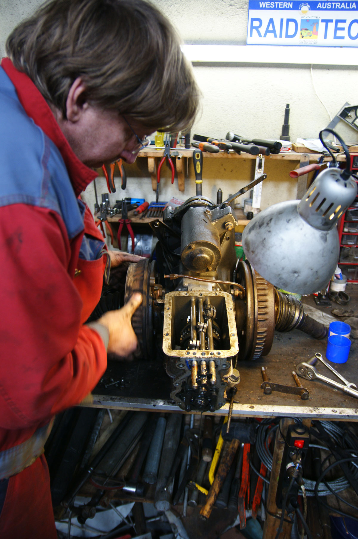

Peter again opened up the 'box and removed the rear cover.
Watching Peter dismantle a gearbox is a sight to behold, the deftness with which he handles all the components is astonishing. I watched eagerly and Peter gave me a running post mortem of what he found. The goo around the end cover showed that the 'bos has been opened in the past. Hetty has, at some point, had the wrong first and reverse gear components fitted. Older cars have a slightly different setup, but the components which create the first and reverse gears are from a later D*lly box and because of this, there was substancial play in those components.
Having got over my misunderstanding that gearboxes are full of fairies and magic I also began to understand my second misunderstanding. 'Gears' are not a physical thing. There are no neatly arranged cogs for first, second, third, fourth and reverse. Its all a matter of semantics. When we change 'gear' a number components in the box are moved to create a new ratio.
In a effect, what we call a 'gear' is actually a ratio created by the interaction of different components.
Peter continued his explorations until he found the cause of the issue.
What you're looking at is an inner drive shaft. A sheared inner drive shaft to be precise. This shaft (correct me if I'm wrong Viking) is attached to the differential. Because this sheared, it possibly saved the entire box.
My initial concern was that my driving style or lack of maintenance had caused the issue, but Peter assured me that unless I'd been 'Kangarooing' (I haven't) there was no way that I could have caused this, it was just metal fatigue. Interestingly, in all his time as a Citroën mechanic and in his years at Viking, Peter said he'd never ever seen this failure on a gearbox. Wahay, I'm unique!
