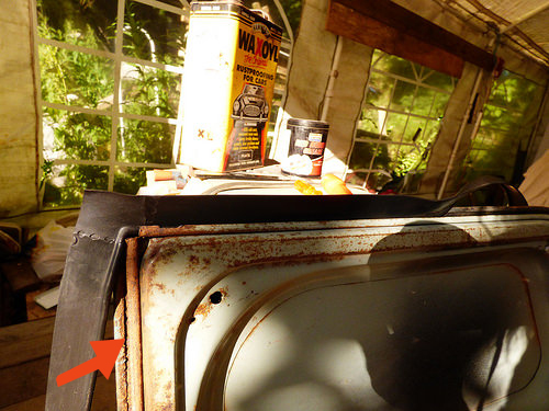

What was left of the old door seal just pulled out easily.
ImageP1020004 by Robndaisy, on Flickr
Just checking that the new one fits ok. It goes in very easily, I'll lash some Waxoyl on the door 'cos it can't harm.
I'd read that fitting seals to 2CV doors is a mission so are the old timers different?

The big fault people make is to bend the profiles over all the lenght. Originallly the are only bend in at the ends. The rubbers are slided in sideways. And yes waxoil or wd-40 help sliding the seals in and give rust protection.
Also put un waxoil between the holders and the doors a forgotten point that rusts happily. First brush the areas out with a steel brush.
