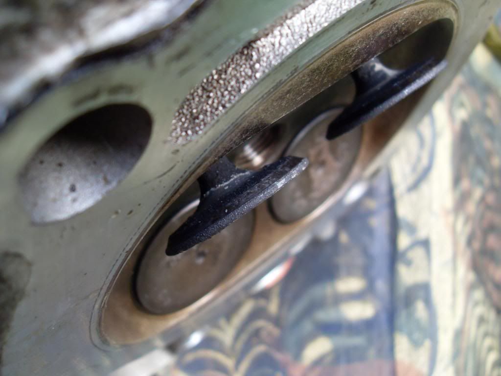

Scrolling down to page 31 of that PDF the damage shown looks similar, and it is next to an exhaust valve. Could it be that the valve clearance was too small, the valve overheated and started glow-ignition? I'll have to try and lift the valve and look at the seating surface. I thought I did the clearances, but I was in a hurry.

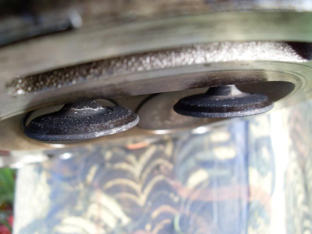

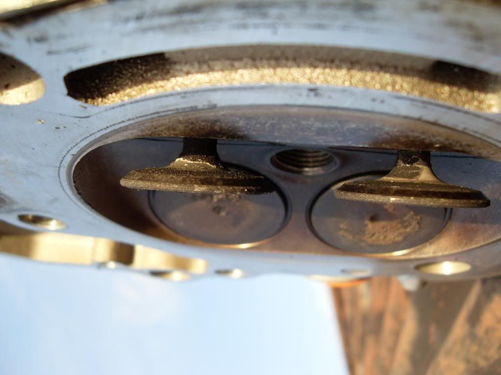

I did eventually get around to looking at the valves, and it was pretty inconclusive. I think it looks normal.
The valves on the other side were similar, except that they were cleaner on the backs as that cylinder hadn't been burning oil.
To be honest I'm not much closer to knowing the exact cause.

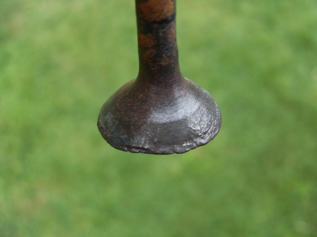

For comparison/amusement, here's a valve from a different engine that I burnt out earlier.

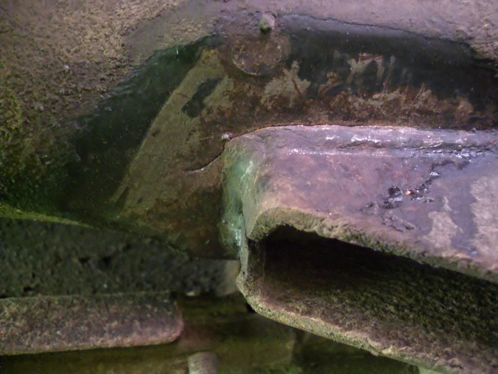

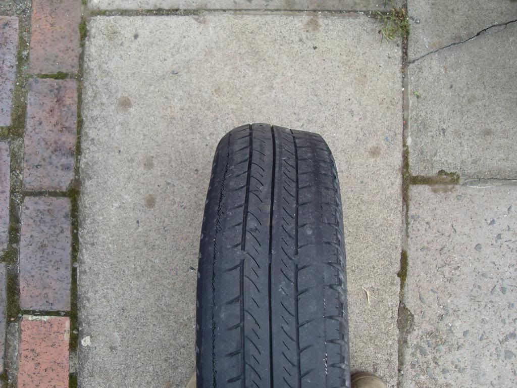

Other stuff, on the journey back from Spain I started getting an odd feeling like an out of center wheel. When coasting up to traffic lights I could feel one rear corner rising and falling with each wheel rotation, I think this tyre has definitely had enough.
I've now swapped to 165/65 all round, they just fit under the rear wings. However while lying under the car checking the clearance I spotted this.
Oh cock! It doesn't look fresh so may have been there for a while, and it's the same on both sides, perhaps from when I overloaded it with the bike on the back. I can't decide whether to take the arms off to weld them at home, or wait until I can get it on a 2 post lift and use a better welder. Trouble is I need an MOT asap and would have to try and hide the cracks with some more dirt! It would be good to get the arms off, I've never checked the arm bearings on this car, but the brake pipes are such a PITA.

Cant vizulize exactly where that is, but could you not remove the tie rod etc snd swing the arm out the way?

Think (may be wrong) its the knife edge mount on the arm.

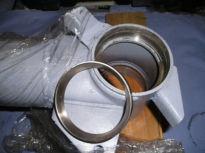

Picture taken from somebody else web site - sorry

James and Chris yes it's the Knife edge mount/tie rod bracket that's trying to part company with the arm, the rear right hand one, picture taken from just in front of the wheel.
