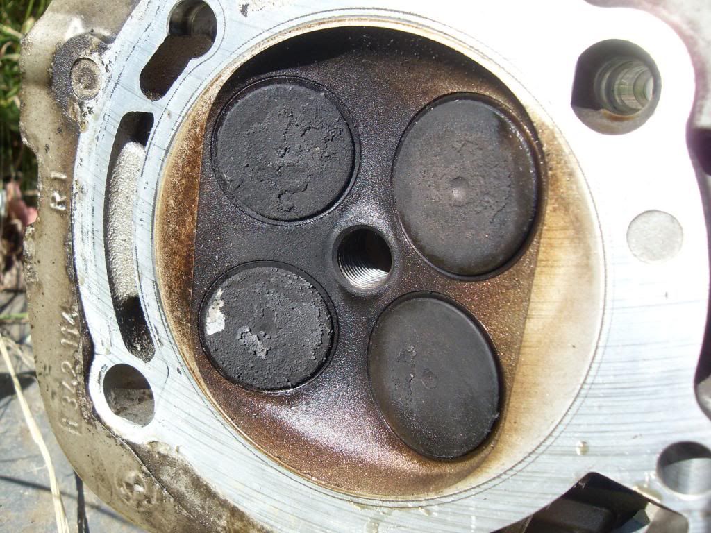

The main area of damage is directly below the lower exhaust valve, I can't see any damage to the head at all.

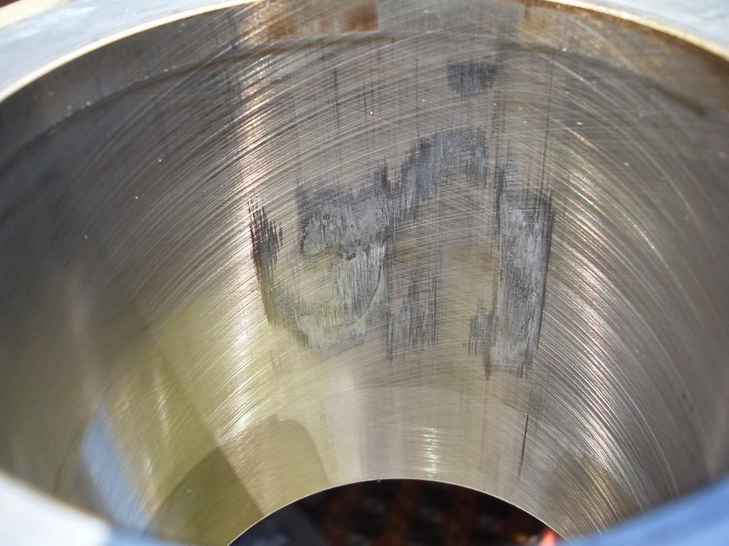

Scuffing to the top side of the bore.

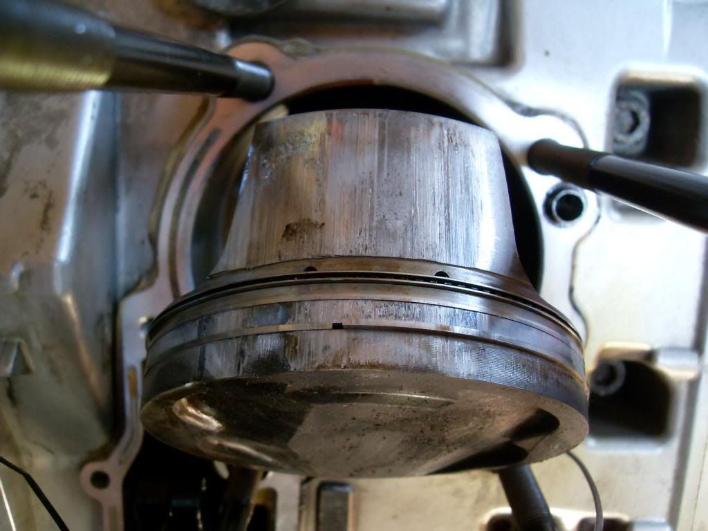

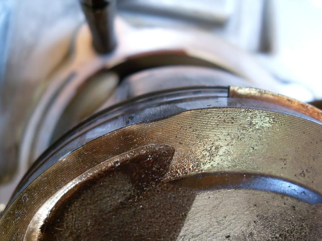

Corresponding scuffing on the skirt, and a small burnt away section near the crown (top land). The rings are undamaged here, just a bit nipped.
