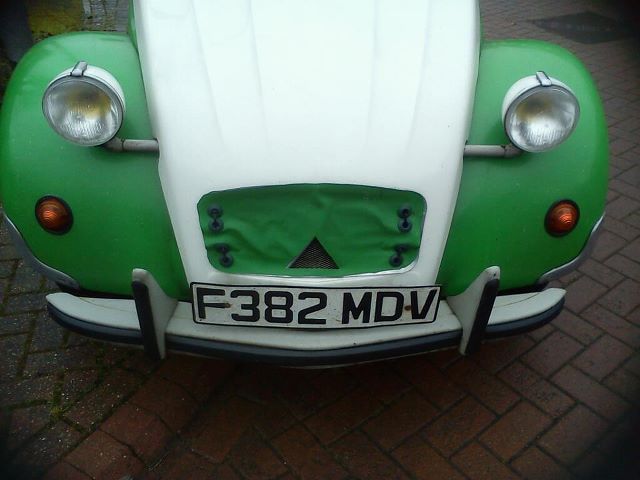

Okay, since having this particular 2CV (April '02) I've had an early '60s grill fitted and no winter grill muff, well from today the car has one fitted :D
I had some spare hood material that pretty much always comes with a new hood (it's an off cut from the fitting of the rear window, for those that don't know), so I removed the grill and went indoors into the warmth. Firstly, I cleaned the aluminium grill with 'Autosol' (highly recommended product), then placed the hood material with the outer side down and put the grill on the inner part of the hood, outer side down. From there I drew an outline with a pen around the grill so giving me a pattern to cut to. Once cut to shape I drew outlines of the grill bars so as to mark where they are to line up tent eyelets with the gaps in the grill. I then drew an outline below the lower chevron to give me the pattern to cut out the air intake for 'winter driving' and folding the muff in half, I cut to shape. I then fitted the eyelets by pushing down on them to make an impression in the hood material and marking with a pen before using a pair of scissors to cut the holes then fit the eyelets. Once all the eyelets (8 in total) were fitted and secure I then refitted the grill to the car and using cable ties I fitted the muff to the grill. Simples.
Below is a photo of muff fitted (I'd just returned from a 5-10 mile drive).

Looks a LOT better than my plastic shitty one!

Looks great! Is there a recommended size for the air intake?
