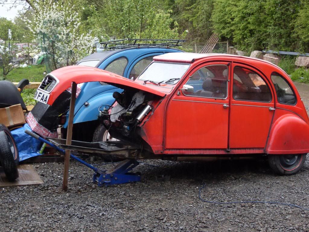

About a month ago I did the front end strip down I was promising, engine, gearbox, and axle, all out.

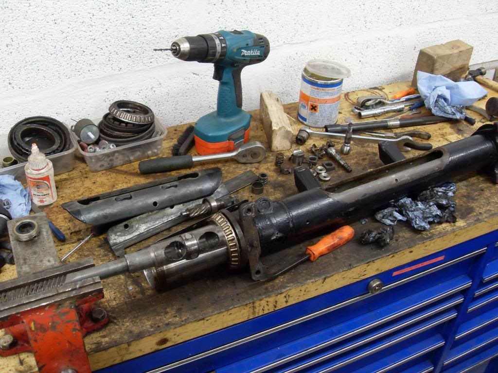

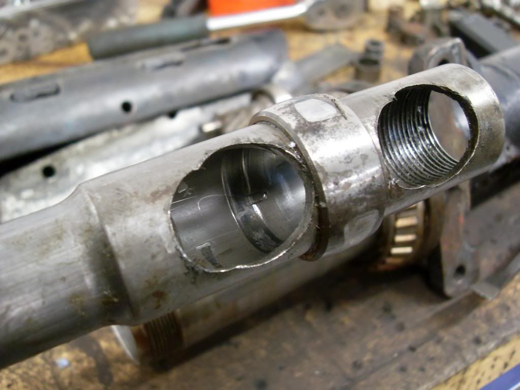

I started with stripping the steering rack, the wear on the guide bush was as anticipated, but being a tightwad I replayed it with a better 2nd hand one, fitted back to front. There was also a bit of wear inside the rack where the cups sit, but without buying a new rack there's not much that can be done about it. The pinion bearings were fine so that went back in. The whole lot was reassembled with plenty of grease, and the only new part used was an anti-rattle rubber.

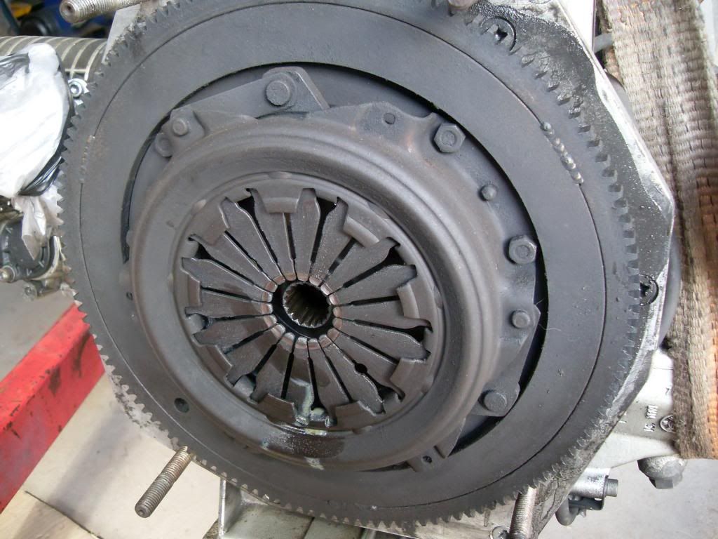

Once the engine and gearbox were separated, it was quite clear that oil had been escaping from the input shaft seal, and not merely getting to the clutch via the brake discs and the cutouts in the bellhousing. The whole clutch was very oily.

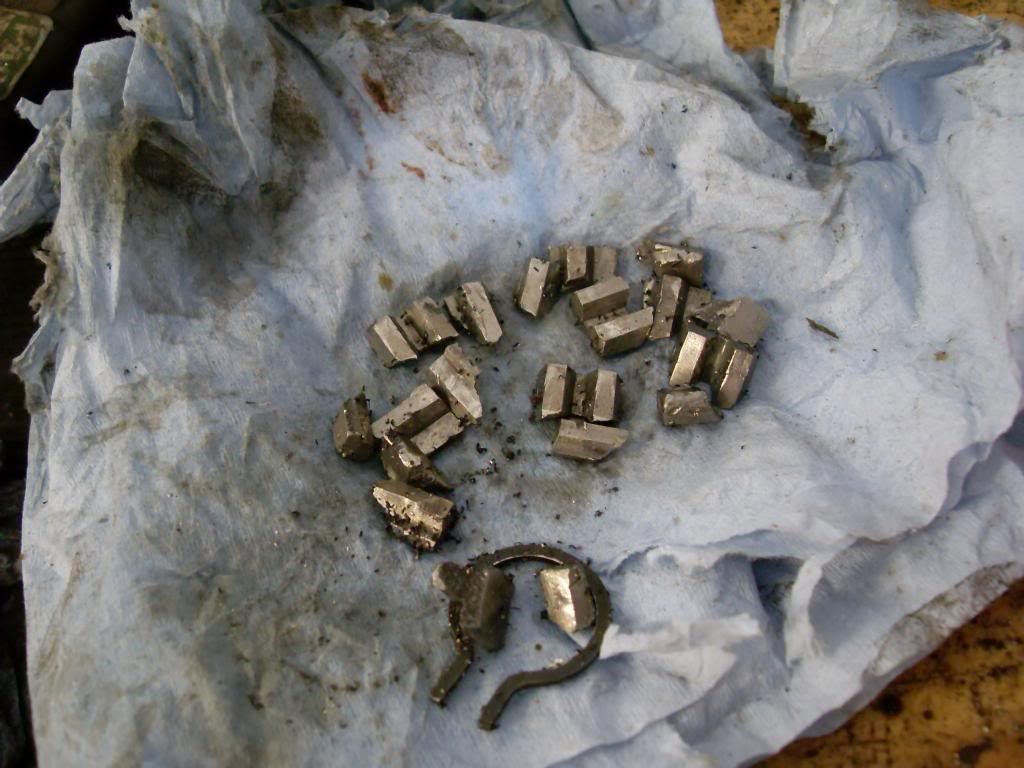

I stripped the gearbox down, and swapped the bellhousing, output shafts, and rear cover onto the replacement. With the bellhousing off, I found quite a large collection of synchro teeth in the bottom. I've said it before, but I'll say it again, I'm amazed at how much better it was working just before I took it out, compared with when it first broke, something I can only put down to the posh oil.
The replacement 1100s engine got built up with a new adaptor plate, the first to be fitted from the new production run, a slightly lightened flywheel and a new valeo clutch. It also needed the rocker covers, inlet adaptors, and alternator swapping over from the outgoing motor.
While everything was out, I took the opportunity to amputate one of the heater vents, it was never going to be possible to connect a pipe to it with the gear lever as it is.
Everything was put back together, which is blooming time consuming, and a new Valeo starter motor fitted. They're expensive, but make hell of a difference to how fast the motor turns over, and starting reliability has improved no end.

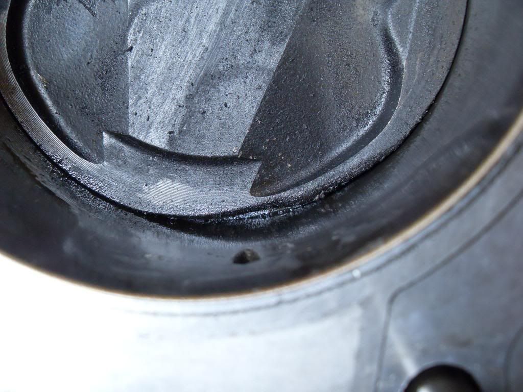

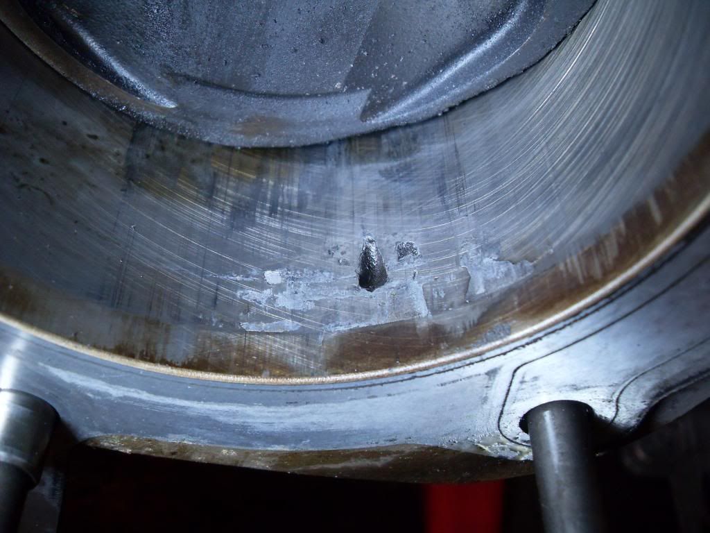

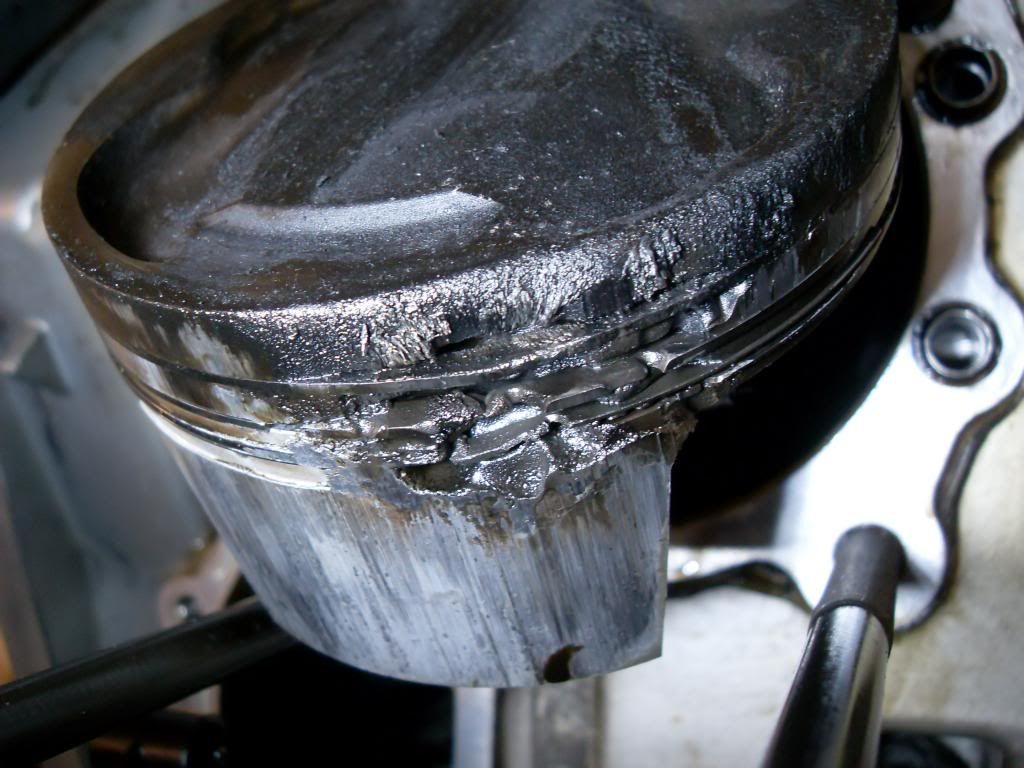

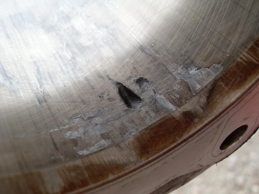

The car was trailered back to the workshop and the engine pulled out again. The oil around the exhaust port was a clue as to which cylinder to investigate. The post mortem pics;
The hole in the cylinder wall is about 3mm deep, I assume it must have been burnt away although it looks like cast finish. The big end is also partially seized, not sure if it's got pieces of piston stuck down the side of the bearing, or if it picked up as a result of oil starvation. Either way I'm going to consider this engine pretty much scrap seeing as I have others, and for now the original one has been refitted.
I would like to try and work out why this failed though, I wasn't being hard on it and want to know if there was an existing problem with the motor, or if something about the set-up killed it.
July 20th, 2013, 2:49 am
Post Re: Joolz's Red One
Joolz,
isn't that damage consistent with overheating leading to partial seizure and nipped or broken rings?
There's evidence above the (remains of) the top land of the pitting and erosion associated with detonation, also plenty of scuffing of the piston skirt and the Nicasil coating on the bore.
That gouge is probably due to a piece of broken ring being juggled around in its groove at TDC. :(
Seen similar on a 2CV engine, except that the gouged portion of the barrel was at BDC and about 20mm wide...
Whats the other piston like??
