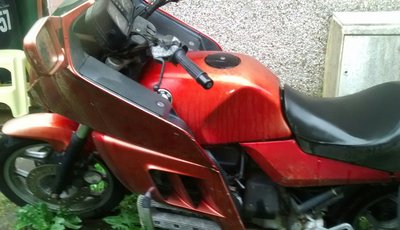

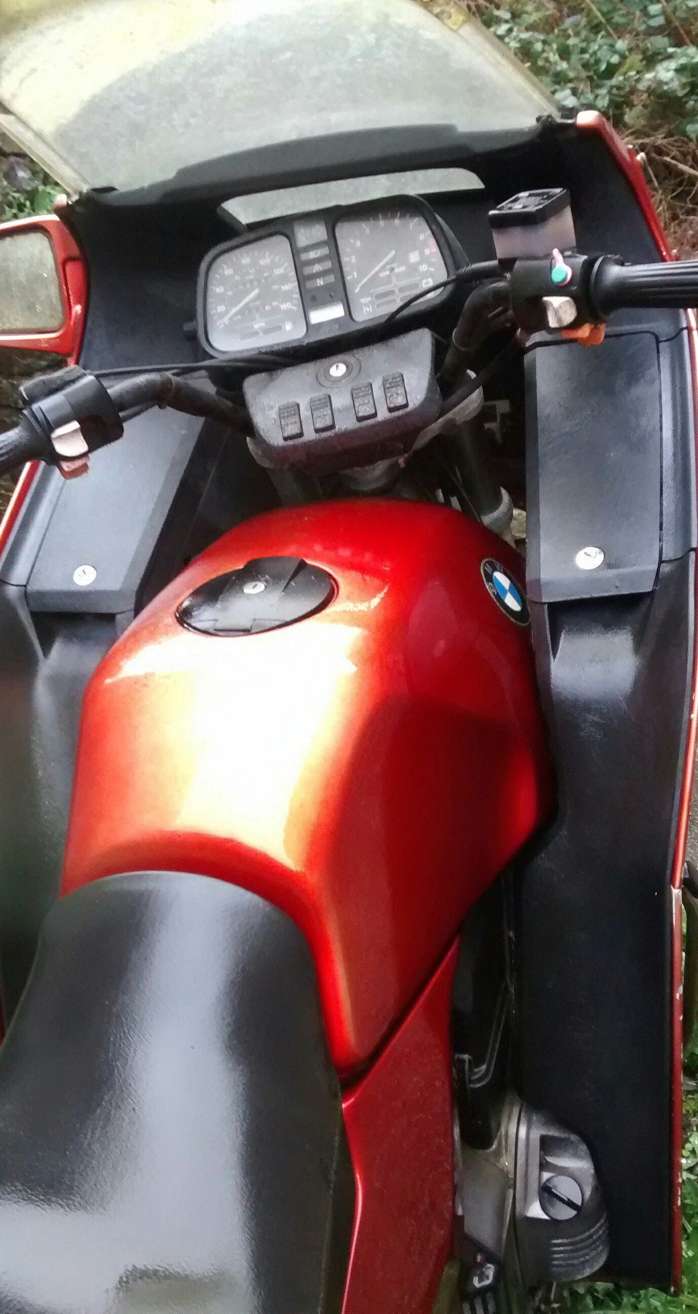

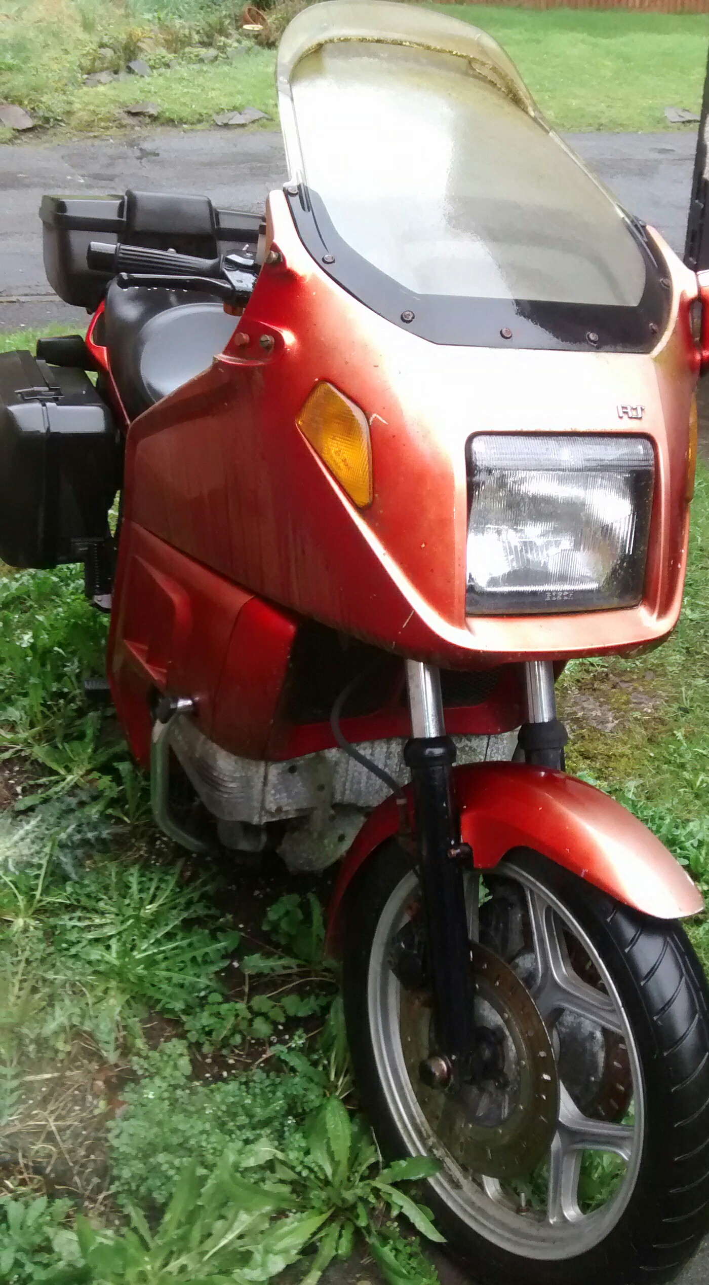

No, no bike thread. I mentioned earlier in this thread that Shedouin work had come a halt to put the bike on the road as a backup. :D Not that I enjoy riding it you understand. :lol:
Its a BMW K100 RT 1986
Not recent images :)
