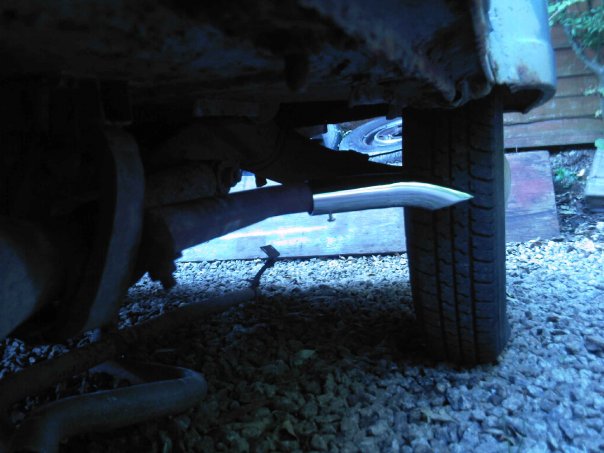

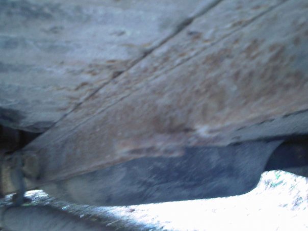

i was thinkin of that.
getting there slowly.
August 5th, 2009, 11:17 pm
Post Re: Celeste Blue D reg / now with pictures
Looking at that first pic, add a sill or two.
Looking at the second, you definitely want to get the shell off for a clean & paint. It's not as big a job as it sounds.

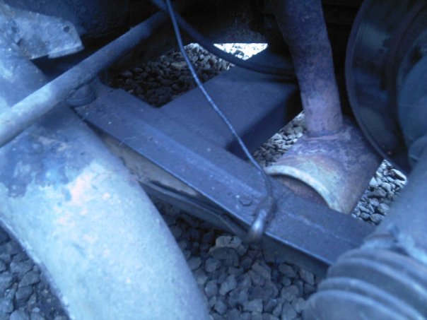

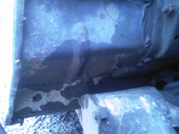

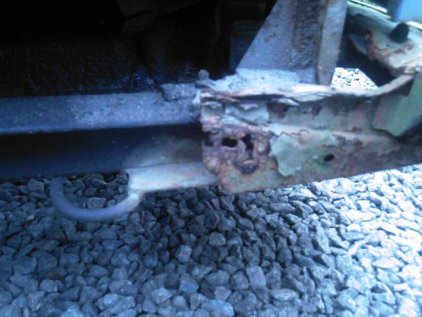

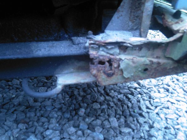

Not the rotten patches but going to jack it up today. I'll add more when i get them
August 6th, 2009, 2:34 pm
That first pic - is that rot with a patch behind the holes? If so, then lower bulkhead/toeboard (but we expected that anyway...) The rest is all fine, except for shagged out bumper mounts. Not the end of the world.
