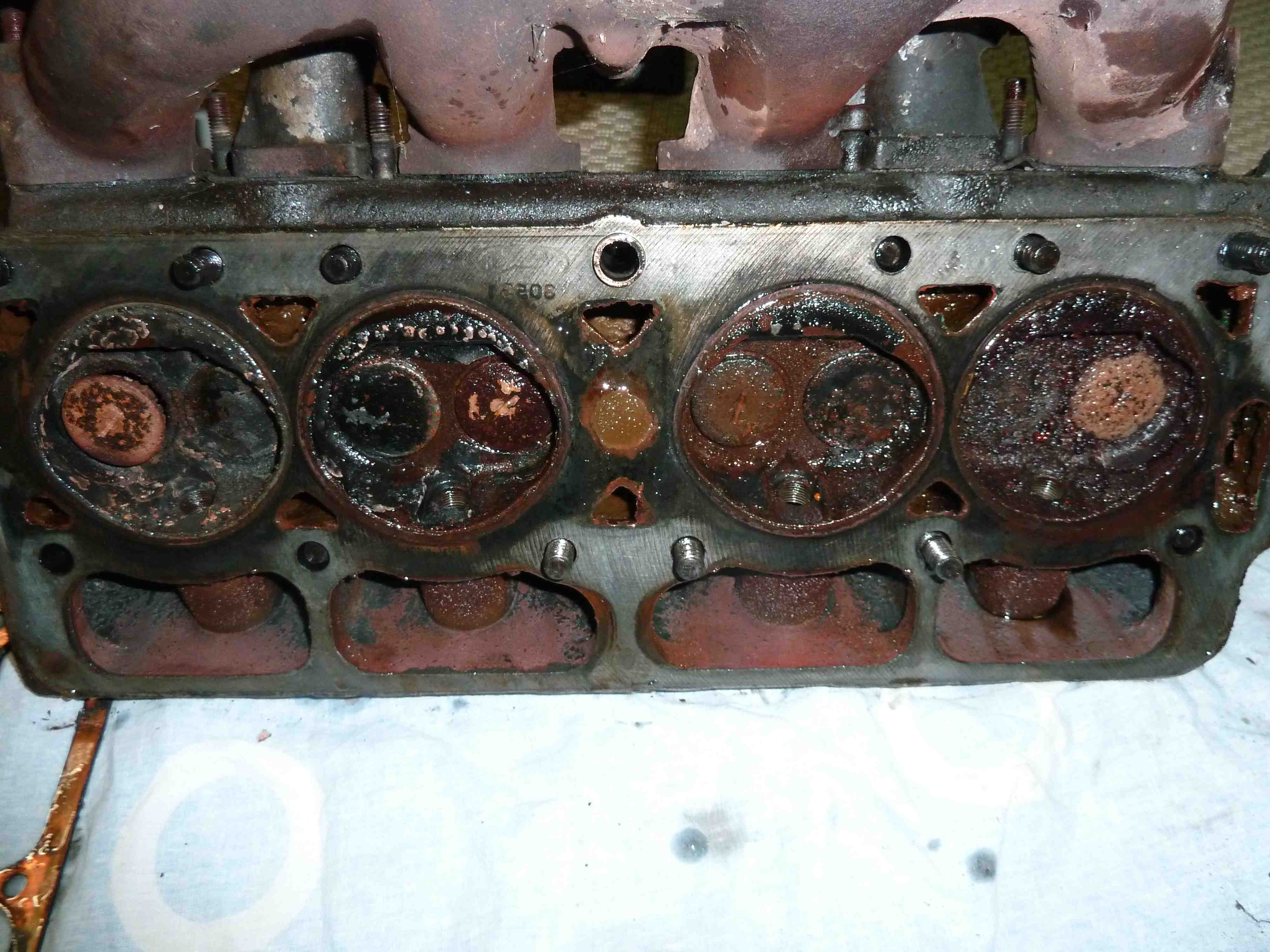

So I took the head off to see what was stopping the engine from turning over. I think I found the problem :lol:

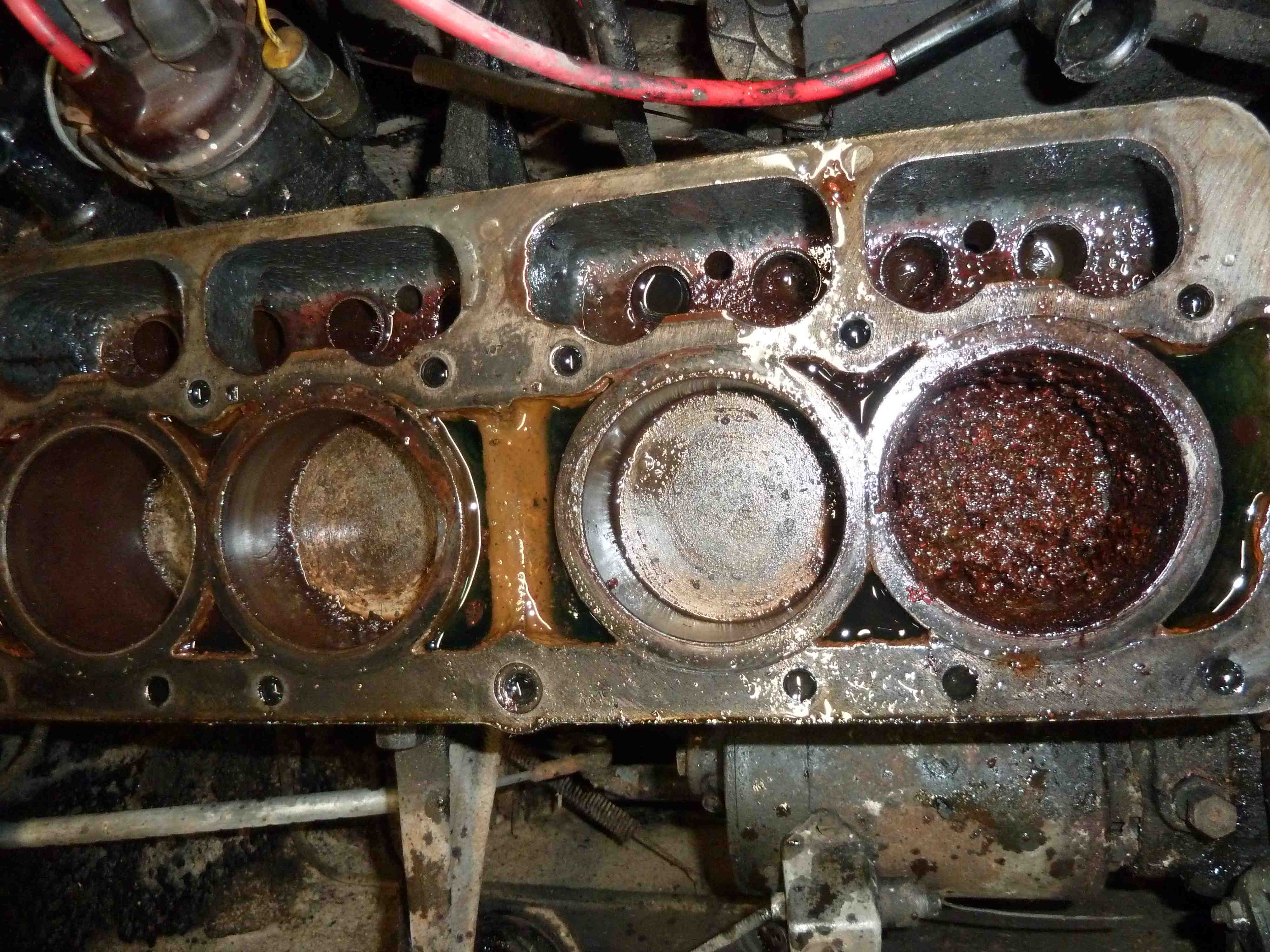

The piston barrels were full of my loosening concoction so after withdrawing it with my giant syringe I wiped them as clean as possible. Piston 4 is chipped and broken a little. Piston 1 is chipped, broken and the barrel is rusted out.

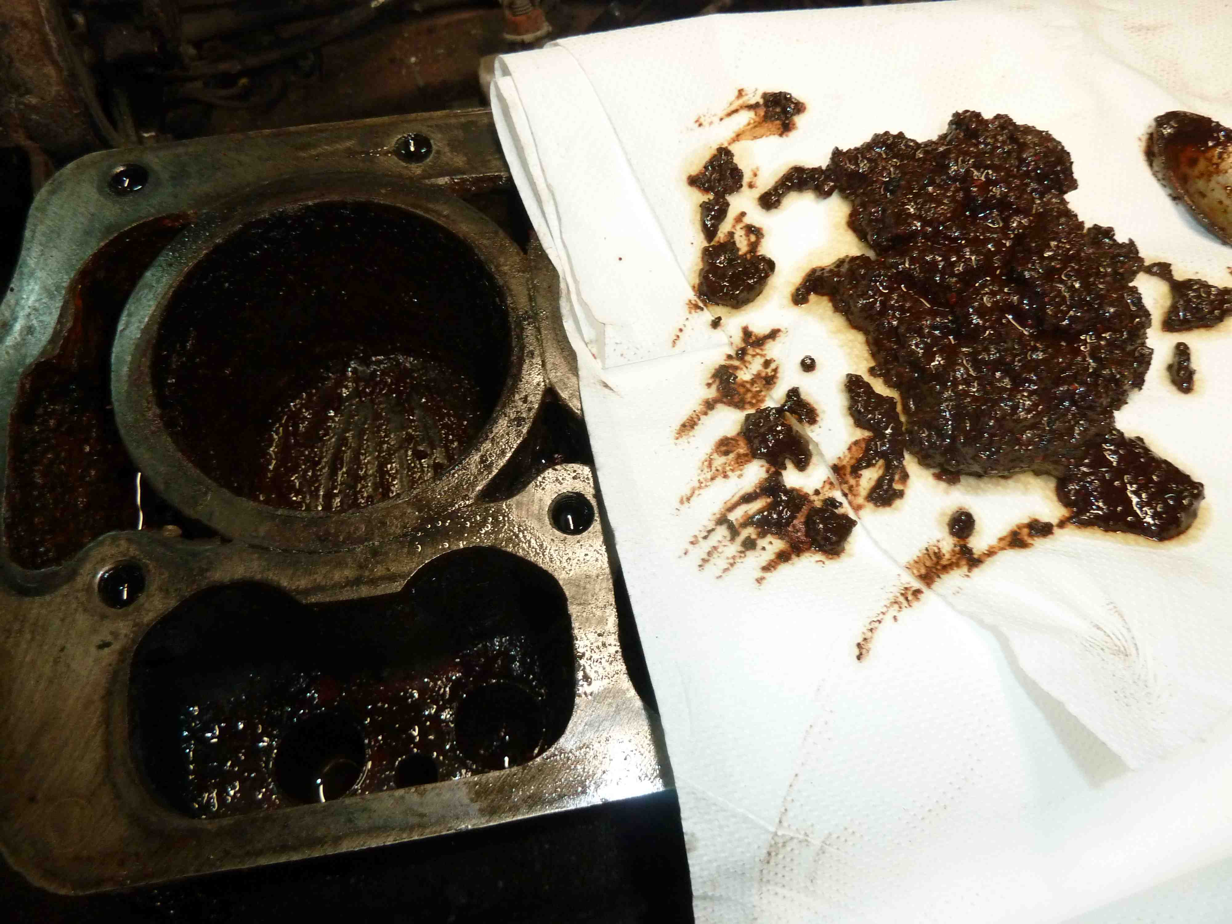

I scooped out all the rust - not good. Looks like I will be having new everything in this engine.
