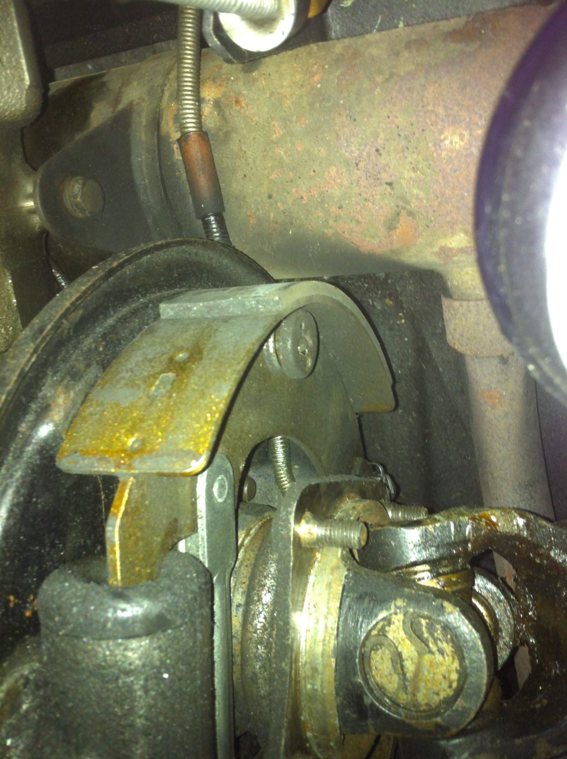

I was looking at the brakes while I have the wings off. I found a part of the surface of the shoe missing but it is exactly the same on both sides of the car. It doesn't look normal but the shoes are identical i.e the missing surface area matches both sides (inside shoe, outside shoe is complete on both sides) - is this OK, normal.
Had a look on the parts sites and theirs look complete (surface wise)

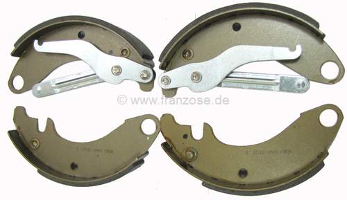

Well these shoes on the Franzose site shoes a very similar set up so I think I am OK :D
So I will clean everything up tomorrow and put it all back together and try and get the adjustment spot on :shock:

I did the breaks of my van , the new shoes where the same as your's are, so I thought there was some material missing, but as I removed the old shoes , I saw they were exactly the same as the new ones.
So your shoes are oke.
