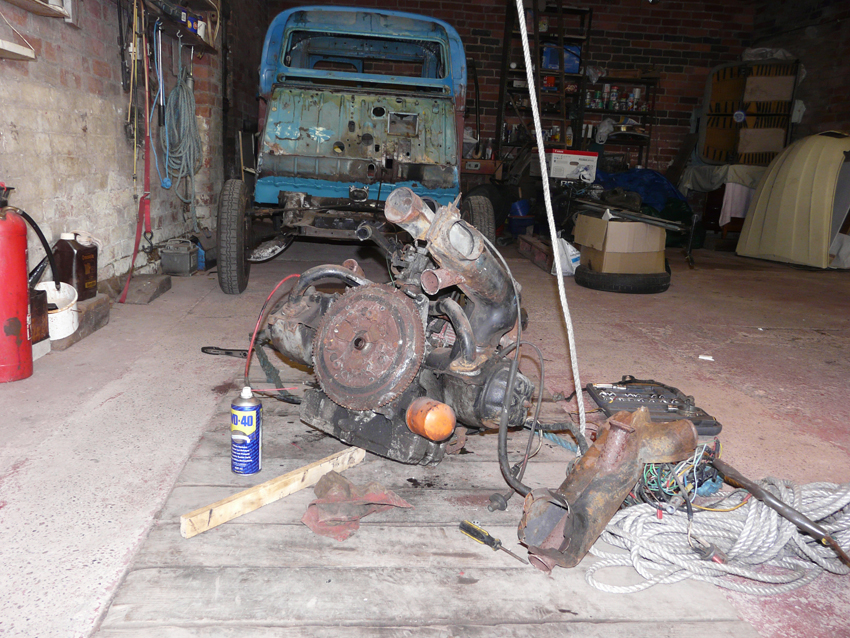

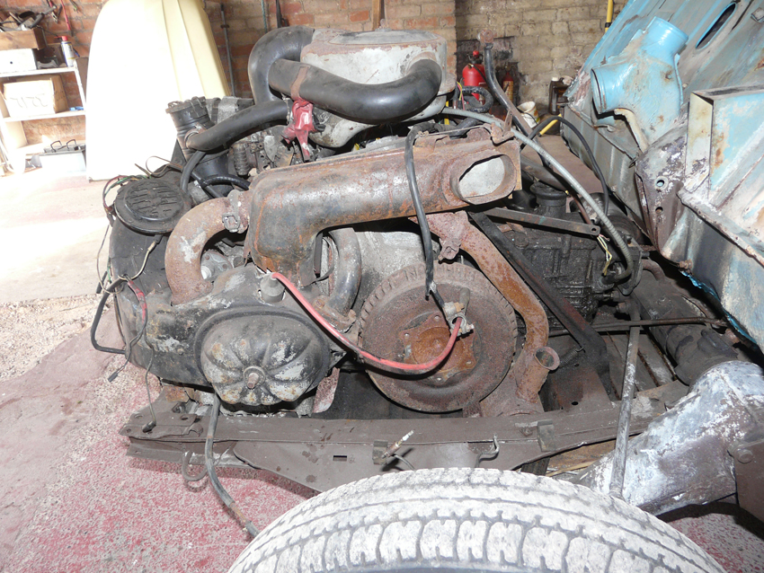

Post Re: 1976 AZU250
Here's some pics I took of the engine when I got it out of the van last week.
And here it is when I separated it from the gearbox.

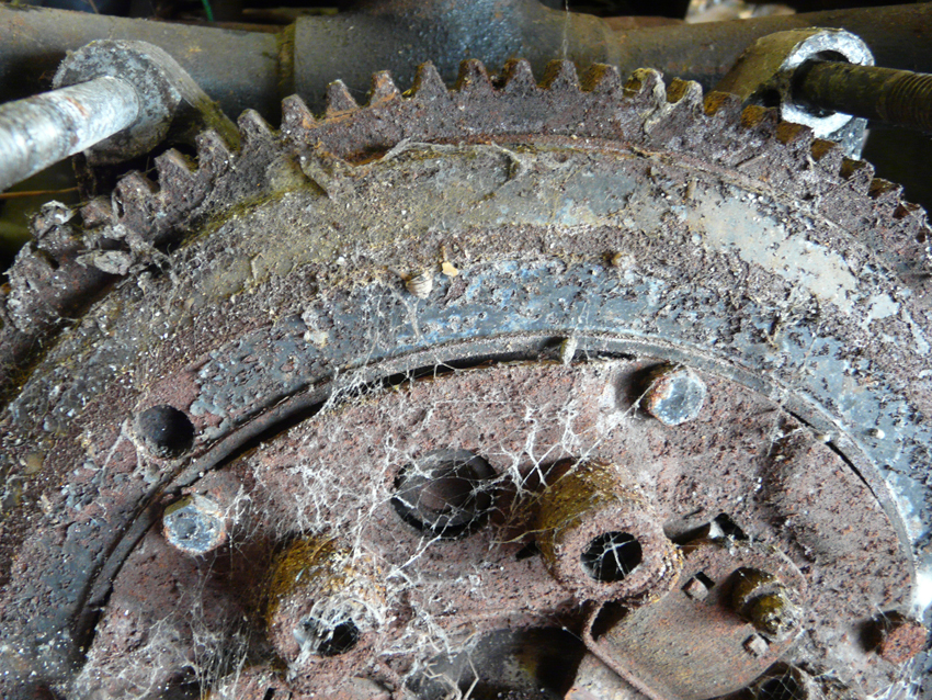

That flywheel's been a spider's playground for quite a while.

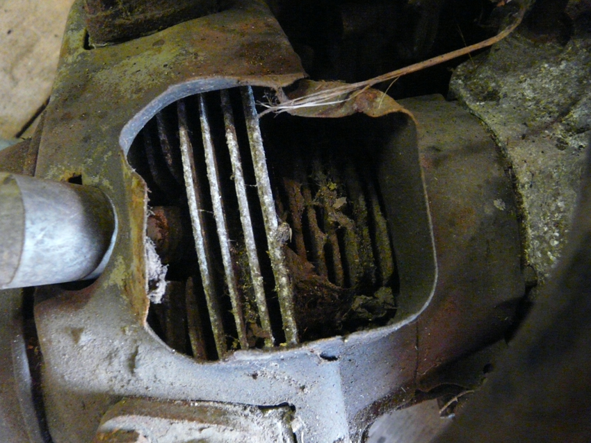

As has the rest of the engine.

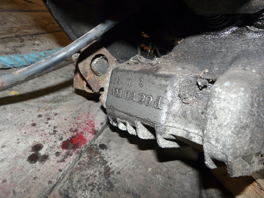

Could't find an id tag on the engine. All I could see was this:

Post Re: 1976 AK250
thats the cast mark with the part No AM#### means it was originally for the AMI
There are date wheels on the front or rear of the sump it will have a number stamped in the middle(year) of a 12 segment wheel each of the 12 segments has a pip for the week so if the mould was being used in the may the 5th segment would have a pip in it
The engine M4 cases? are the heat exchangers parallel or splayed at the back like a D*lly etc? what carb is it
May 2nd, 2012, 8:48 am
Post Re: 1976 AK250
Thanks for the info, Sean. The heat exchangers are parallel. Don't know about the carb - I'll have a look at the weekend.
