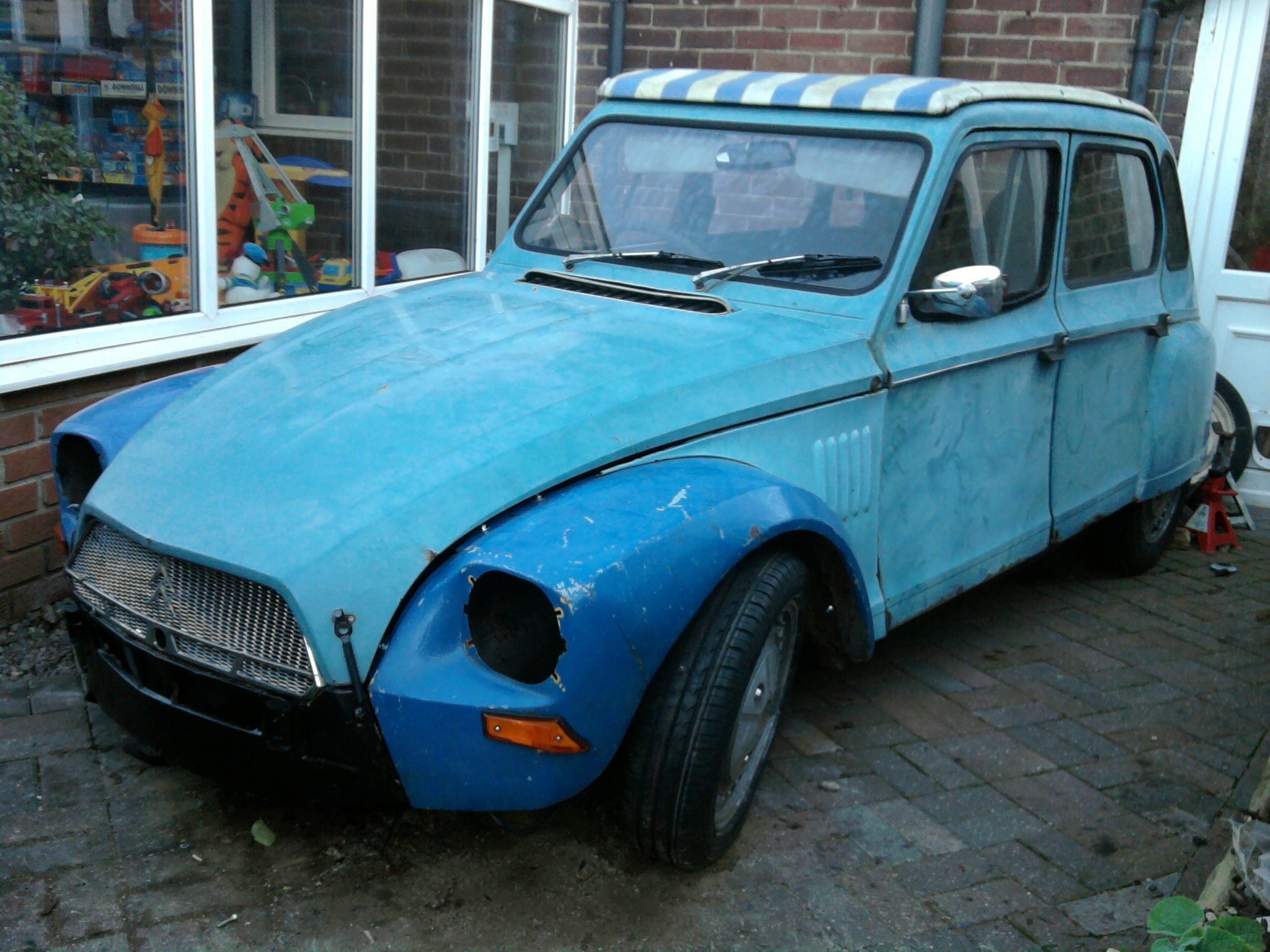

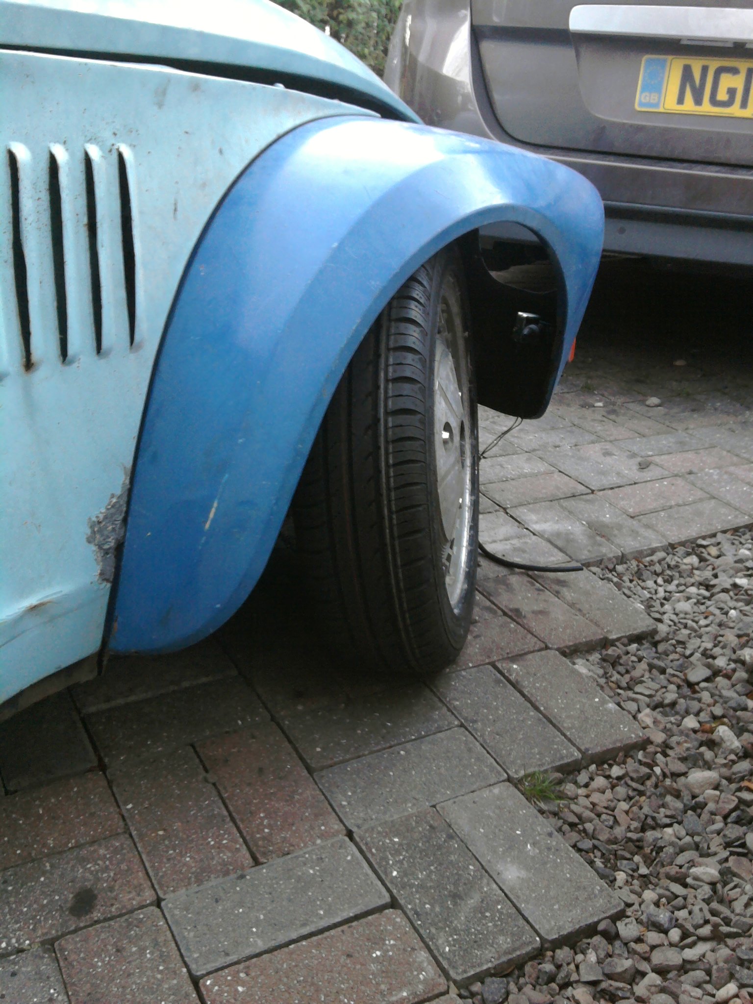

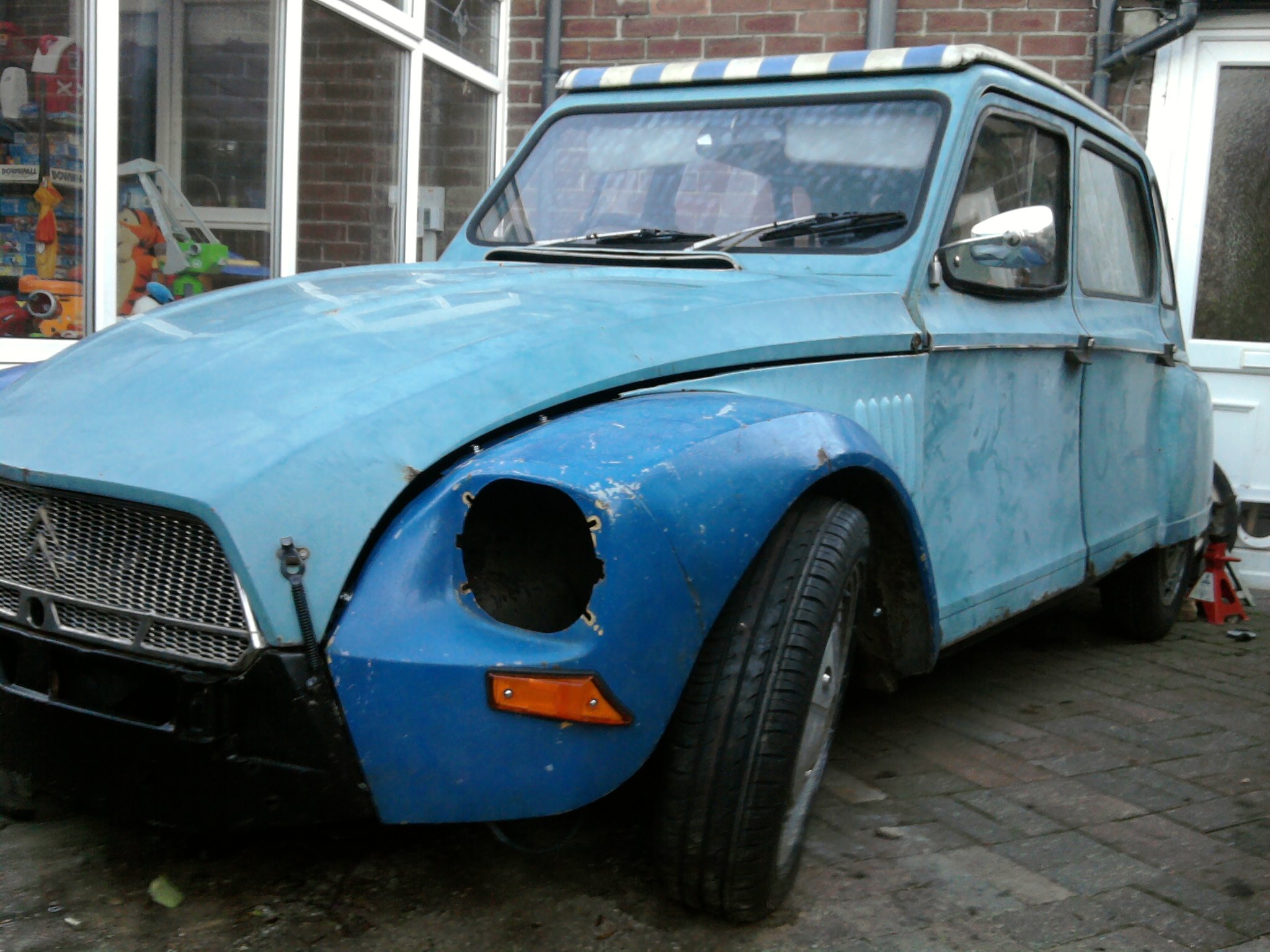

Well the sun came out today up north so....
Although I had got the exhaust in it wasn't bolted in.... Didn't realise it was another 2 hours to do that aswell!! What a bastard of a job, Ya right its a lovely fit just the ticket but the bolt under the geabox what a git!!
All done now and as you can see fromthe pics its almost back together, still haven't sorted the wiring so still to fire the beast up!!!
