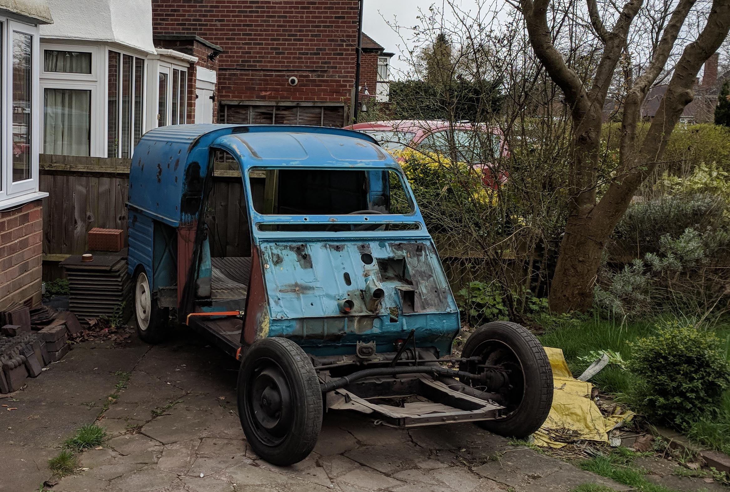

Hello everybody!
I've been away for quite a while, but I'm happy to say that I'm now back... trying to pick up the pieces of a project that had to be put to one side while I attended to urgent matters.
My van has had no attention for 2½ years and is looking a bit sorry for itself. Thankfully it was stored in a dry barn on a farm.
Last week I moved it to my home and re-started my work on the bodyshell.
I'd more or less finished the welding jobs before the enforced lay up. Now it's a case of fixing up the surface rust spots and painting it.

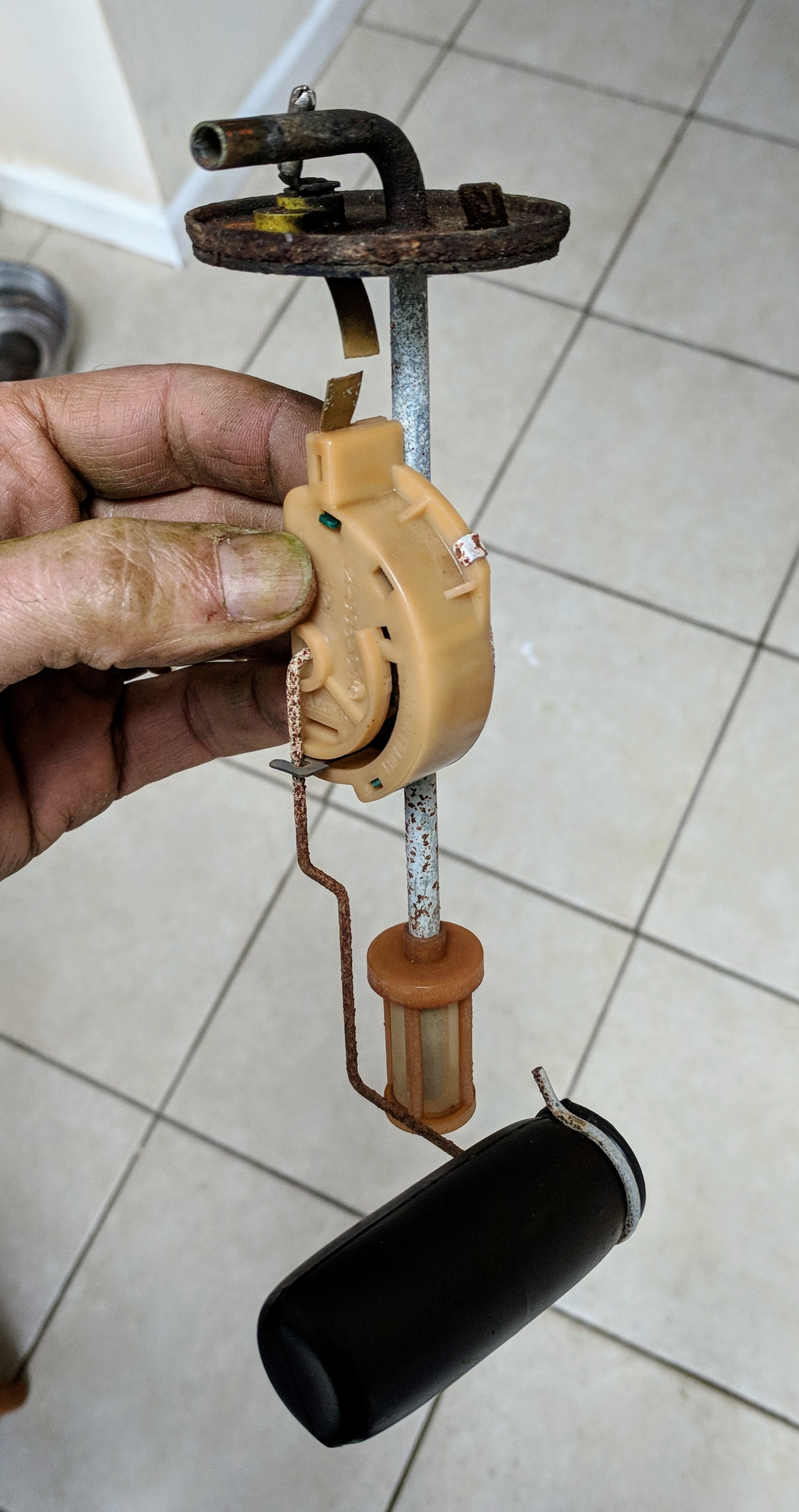

I also removed the tank from my white Special, and took out the fuel gauge thingy.
Can anybody tell me how to repair this?

Welcome back Smiffy. Bin the fuel gauge, a new one from ECAS is cheap enough.
An original Magnetti Marelli
https://www.ecas2cvparts.co.uk/fuel-tan ... 6a3ed9b21f
A copy for half the cost

Just solder a piece of wire between the two brass strips.

Welcome back Smiffy !
As AZL57 says .
That will work perfectly.
Or just bend the pieces more together and solder them together not using a wire. Worked for me. A quick and easy repair.
