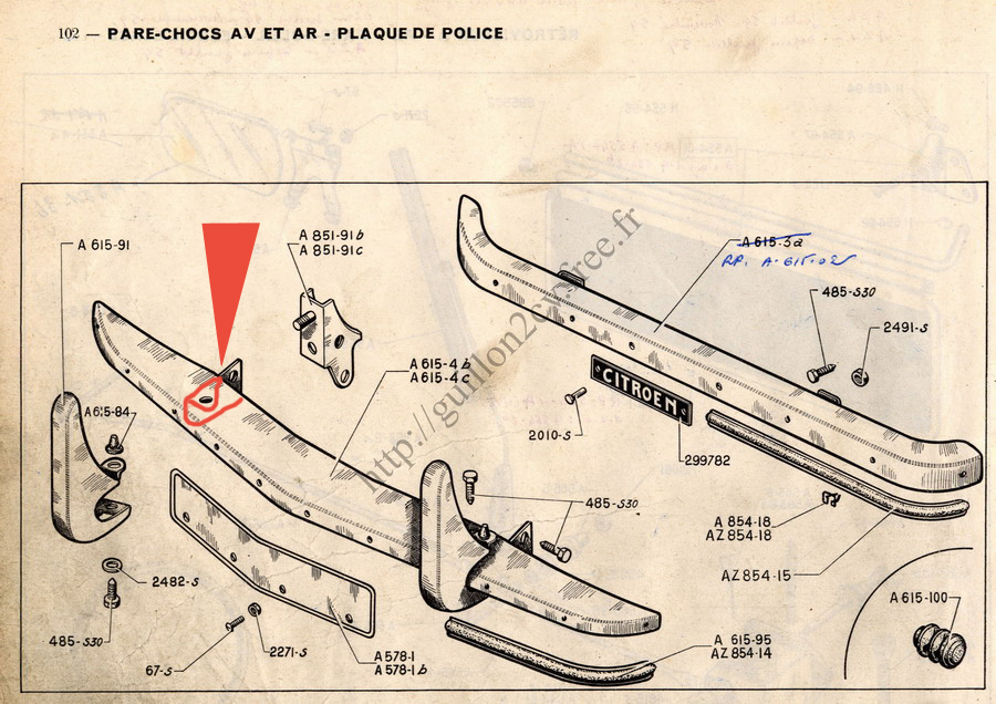

I think you are right it must be a part of the frontbumper fixtures.
It might be one of these or what is left of it...

Yeah, that's the little devil,thanks for tracking it down.It won't be needed now though, 'cos of this.
