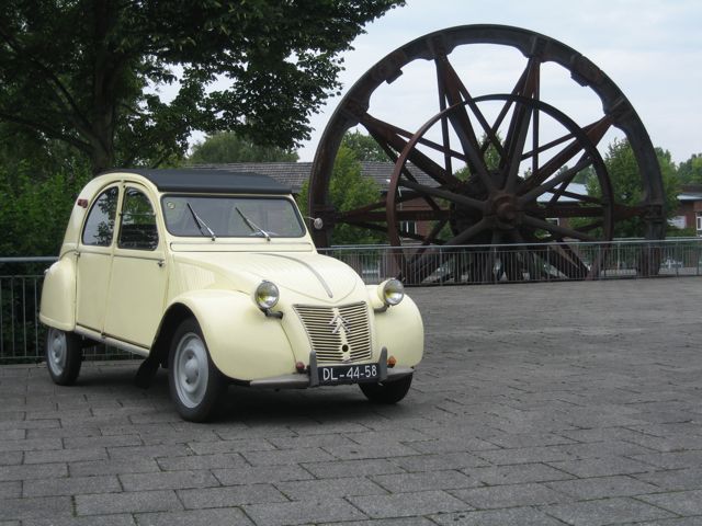

Ran into this picture of my car on the french Peugeot 505 site????

That's nice :)
What is the big wheel in the background?

It's a part from a huge compressor from a zinc factory if i am correct. It is at the Zinkhutterhof Museum in Stolberg (D).
