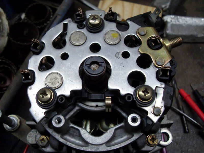

The blockdiodes/rectifier diodes/bridge are all the same thing, yes? The three round things pressed into the top plate, and more underneath? They don't look easy to change, they're all crimped connections. But these were changed with the alternator, it's unlikely that they had the same fault in both alternators.

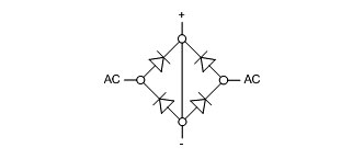

There must be 4 of them, but I think they are in the regulater thing not in the alternator...
circuit like this
this makes from the dc (current) (alternator) ===> (ac current) (battery)

Thanks Lpgo, I know the basic bridge rectifier, but if those discs are the diodes, and I'm sure they are http://www.ebay.co.uk/itm/BOSCH-ALTERNA ... 483e7cf901, then there are at least 6 of them, I think this is because there is more than 1 winding giving output, sort of like 3-phase or something.
There are also I think the same number of smaller diodes hidden under the plate, they stop the power from the warning lamp flowing into the coils.

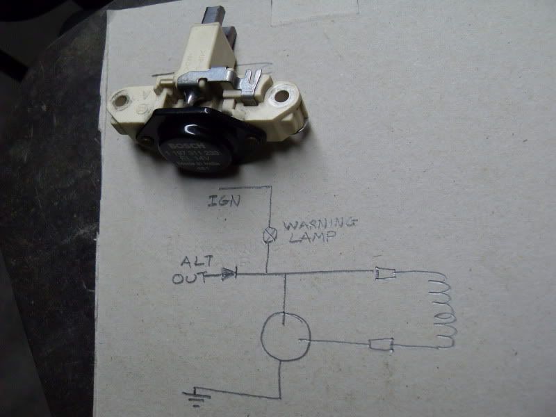

I've looked at the regulator and brushes to see if I could understand how it works, this alternator is the type which works with only one wire, it does not need external power for the field windings. The small spade connector is from the warning light. It did occur to me that I've recently changed the warning light for an LED and I wondered if perhaps it relied on a certain level of current flowing from the light that it isn't now getting. I tried disconnecting the wire on that spade, no difference.
I think this is how it is connected up, it's hard to tell exactly what's going on under the plate with the diodes in.
The large circle is the round black regulator object. I was wondering if it would work if I removed this and connected the brushes up to the 2cv's remote regulator. At the moment I can't see why not.

Very good Ken, but the extremely precise choice of search words makes me think you knew that already. I'm quite pleased that it confirms my sketch.
It does seem to be a common consensus that an LED needs to have a resistor fitted in parrallel in order to work, but there are still a couple of unanswered questions for me. Firstly once up and running it should be self-exciting, and surely as it gets up to 14v with no load on it then it's managing to get started. Once in operating mode, (the first of the 2 pics in your link), the lamp plays no part.
I've also just remembered that since fitting the LED it takes longer for the light to go out after the engine is started, so that does actually back up the infomation about the lamp's role. But importantly the light does then go off.
Secondly why is it only failing to work when it's got a load on it, and then it's only dropping half a volt, not cutting out completely.
Another very small but 'interesting feature' is that the warning light glows very slightly all the time when the engine is running, it's so faint that it can only be seen at night, but there must still be a very small voltage difference across it. Will an LED emit any light when the voltage is reversed, as the route to it's positive side is more convoluted and more likely to have some resistance which is dropping voltage.
And I still wonder if I could bin the 'round black thing' aka Laderegler(charge controller/regulator) and connect the DF wire to the output from the standard 2cv regulator, which should give me the 14.4volts I'd like. The warning light could be left as it is without a parallel resistor, and should still function.
Whatever, next thing to do is either try putting a resistor in parallel, or swapping back to conventional bulb, depending on what I can find, and see if that fixes the issue.
