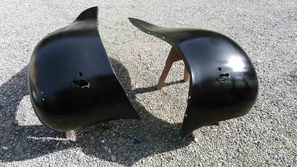

So the sun is out in the Pyrenees and so is the spray can. I am not doing the bodywork just yet on the car, this will wait until next year but I did have all 4 wings sorted as they were terrible. So I am just putting on a single top coat of Black Gloss to protect the undercoat and also to tie it into the rest of the car.

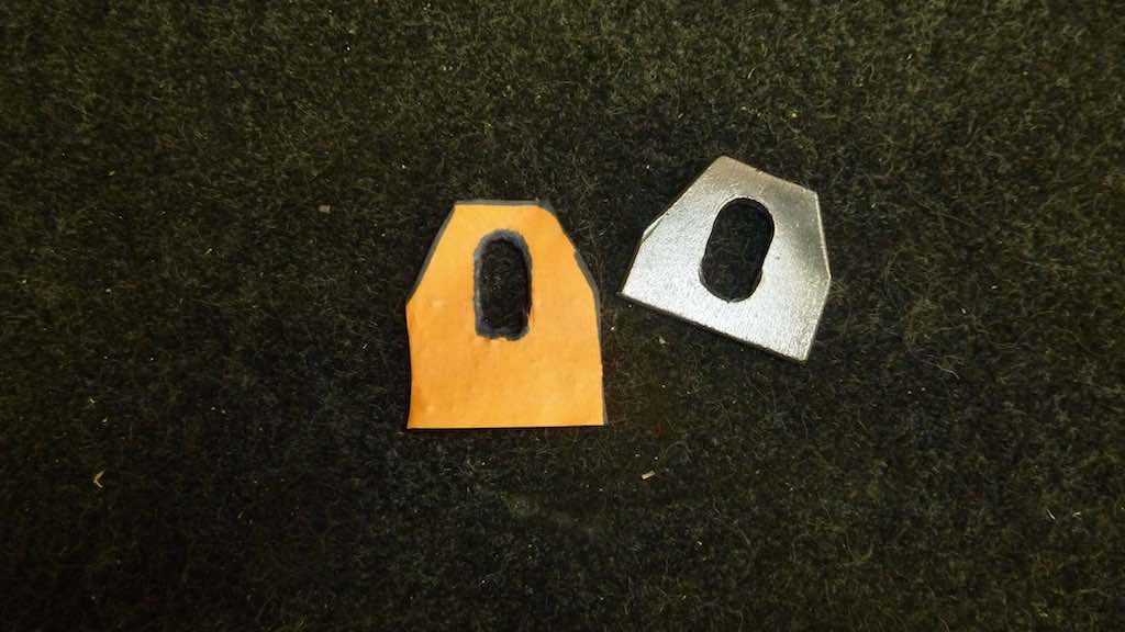

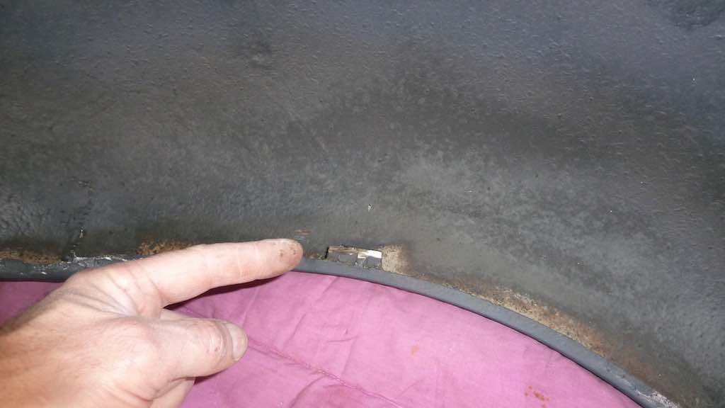

I did have to repair the fixing bracket that fixes to the support bar. One had snapped off when I got the car :(

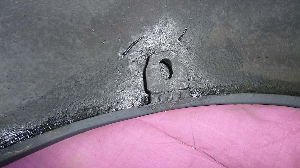

So a quick template and I cut out a new piece
And then welded it on in place, painted it with chip seal like the rest of the underside of the wing and voila!! :D

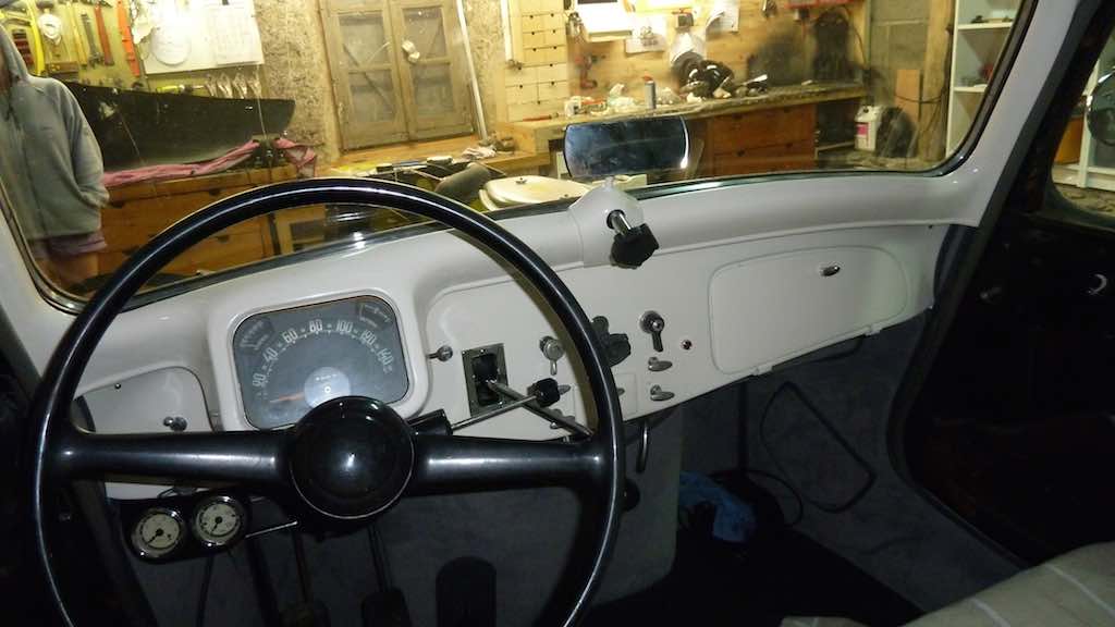

I repositioned the power steering motor (as it was hitting the gear change rods - one thing here, I did not get a lot of help from EZ Power Steering, which I am a little unhappy about) I had to fabricate a new securing bracket and refit - very fiddly now all the carpets are in.
First time the dashboard has been complete with steering wheel.

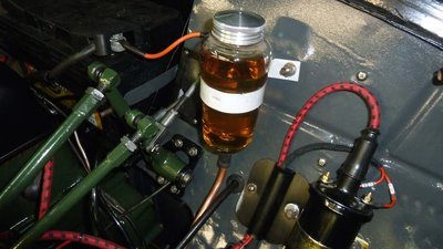

Then onto filling and bleeding - all went OK with a few leaks but it made me go through the whole system tightening and checking. Brakes were sold and worked great (no road test yet though ;) ) Filled up the glass jar which is the first time it has had fluid in it.
But just as I was about to finish and turn the lights off, I noticed the level had dropped by 1 cm. Checked under the car and there was a puddle under the master cylinder. Whipped off the panel and could see the fluid leaking from the push rod of the master cylinder. If you remember I was worried about the refit kit I was given and the type of seal. It did not match exactly the original but with a lot of these replacement items that is quite common. So I have ordered a complete Master Cylinder to make sure it will be fine.

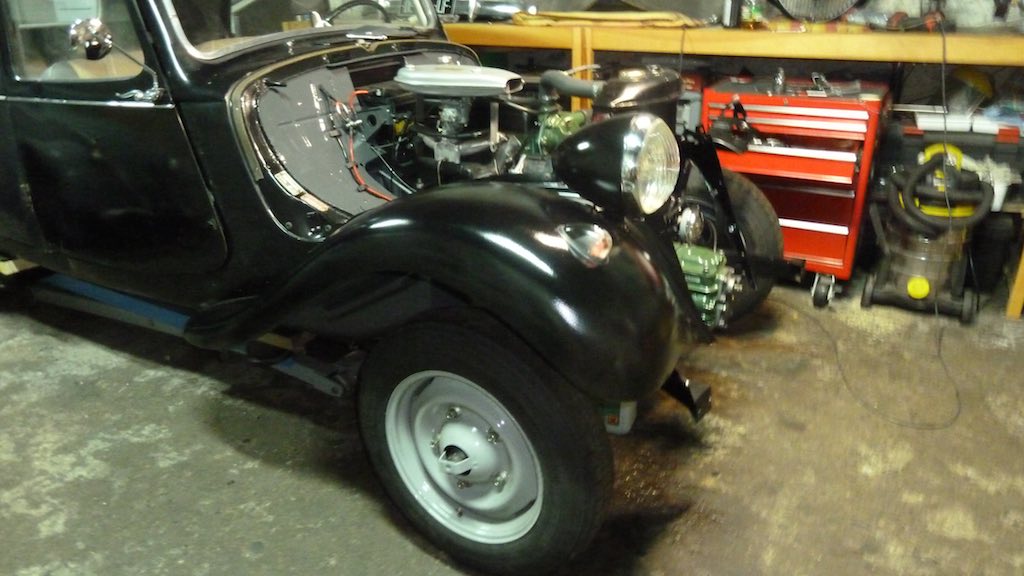

I then started with the wings - the right wing is now secure and went on relatively easy. Fits very well seeing as it was a pile of rust and dented metal when I took it off. I also fitted the indicator and headlight unit - I just love those headlights :D

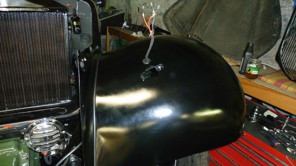

So on with the jobs I can do - on with the other wing

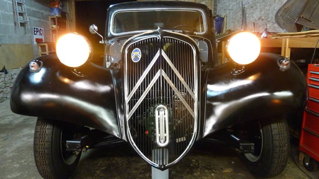

All the lights connected and tested, although they will need aligning when the car finally is on the ground.
