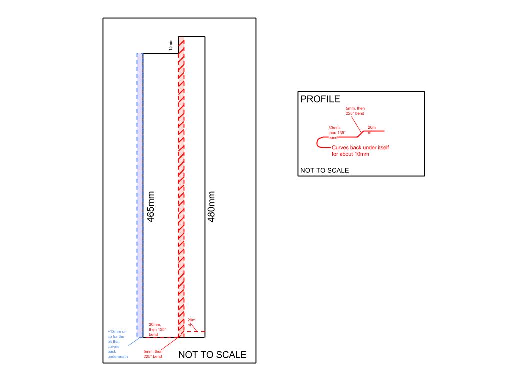

Calling all metal gurus!
Does anyone on here have the metal bending skills/equipment to fabricate one or two of these (one for each side of the vehicle) for me?
This image of the severely bashed original shows that each single piece needs to be bent in two places, along its entire length.
If there isn't anyone on here who can help, does anyone know anyone who could help?

Can you send me a fairly accurate drawing of it? Mainly the profile and the length. Should be no issues to make.
April 6th, 2015, 8:50 pm
Post Re: 1976 AZU250
This is the plan and photos for the nearside, ie left-hand side of the car.
Click to enlarge the first image. Hope it's clear and detailed enough.

(note: very deformed! Originally nice and precise and machined.)
Underside
Please let me know if you need any further info, photos etc.
