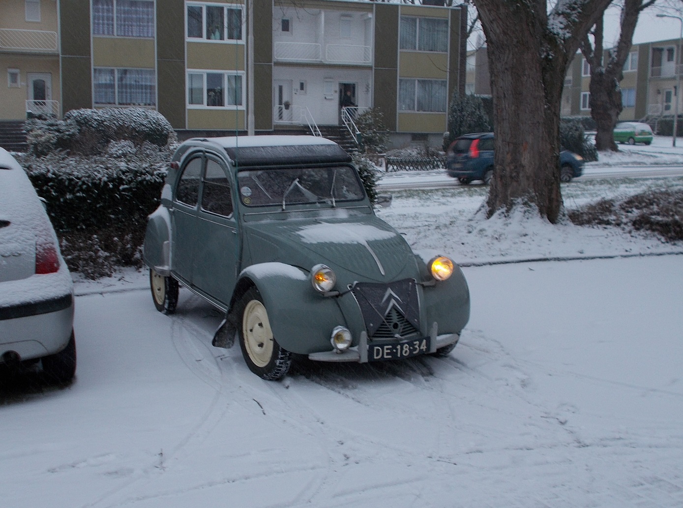

Un intended winter duty

Brrrr ... Making me feel cold just looking at the snow. Can makes me feel warm and fuzzy though. :D

Lovely picture !

Happy the chassis and body of this one are zinc covered.
