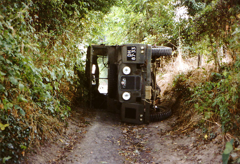

To help you a bit my Minerva Licence Landrover...

I'm not suprised it fell over, they're only rated for 30 degree side slopes :lol:

Ahh! I see your problem ...
You don't need to do that. You could of just drilled some holes in the floor to let the rain water out!

Thanks for the info, never know that works too... ;-)
It would also have helped to put the handbrake on...
