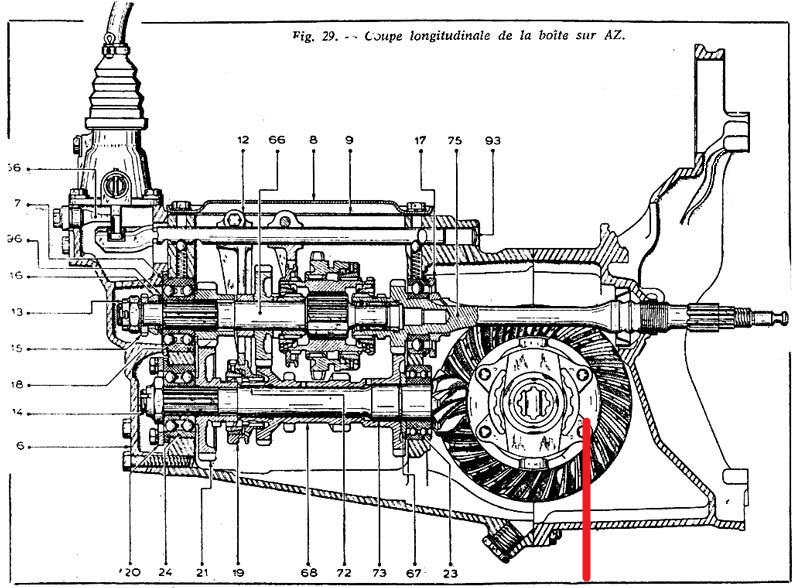

This morning the gearbox of my ivory 2cv exploded uphill on the road to my work. Geo just helped me towing it away. THANKS AGAIN. Photos will follow soon.... It cracked about the place of the red line.

Limburg Service is Great. I suspect something got stuck between the theeth of the differential and pushed that forward what broke the front gearbox cover. If i am lucky i just have to replace that front cover.
So here are some pics I took blindly with my phone, just holding it underneath the gearbox praying we could see something wrong..... and at last we did…
I think I dont need to point the cracks out with arrows etc.. :cry: :| :roll: :?
