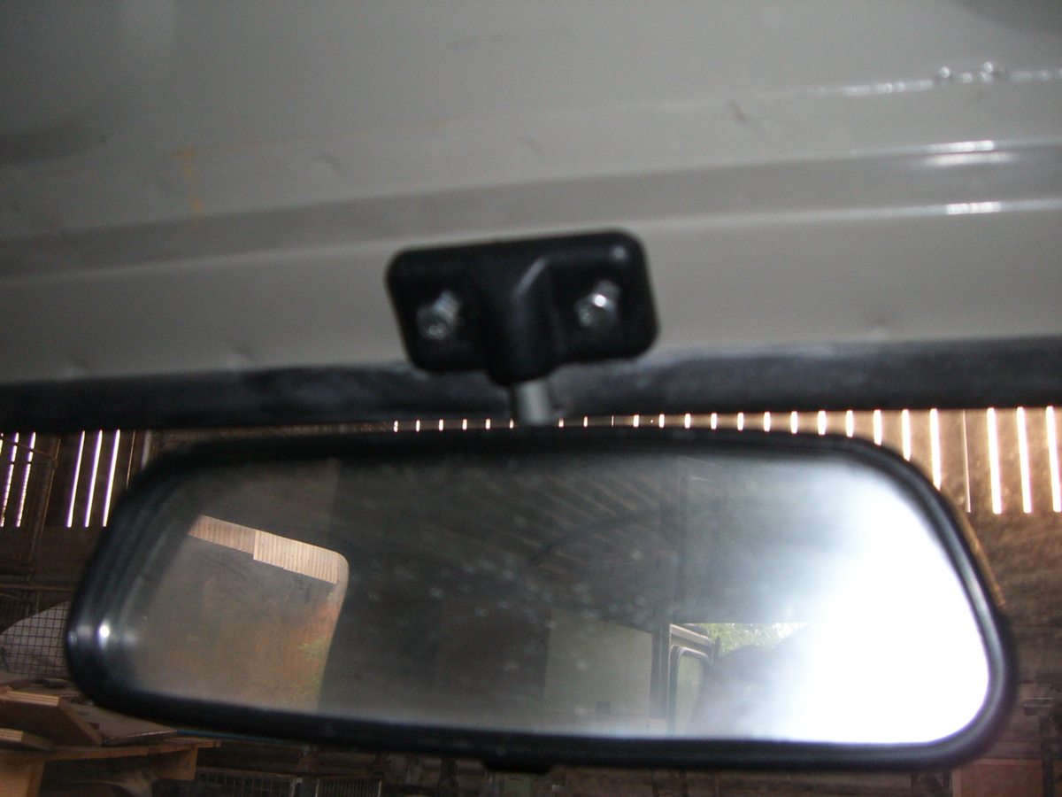

spanners wrote:
I may be wrong but, from my experience, you won't be swapping your old mirror for a "dipping" one as the mountings are differently spaced in older cars and vans......... :ugeek:
Weirdly it fitted fine - I suspect the van might have a later windscreen surround?
Almost certainly, given how heavy the body resto was, back in the early '90s.

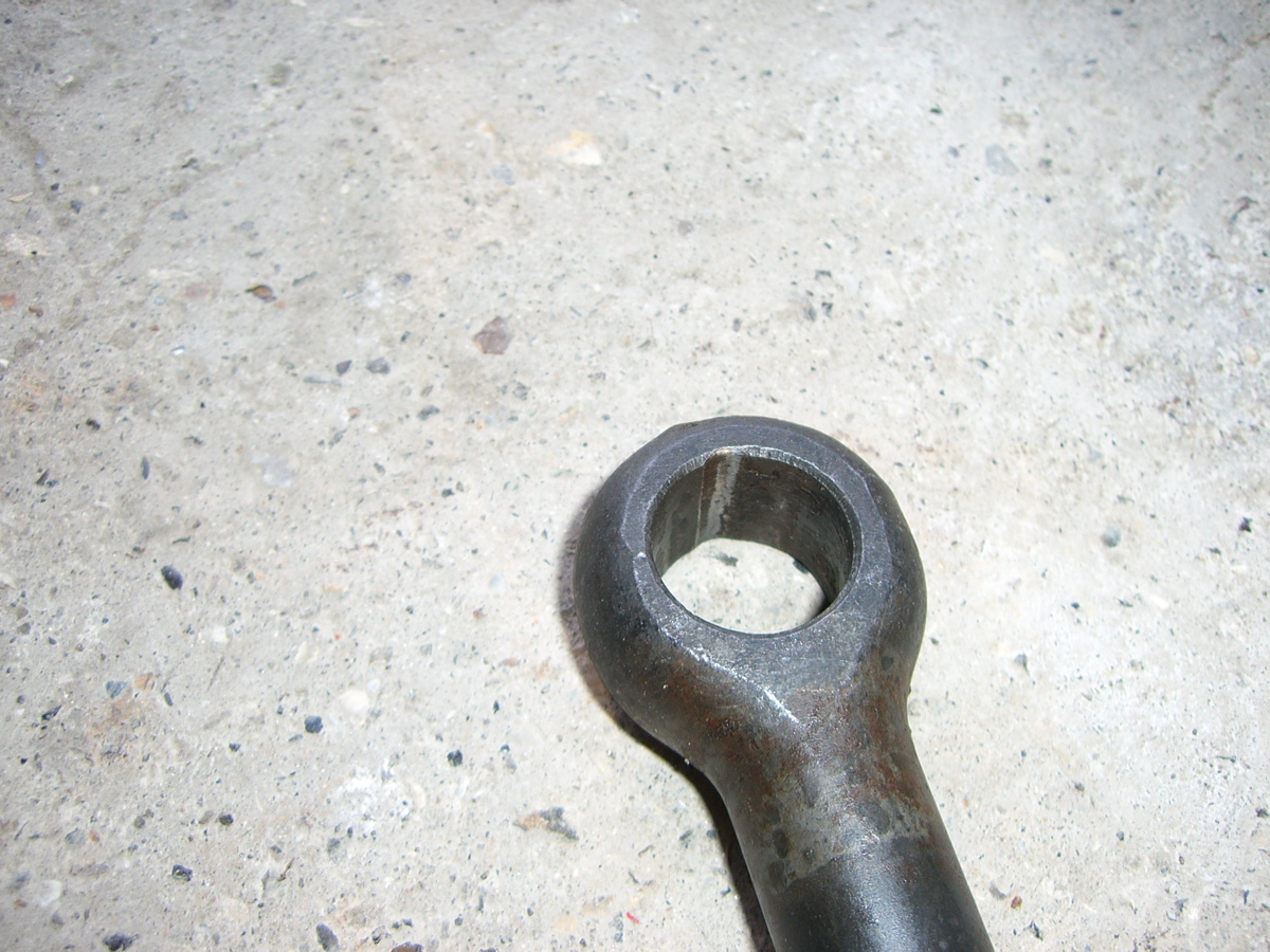

I serviced the front tie rods this afternoon. They weren't tight at all. Weirdly the right hand side needed a lot of adjustment to get it level with the left. I've lowered the front a little but it needs further adjustment.
Nothing seemed too worn which was good.
