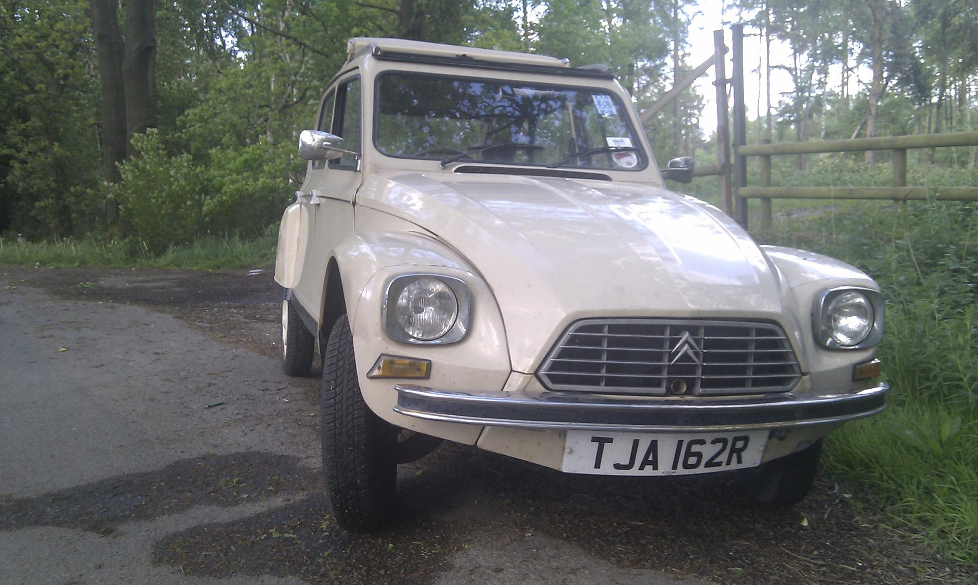

Starting to do more work to tart the BB up - resplendent with freshly painted wheels using Halfrauds Ford Ivory.......whilst nobody unfortunately seems to have the correct Citroen Beige, Rover Sandlewood Beige is a very close match.

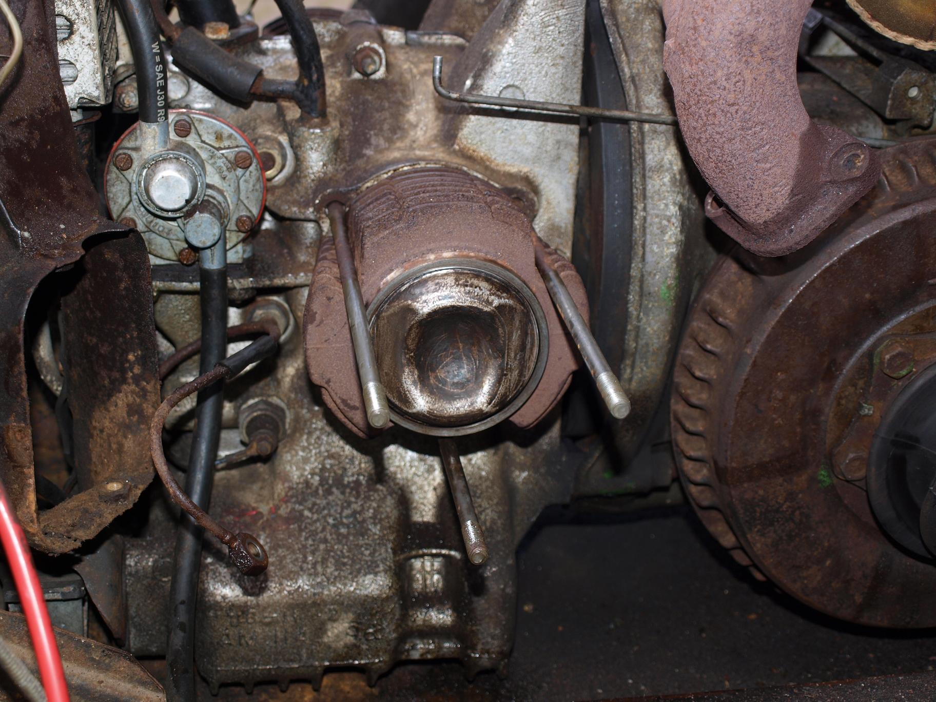

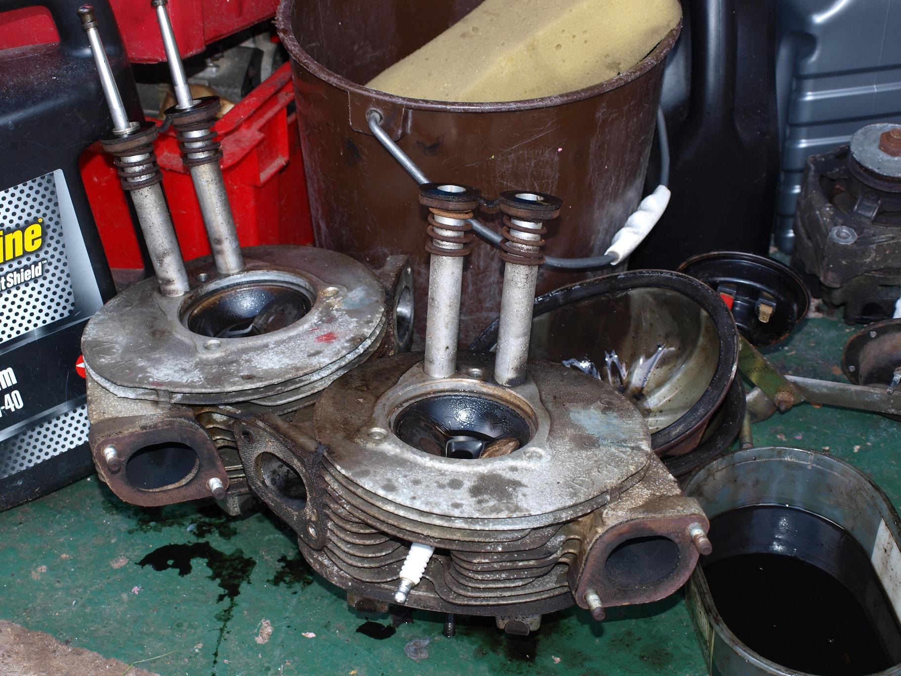

Some pics of putting new rings in BB to stop it burning oil - old ones looked OK but the tops of the pistons were very rough with carbon - took 3 hours to get from complete to new rings on and barrels back on before bad light stopped play...
