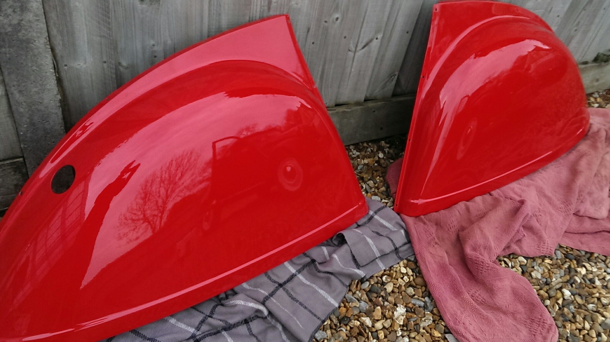

Picked up these and put them on. Had to have one on my flat last night so I could enjoy looking at them. So purdy...
I got them in primer as a present last Xmas. Sealed the back sides with two good coats of two pack epoxy mastic. Then some thick coats of 3M textured stone chip. Then painted red at a local place.
Hoping not to have random holes appearing any time soon...
Next at some point will be front wings.
