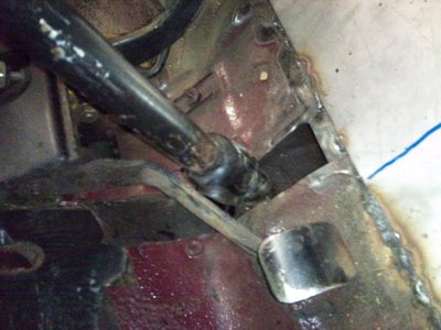

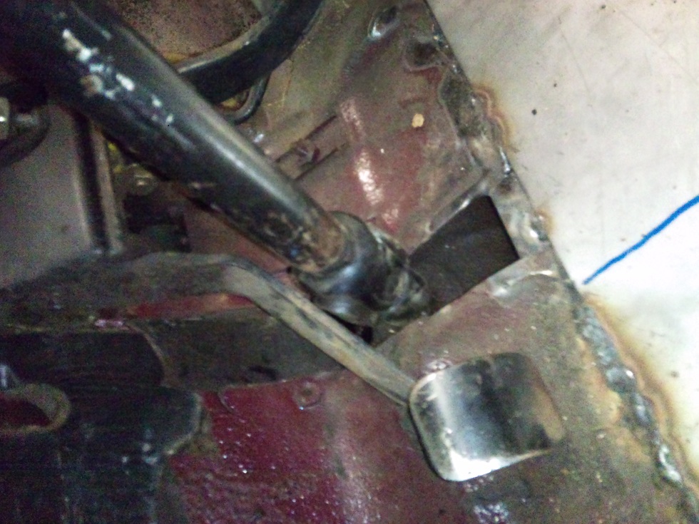

so today , pretty good really, but really difficult to work after about 2 Oclock, the sun just burns straight into the garage.
anyway chassis welded and painted on the inside, still needing a compression plate on the top side
slung the spare wheel under the chassis to gain the lost space in the boot
cut out parts for the boot floor and half of the cockpit floor. it´l´l be done in 2 halves as the channeling is raked from a lot at the back to less at the front, not sure the dimensions yet but my feet are definatlely not gonna fit on those pedals!..all good fun, tomorrow I want to spot weld the panels and get a better idea of where I´m going with this!
heres the pix
