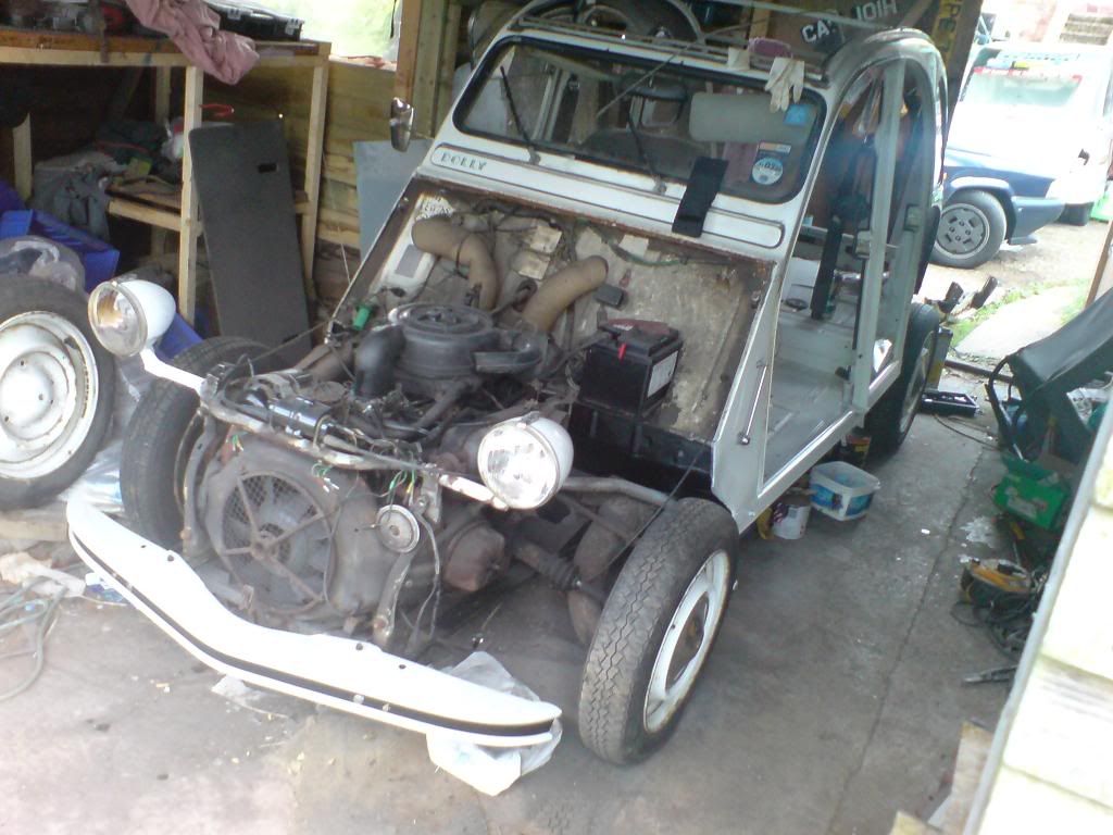

Okay, so this car's been a bit (?) of a pain in the old 'arris and today proved no different!
I decided it was time to turn the car around and finish the passenger side off. So, started it up and realised how badly it was running-bear in mind that it's been plagued with fuel laeks since it's been here. Anyway, checked all the usual suspects, points, new plugs, leads, coil and so on-no better. removed rocker covers and checked valve clearances.
I found the tappets were tighter than me! Adjusted valve clearances and retried it, better but still back-firng/missfiring :(
So, question to the really experienced folk out there, anybody else ever come accross such badly adjusted tappets that the valves have kissed the pistons?
With a replacement head fitted on the N/S, she started and ran like a dream, so that's a plus I guess!
Anyway, onto todays photos.......

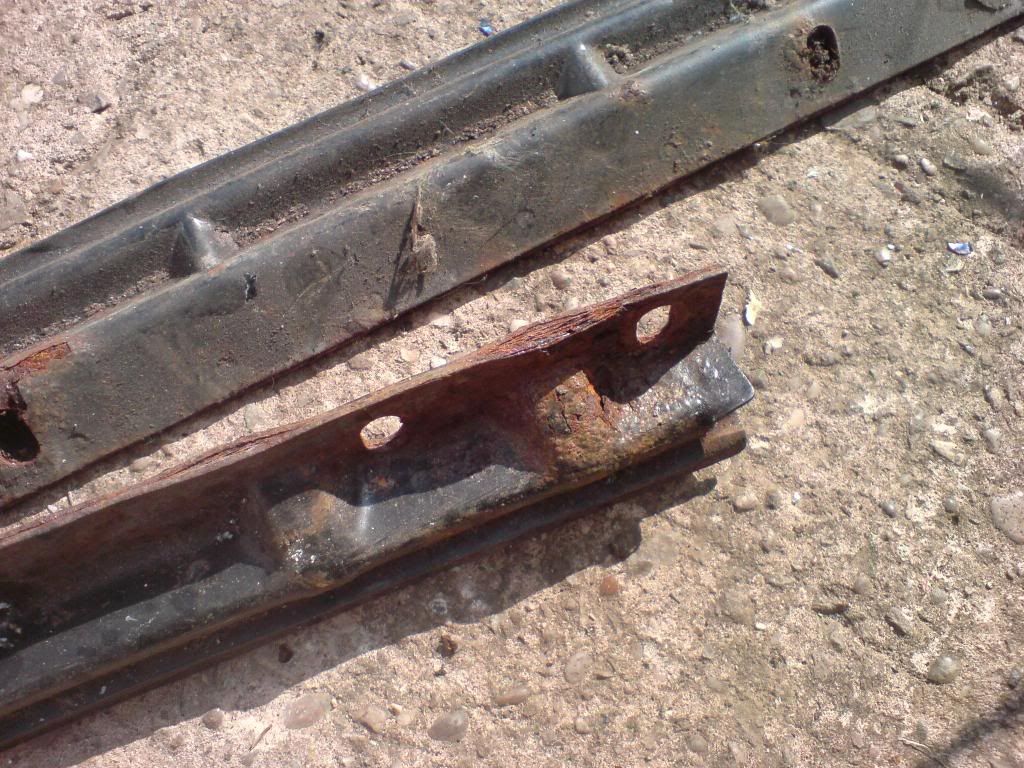

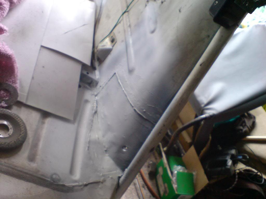

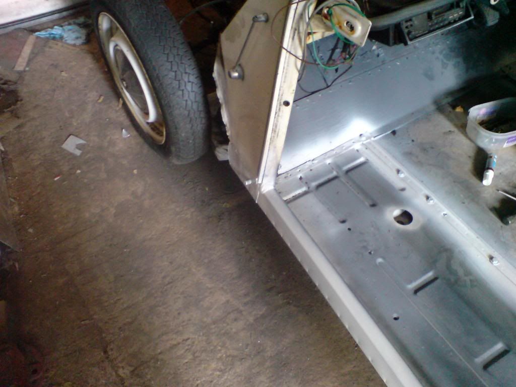

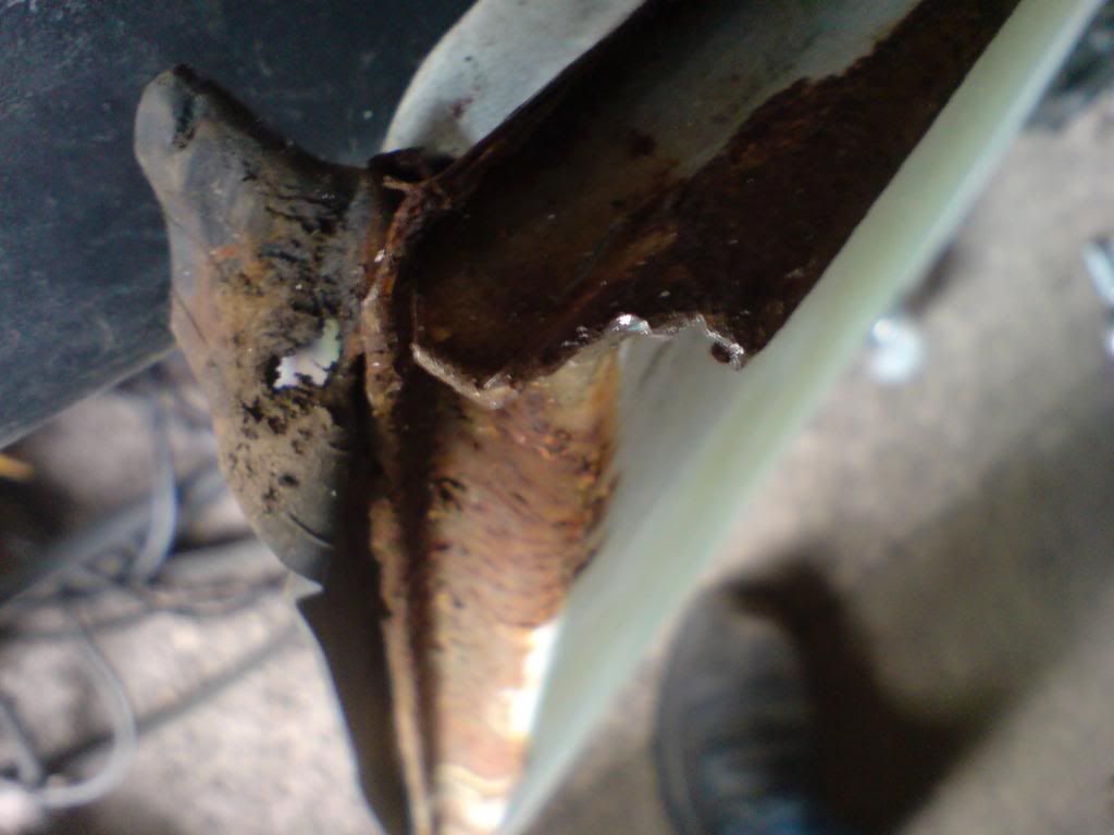

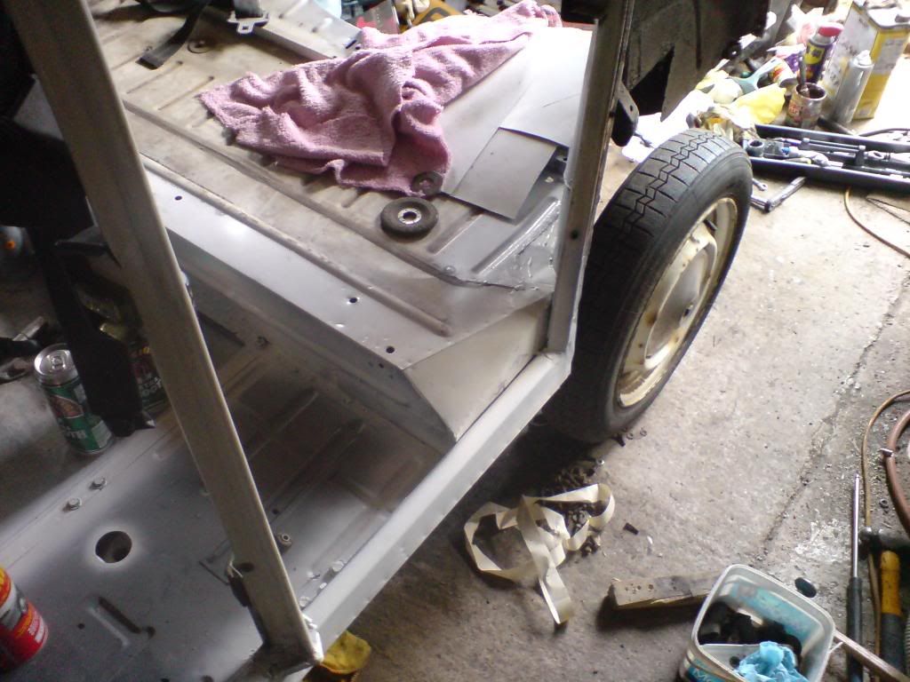

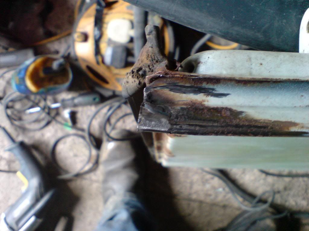

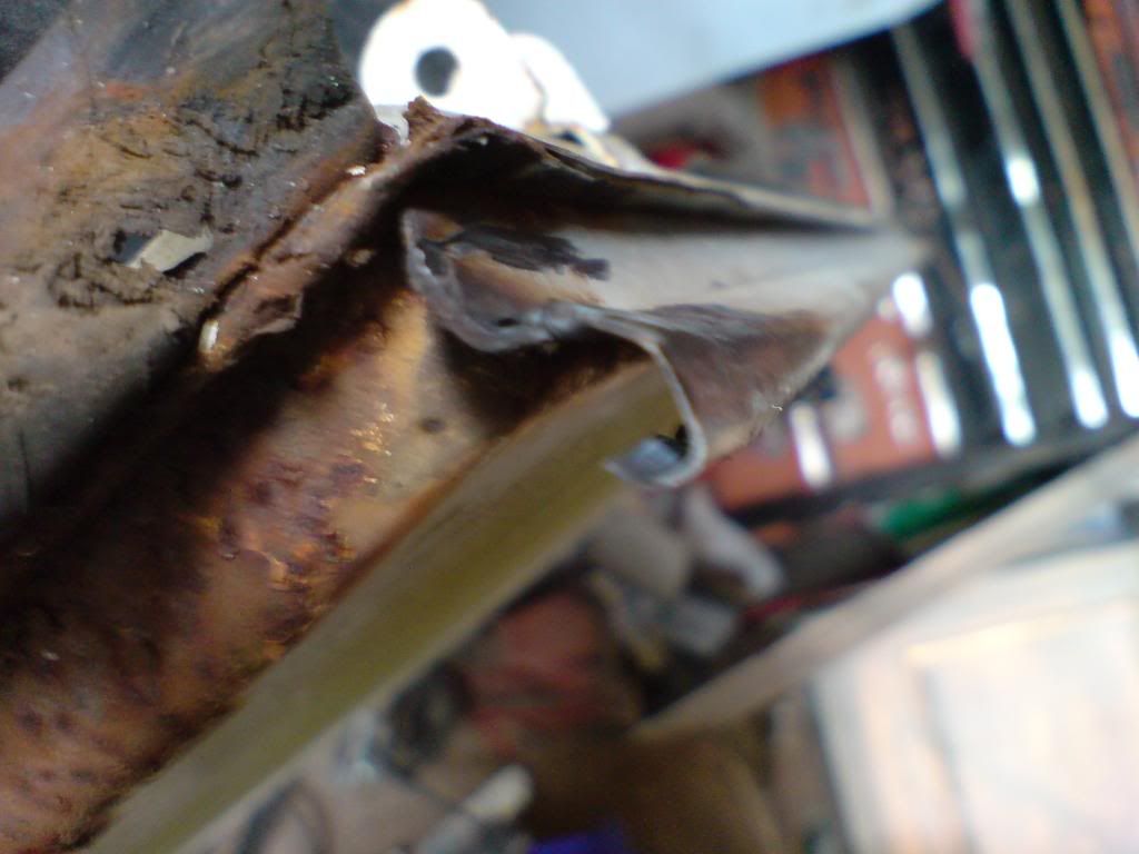

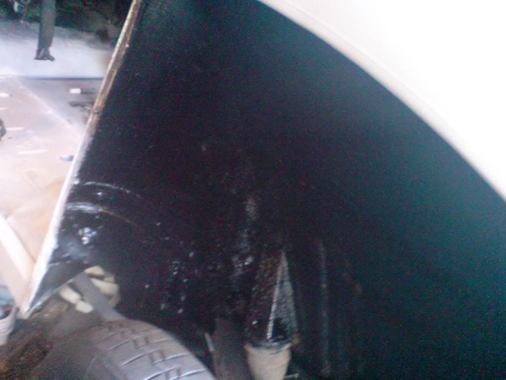

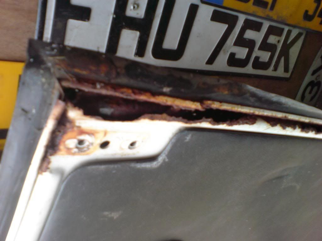

Today has seen me stuck in the garage for 8 or so hours but well worth it I'd say.
Anyway, the rot on this thing didn't stop at the floors and sills etc, it also extended to........
Seat runners, I managed to stab a screwdriver right the way through this one!
Front door bottoms
And rear door hinges :evil:
So I got the welder out for the rear doors-I'm not replacing them, it's not my car!

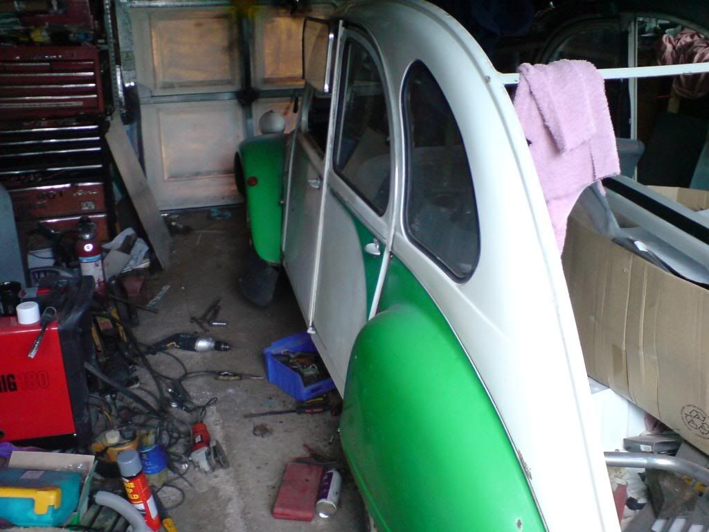

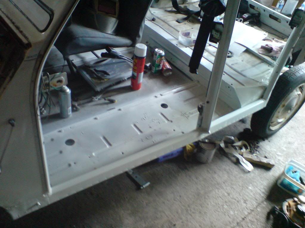

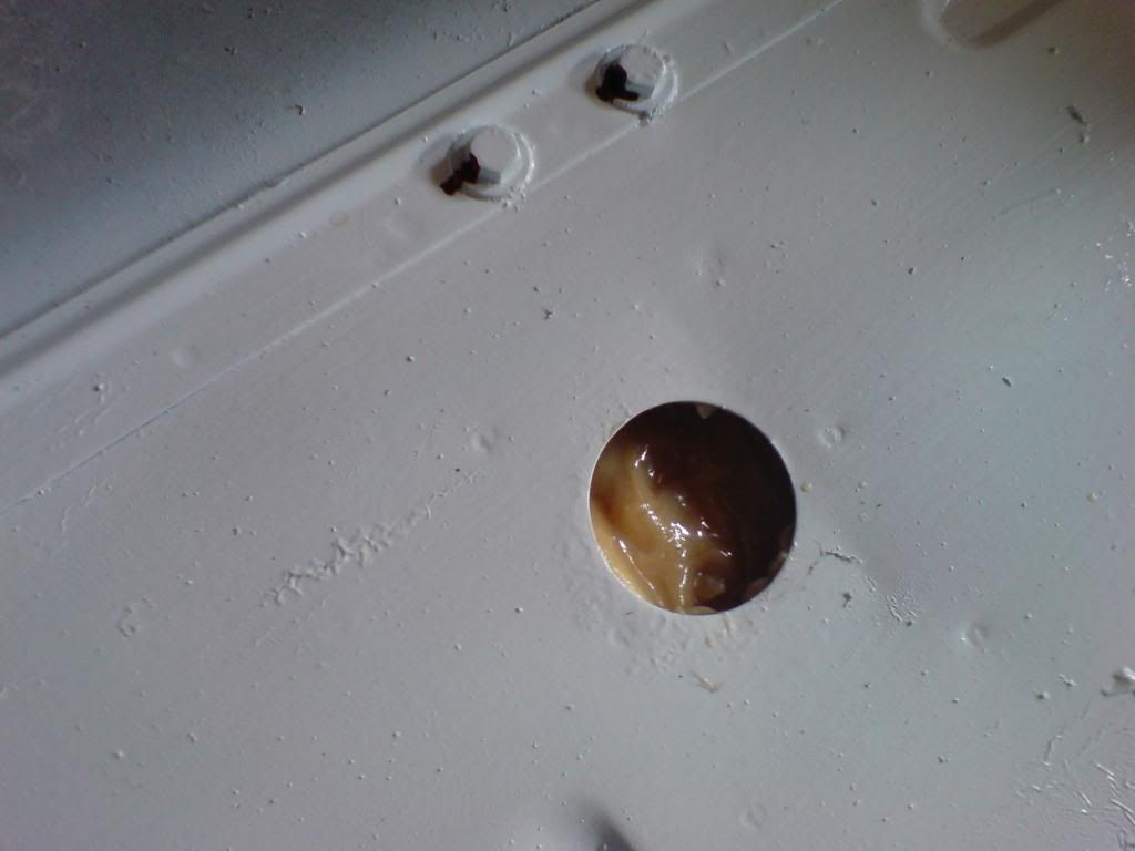

I don't want it rotting away in a hurry so I've filled all the various box sections up with Waxoyl

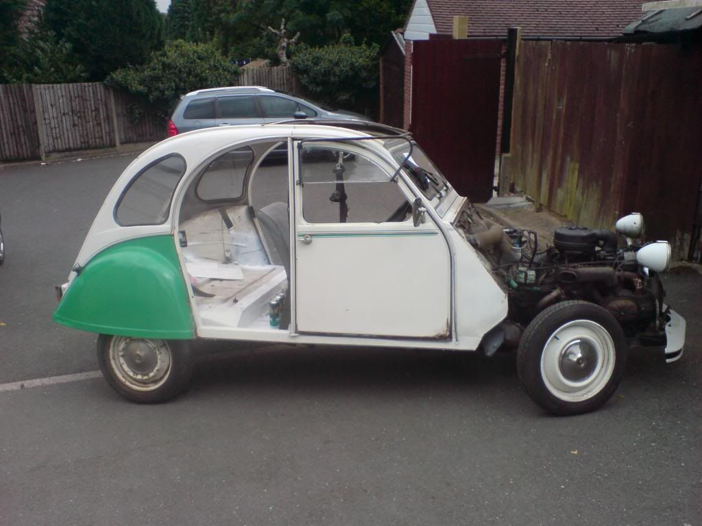

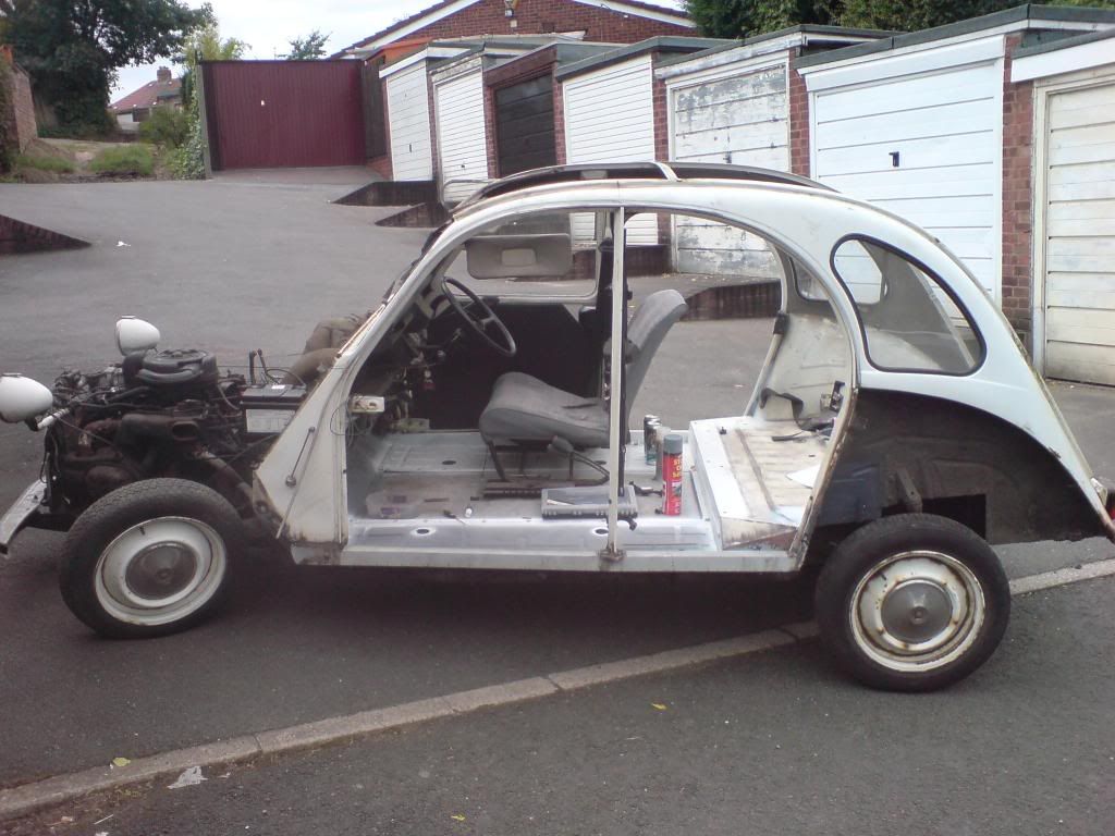

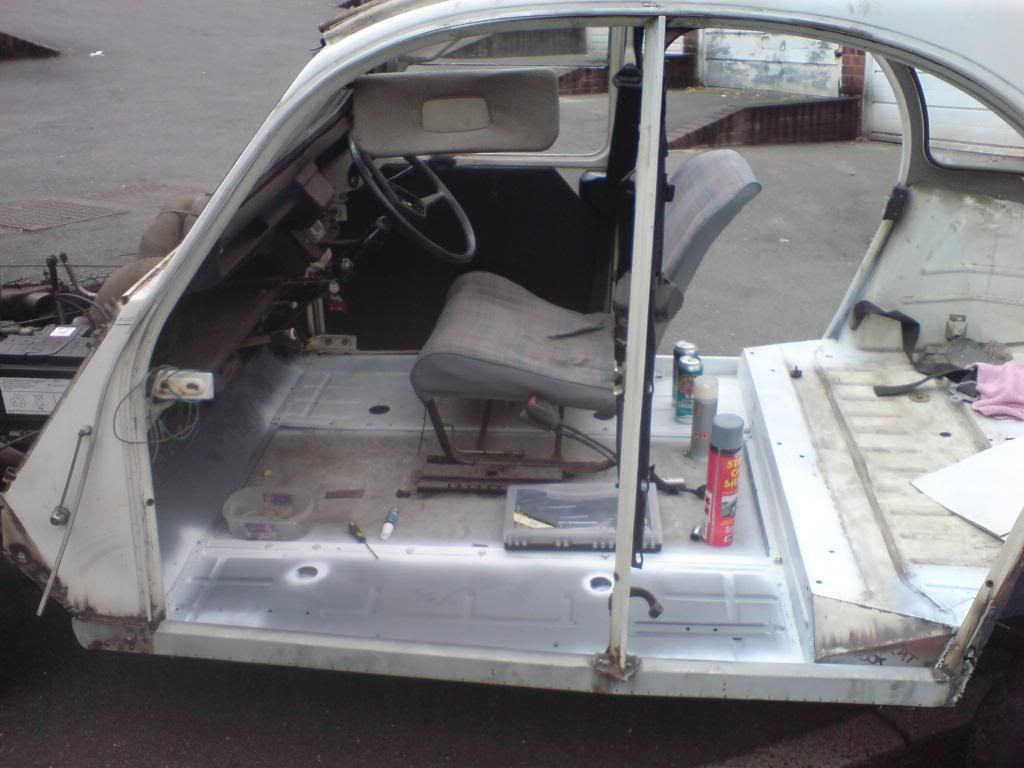

And lastly, it's starting to look like a car again at last 8-)
Hopefully have it finished tomorrow....................... Fingers crossed.
