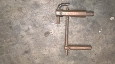

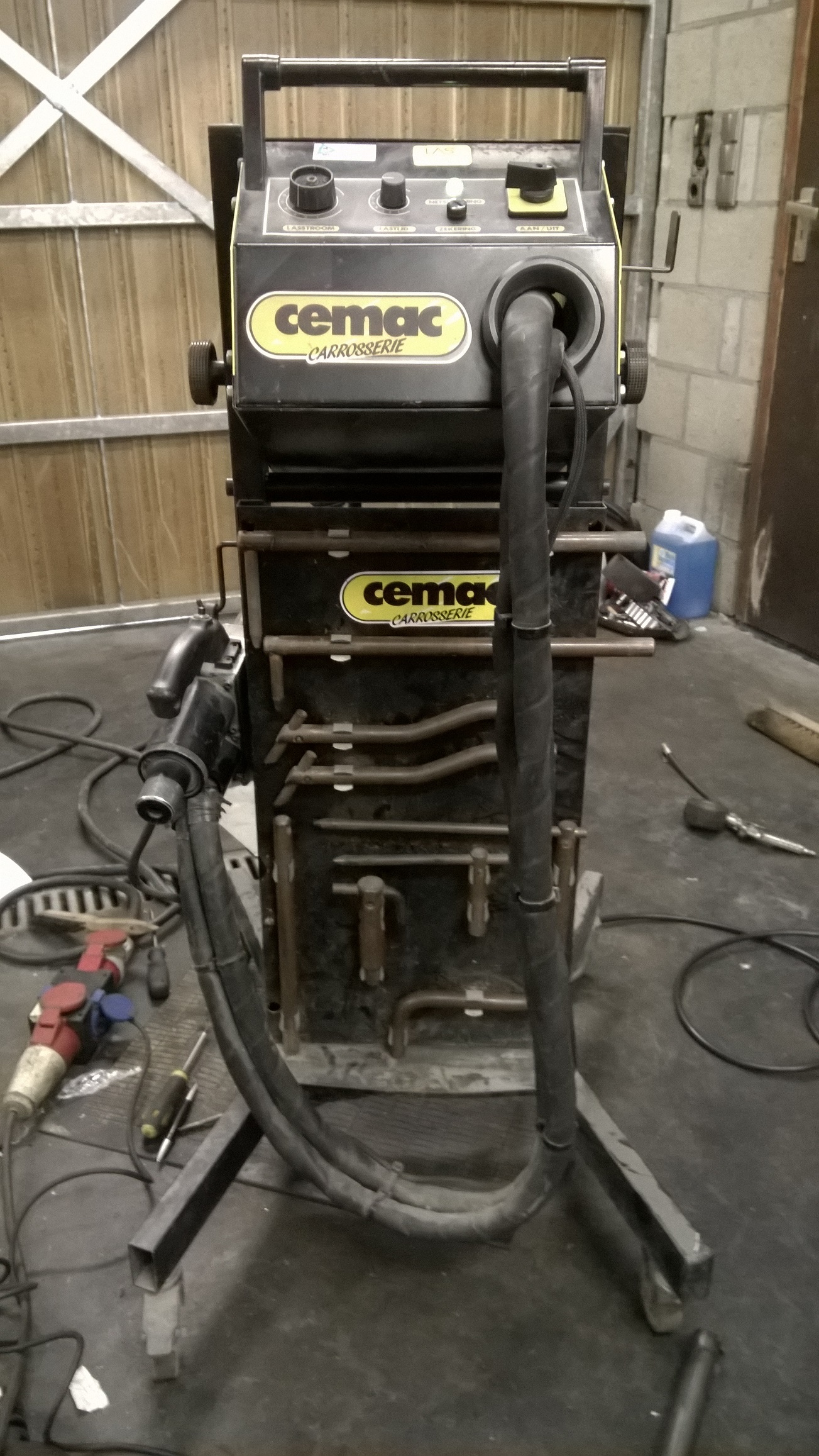

Here are some pics of it..
First an overview:

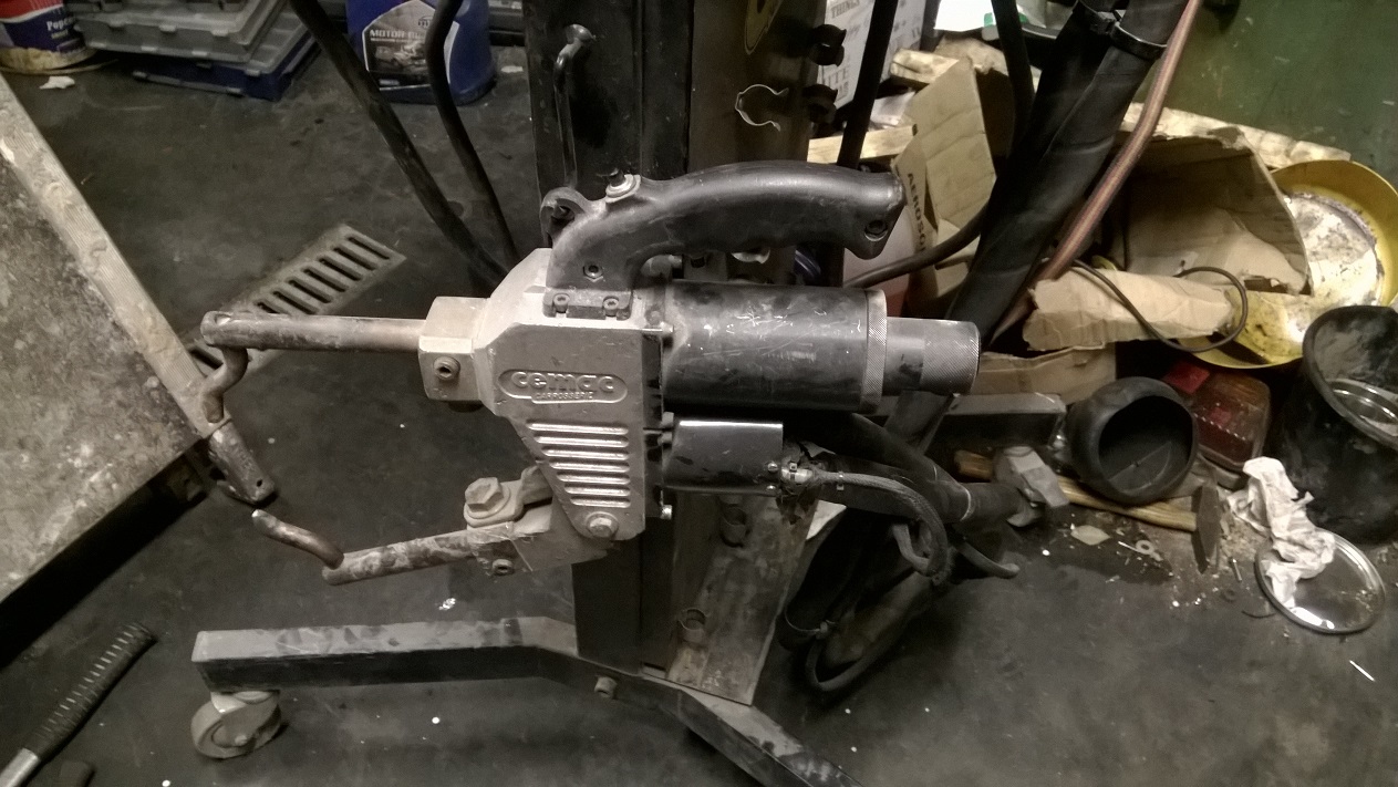

Heres the pneumatic gun
I'm still figuring out how to adjust the applied pressure, if anybody how this is set????

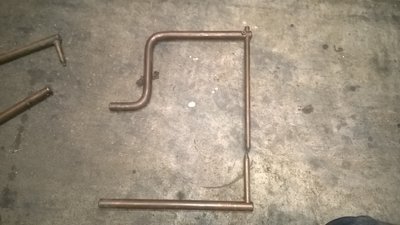

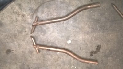

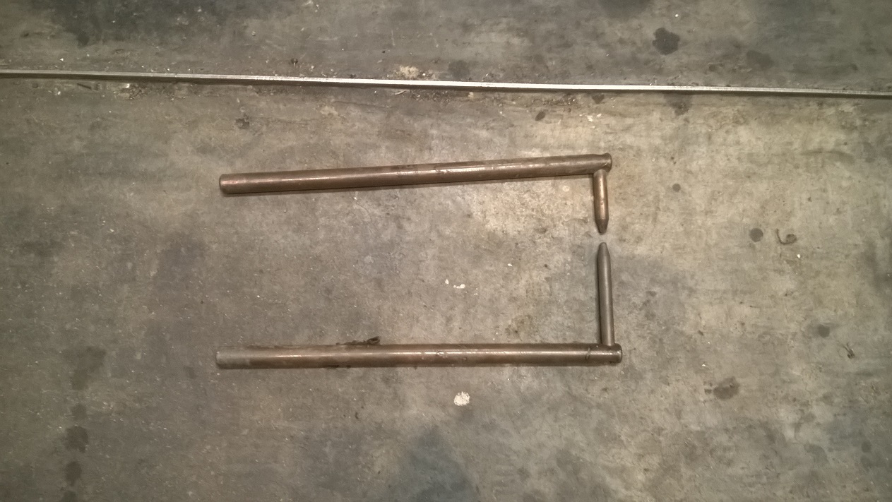

Here are the welding tools...
this is for welding wheelarches (at normal cars)..
this is for welding floorpanals in a 2cv

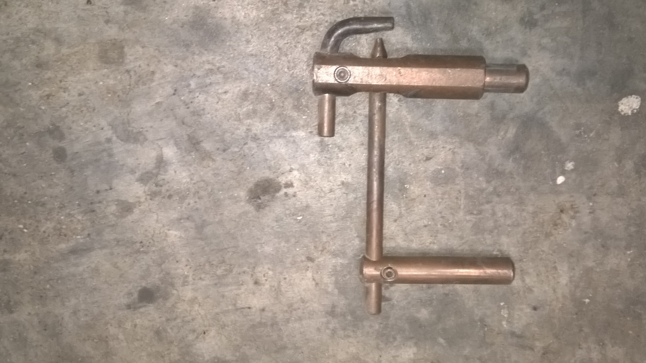

welding narrow spots
and arround pillars

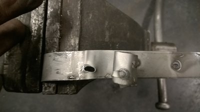

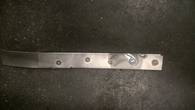

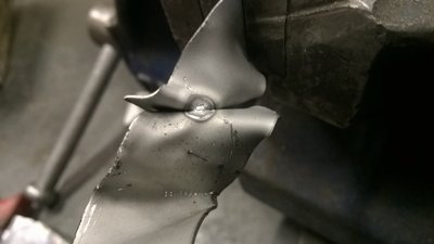

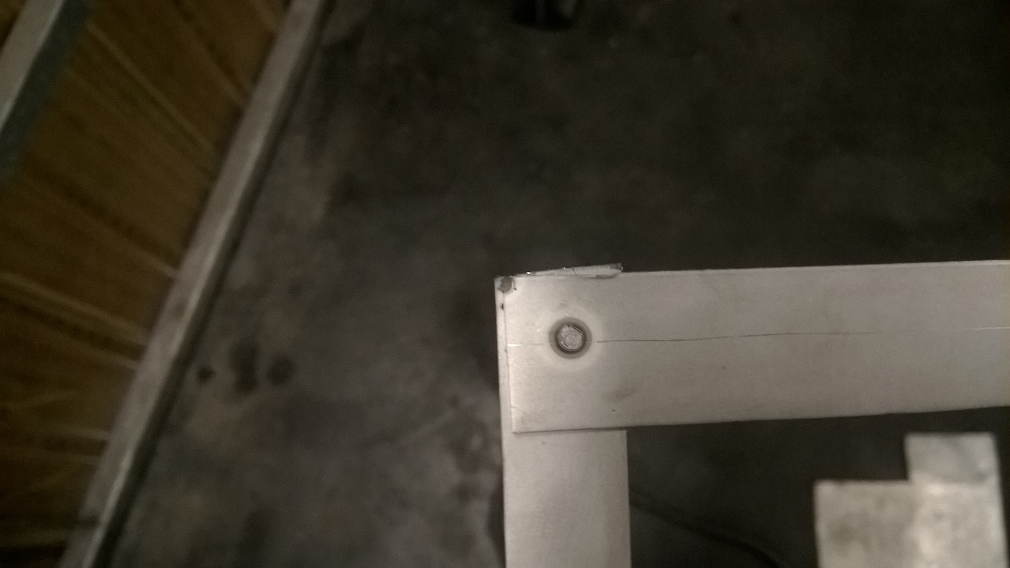

This afternoon I tried to weld some examples to get a feeling of the welder and welding..
Within 5 minits I had some good welding.. The only thing is I don't know how to adjust the pressure of the pneumatic jaws,,
If someone knows how to adjust the pressure of the jaws you would be very helpfull...
Here some examples of the welding..
I tried to seperate the 2 pieces but these are very good welds...
To me the welds are looking great... The only thing is I want to have more pressure at the jaws but I don't now how...
