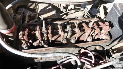

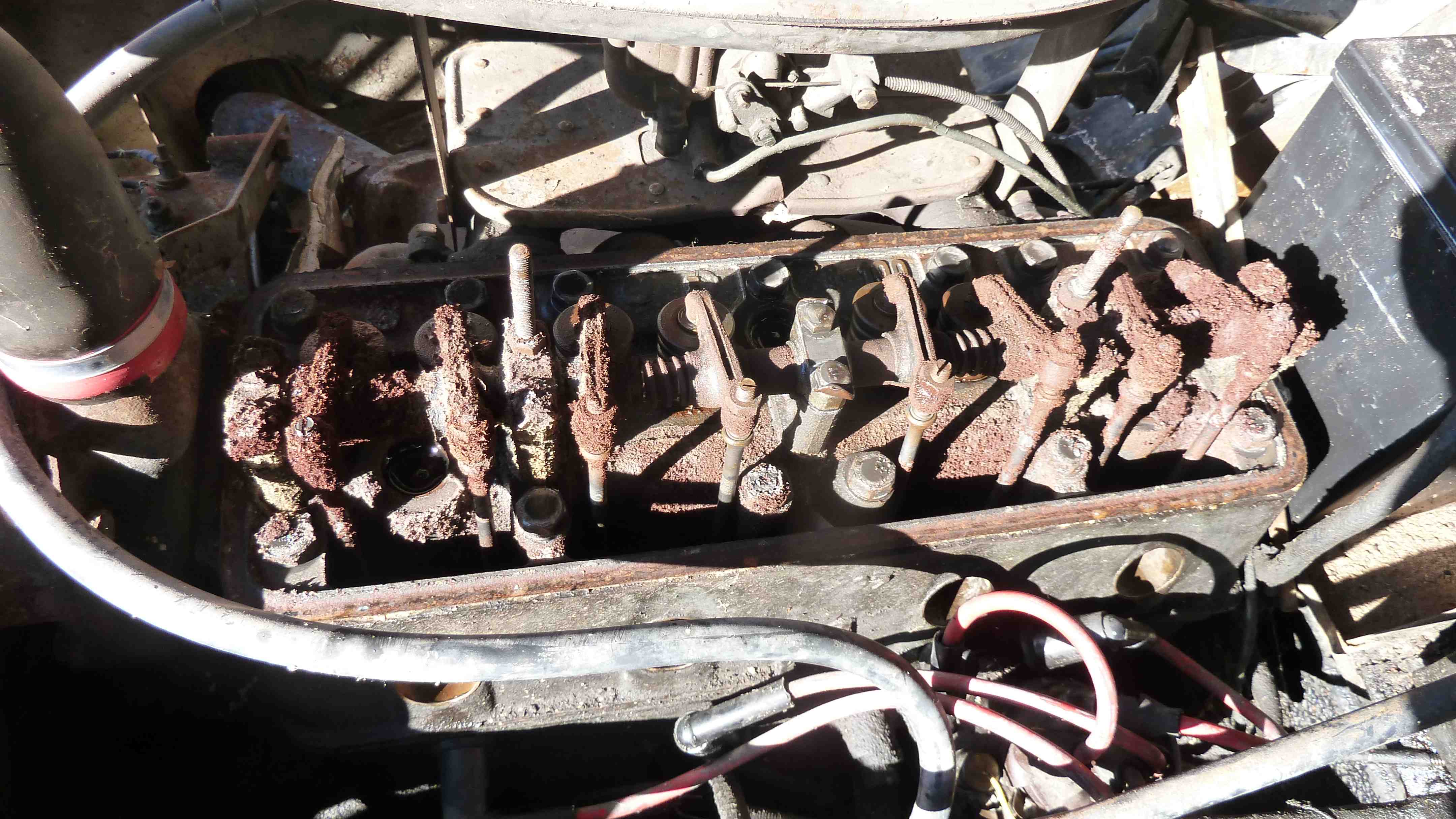

Took the rocker cover off today (it was sunny outside). It looks a little furry :D
Squirted a mixture of diesel/Oil into the cylinders and onto of the valves, just to see if anything budges.
All the documents have had to go off to the big city in Toulouse as the car is a little old and not in the modern computer system. So hoping when it comes back it will all be OK. Then I take it on the trailer to the MOT centre and get a total fail BUT a certificate that is valid for 1 month - I then will register it in my name :? that is the plan... will have to see if it works.

Do keep us all informed of progress: I'd be surprised if a good squirt of diesel into the bores won't free the engine up eventually, and if the bores are already really rusty it won't matter that much. Rather than trying with the starter, how about jacking up a front wheel and turning that, with it in gear?
After all, you may well decide to keep it.....
Excellant idea - why didn't I think of that instead of trying to weld up and make crank handles that just bend and split.
And, yes, I think we are definitely keeping it now. The local prefecture sent off the documents to Toulouse yesterday and I will await the temporary Carte Grise.
Very happy :D
January 22nd, 2014, 10:21 pm
Post Re: Anyone know about Tractions?
Hmmmm!! :?
Just jacked it up, put it into gear and turned the wheels. Both wheels turn but not the engine.
It is turning very easily, not like the clutch is slipping or anything. Tried all 3 gears and reverse.
When I crank it from the front handle, it is solid until I depress the clutch (disengaging engine) and it spin fine.
So wheel cranking is not working here, any ideas :?: :?:
January 23rd, 2014, 12:27 pm
Posts: 761
Location: Kingswood, S.Glos.
You only have to jack up and turn one front wheel. If you jack up both, the differential will turn other wheel (in opposite direction) and no drive goes to gearbox/engine.
If you can turn engine with crank only with clutch depressed then it sounds like gearbox jammed, but tractions are a bit strange. Starting handle connects to end of gearbox, I think.
John Jordan
January 23rd, 2014, 1:04 pm
Might not be what you want to hear, but given the amount of rust which is visible on that rocker gear, I'd advise against making any attempt to turn that engine, never mind start it.
The last thing you'd want to do is destroy the engine's bearings and oil feed system by feeding them with engine oil laced with powdered rust... :(
