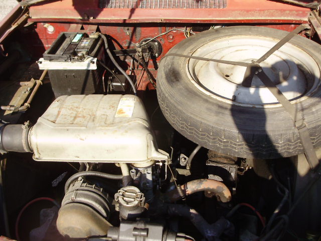

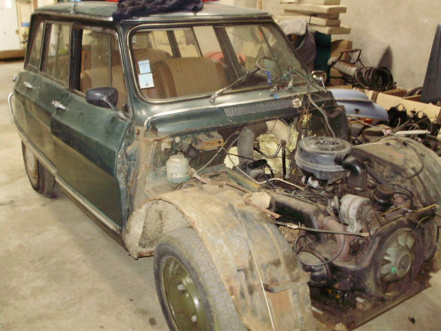

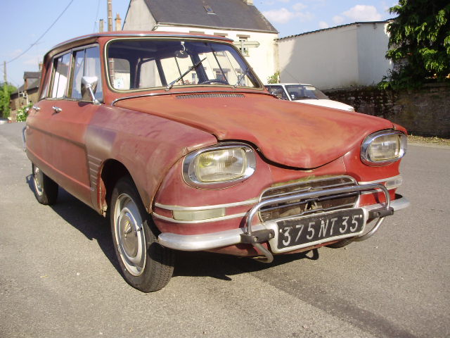

I had all these dramas when I ''upgraded'' our Ami 6 to modern 602 engine and gear box. It is hell to do, nothing works as you discovered. I was luckly that I had the last model Ami 6 from 1968 where I should steal most parts. I regret doing it and will soon convert back to original Ami 6 before 1968.
These 2 Ami's are not the same, body, engine, gear box, you name it completely different
