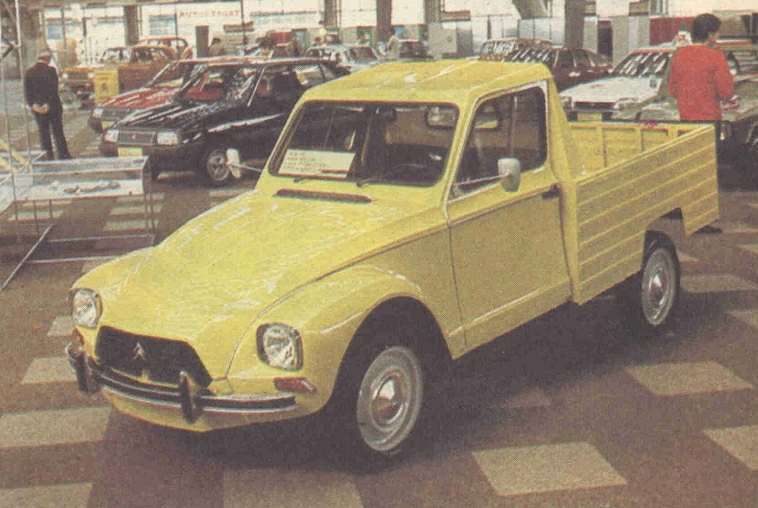

File comment: This is original picture from some fair in 1982
