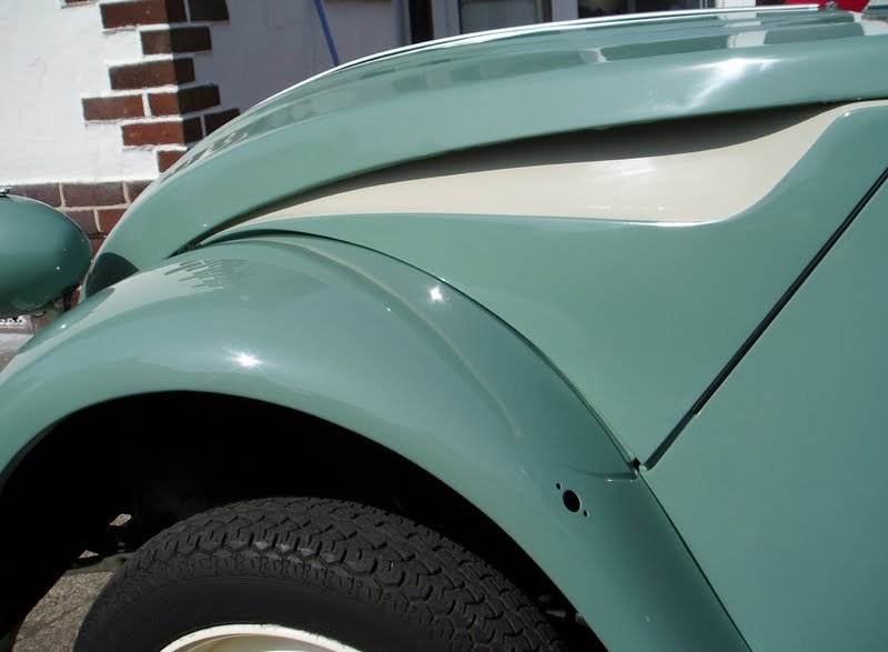

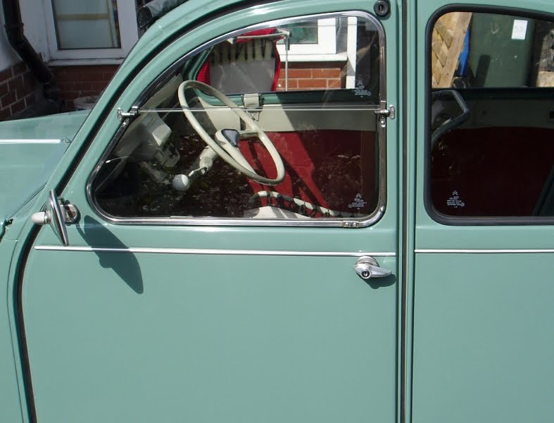

Ok so I know a 2cv can be slightly misaligned and still function perfectly, and I know that door gaps, panel and swage lines that blend seamlessly together are the province of far more expensive cars, but at the moment I'm finding the panel fit on this car to be pretty lame.
In the top photo you can see the sort of thing I'm contending with. The quarter panel has a wider gap at the bottom of the wing and again at the top, but with the middle bit resting against the top of the wing. Same thing in the photo above, the door shuts absolutely perfectly so I'm reluctant to spoil that by attempting to get a straight line across the door trim. I know many of you will shrug this off and wonder why it bothers me, but it does, because to my eyes it makes the car look like it's been thrown together, which it hasn't.

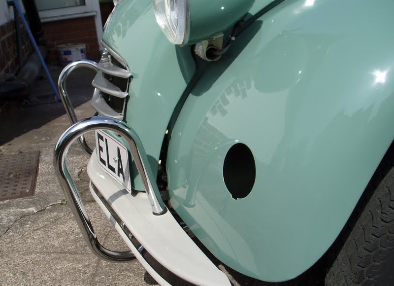

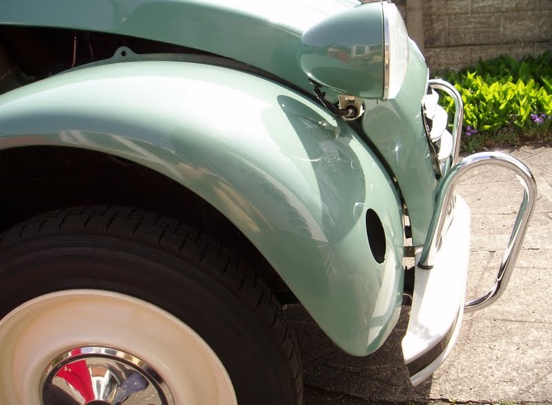

More annoying than anything else is the gap between the front wings and the bonnet. Looking from the drivers side the gap appears quite acceptable, but look at it from the nearside as in the photo below and the same gap is double that of the first one!
As the wing is mounted to the headlamp bar at the front there isn't much wriggle room for making things line up slightly better. Both wings have to come off again anyway because guess who forgot to replace that steering tube bottom rubber seal? But I would like to think a better set of gaps could be had next time, at the moment though I don't see how, any thoughts?

what about a spacer to push the nearside wing forward to close the gap off? i found that i have to wiggle my wing about to make them fit properly (probably not the ideal way to do it with fresh paint)

don't mess around with panel gaps it aint a lexus, if it int bust don't fix it.

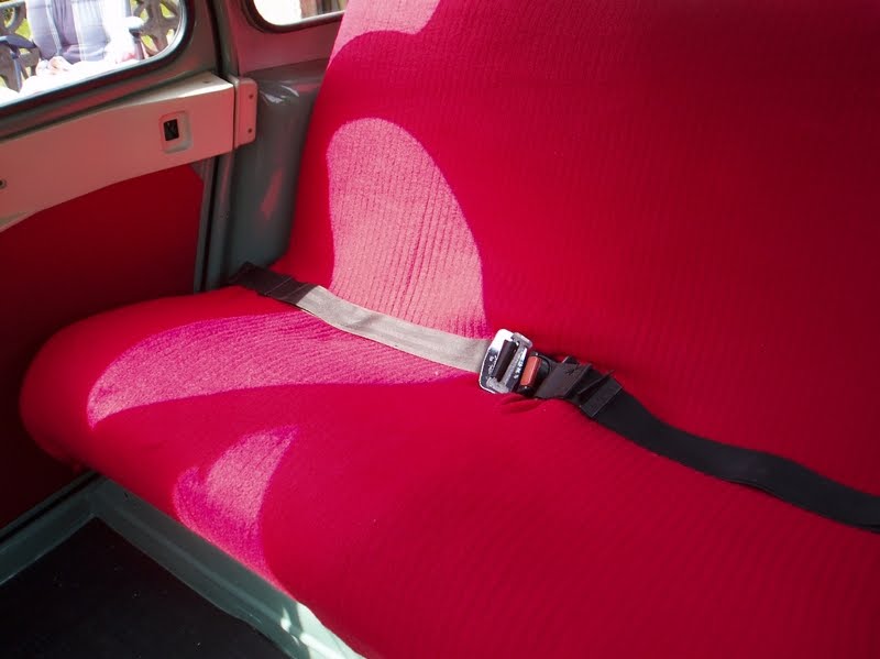

I had the rear seat cover that she had already made up handy so I decided to put that in today. I managed that without too much drama, and the back of the car now looks and feels a very comfy place to be.

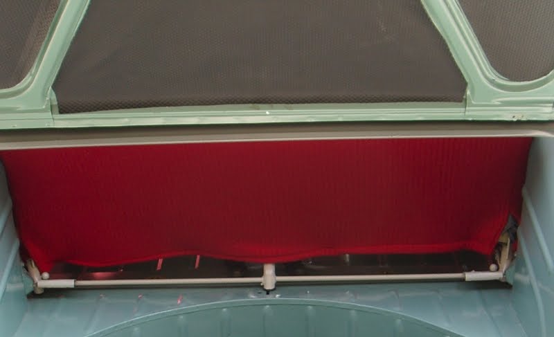

I'd also asked that she did a back part to the seat cover so that it hides the foam and elastic view as seen in most 2cv's when the boot is opened. It turned out quite well I think. Well done my Mrs! 8-)

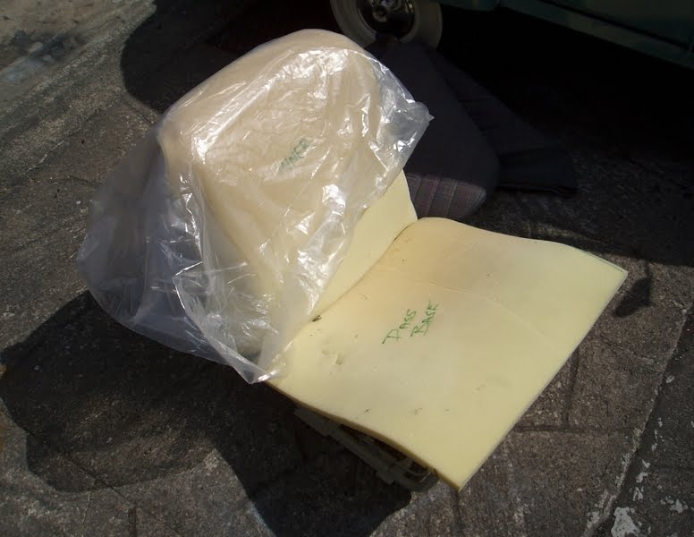

What I've been doing is machine washing the old original seat covers, before re-mounting them over the new foam and innards, and then finally adding the top cover that has been made up specially. Anyone who's ever had a go at this will know that trying to get the top of the seat back part of the cover pulled down over the new foam can be a real swine, with the cover pulling down on the foam and causing it to move. Below is the best tick to prevent that happening, place some plastic over the shoulders of the foam, slip over the cover easily and quickly, pull out the plastic sheet - done!

Panel gap
is the light bar pulled as far forward as possible
is it a repo chassis? old wheels ones were a 'mare with the lamp bar being too far forward and stretching the wings the other way, as well as the outriggers neeeding packed out with old shocker washers.
never fitted a city one
sean
May 21st, 2010, 7:42 pm
Post Re: My old Blue Bamboo
Sean the chassis is an old wheels one so tell me more please! How do I fix it?
