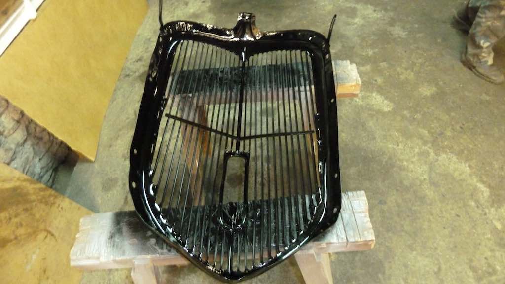

Final few coats of "protection" paint go on the front grill

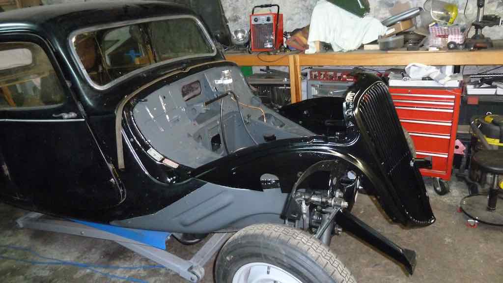

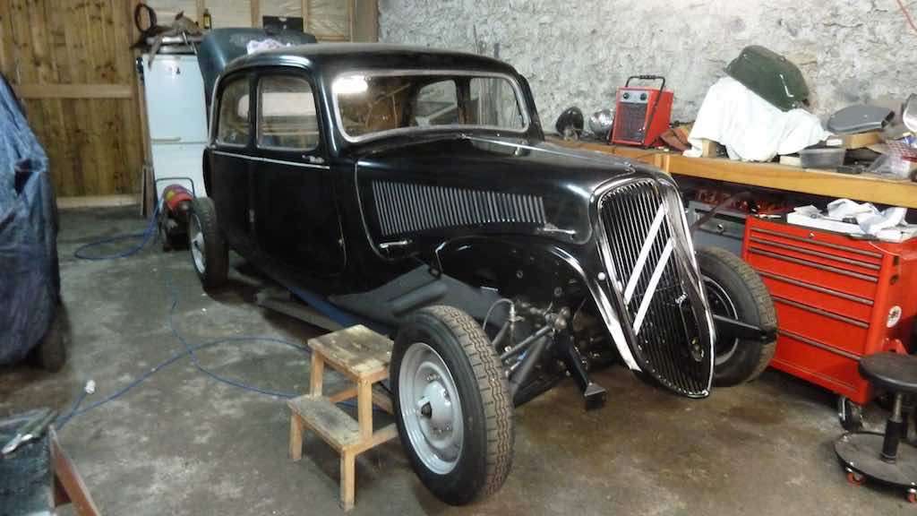

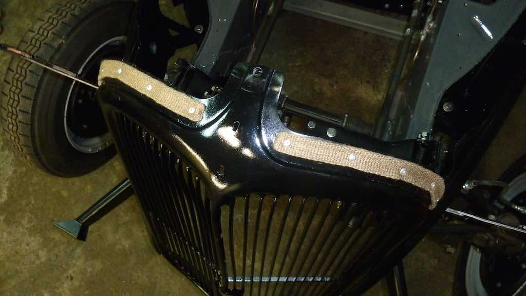

Although I am no where near ready to do this, it had to be done. I put the grill back on the car. This is the first time in over a year that it actually resembles a Traction. And I can also start to see where everything is supposed to go too.

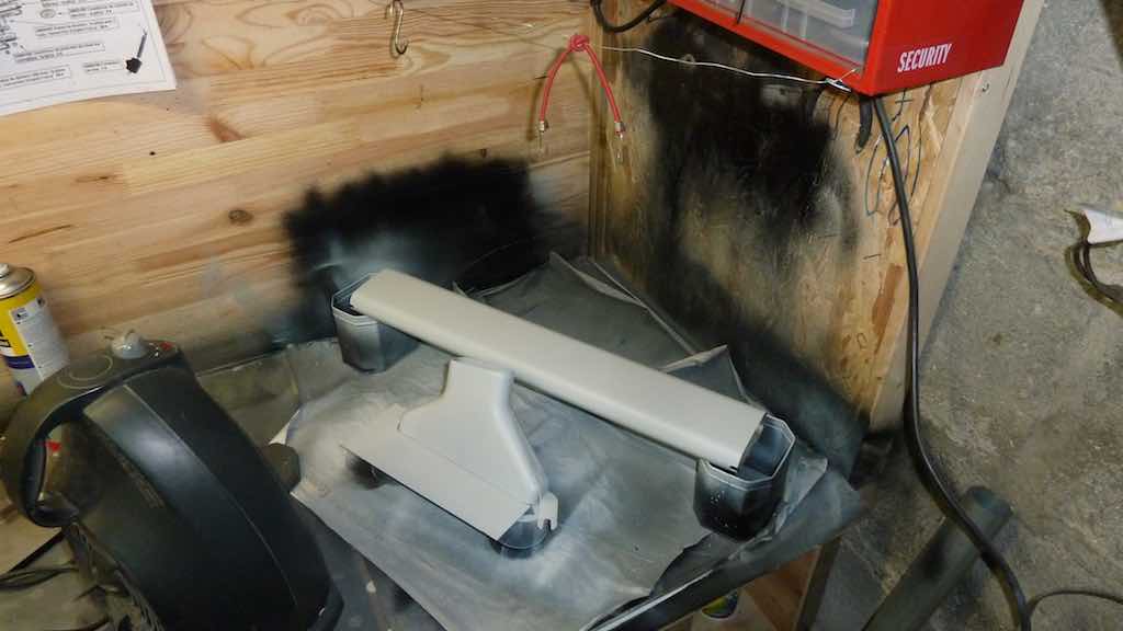

On with the painting - Another unit I was going to throw away as it looked so tatty was the heater tubes. But in the end it was purely the rubber joints that had perished and was taped up by the previous owner. Took all that off to reveal perfect metal and after sandblasting and priming they look brand new again.
Here is the paint shop with fan assisted drying :)

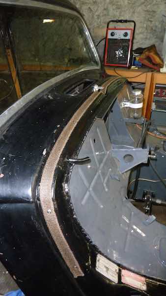

In between painting there is plenty of small jobs to do like riveting the front weather strips to the newly fitted grill.

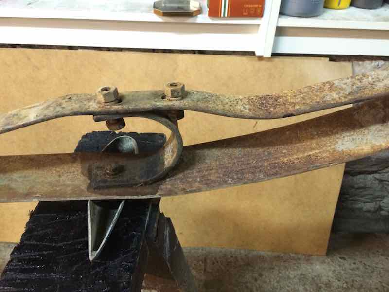

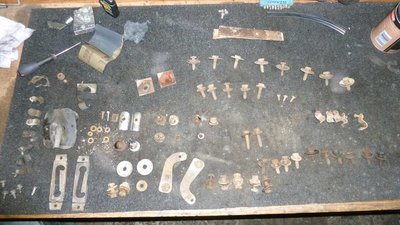

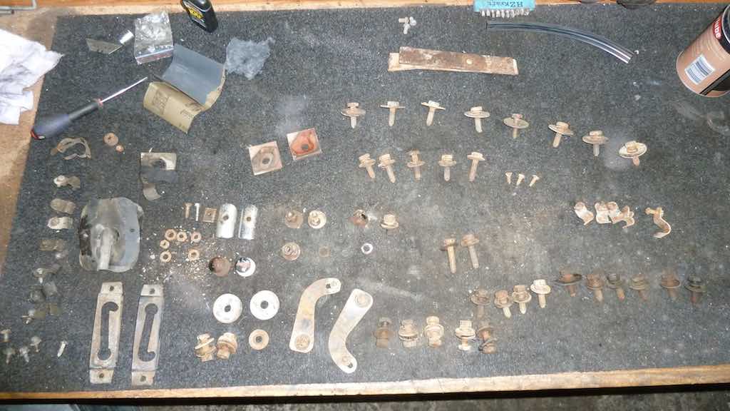

But although I said the cleaning had finished I emptied all my tins of bolts to see what I had left. It is mostly bolts for the wings but the bonnet opening parts got me thinking about something else. :?

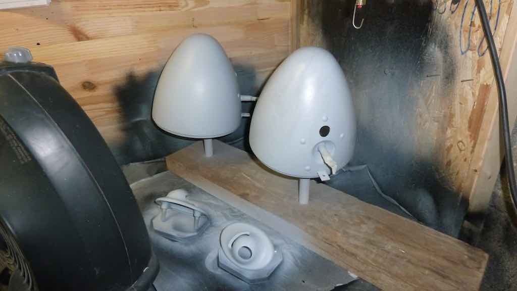

More painting, I was going to leave the lights alone but after all the other painting I have done they looked a bit of a mess so I micro blasted them and primered them. Final coat is being applied and in between coats I am wet sanding them.

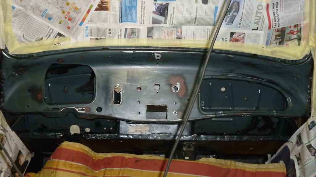

I have sanded the dashboard and prepared it for paint

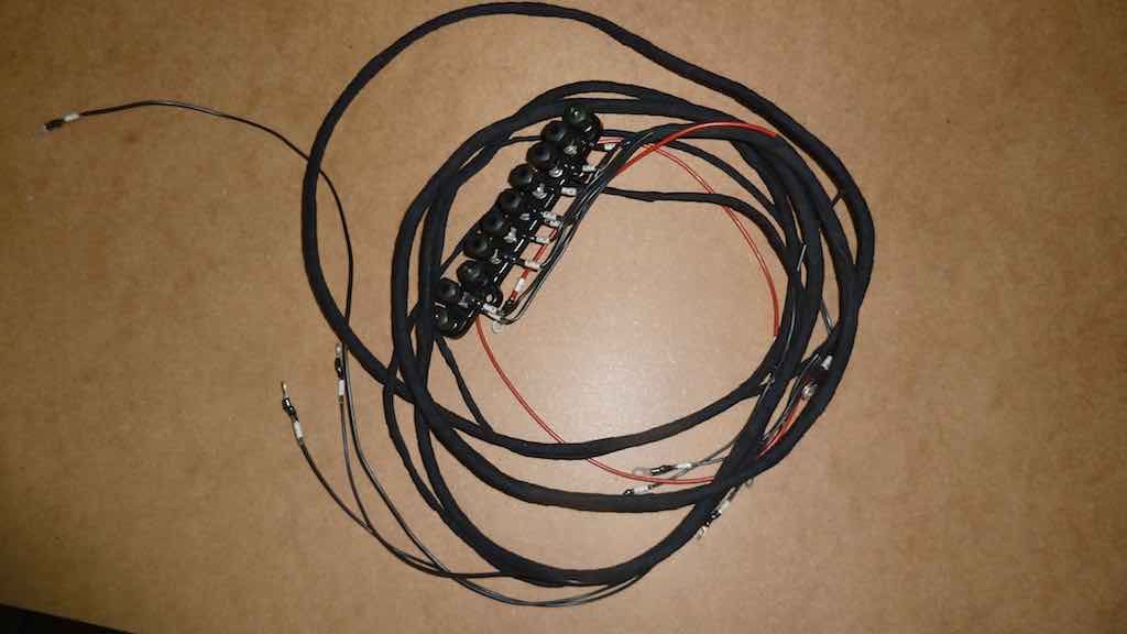

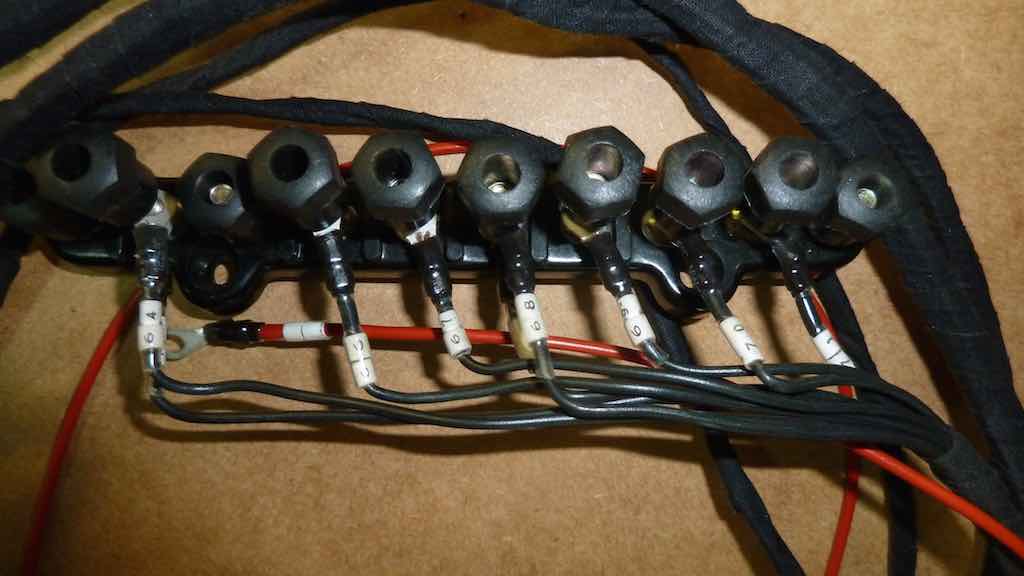

I have completed my first wiring harness. This the long connection from the front connection block to the rear which feed the rear lights, feel sender etc. Added an extra one for the fuel pump. It has worked out alright except it is very fiddly with the little heat shrink numbers.

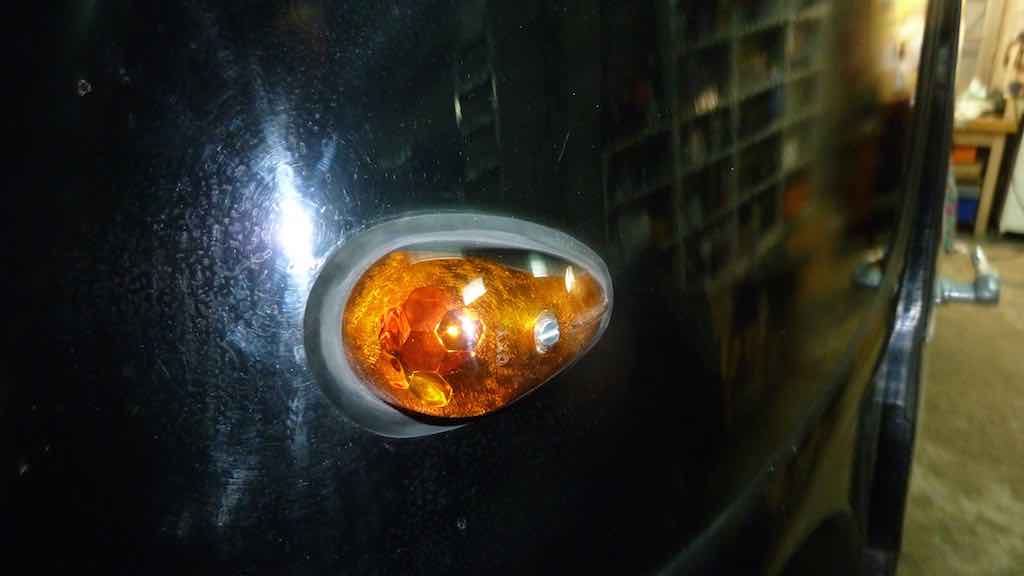

The car has had its first new parts on the exterior, the rear indicators are bolted on (after a bit of T Cut and polish before hand on the body work) and wired up.

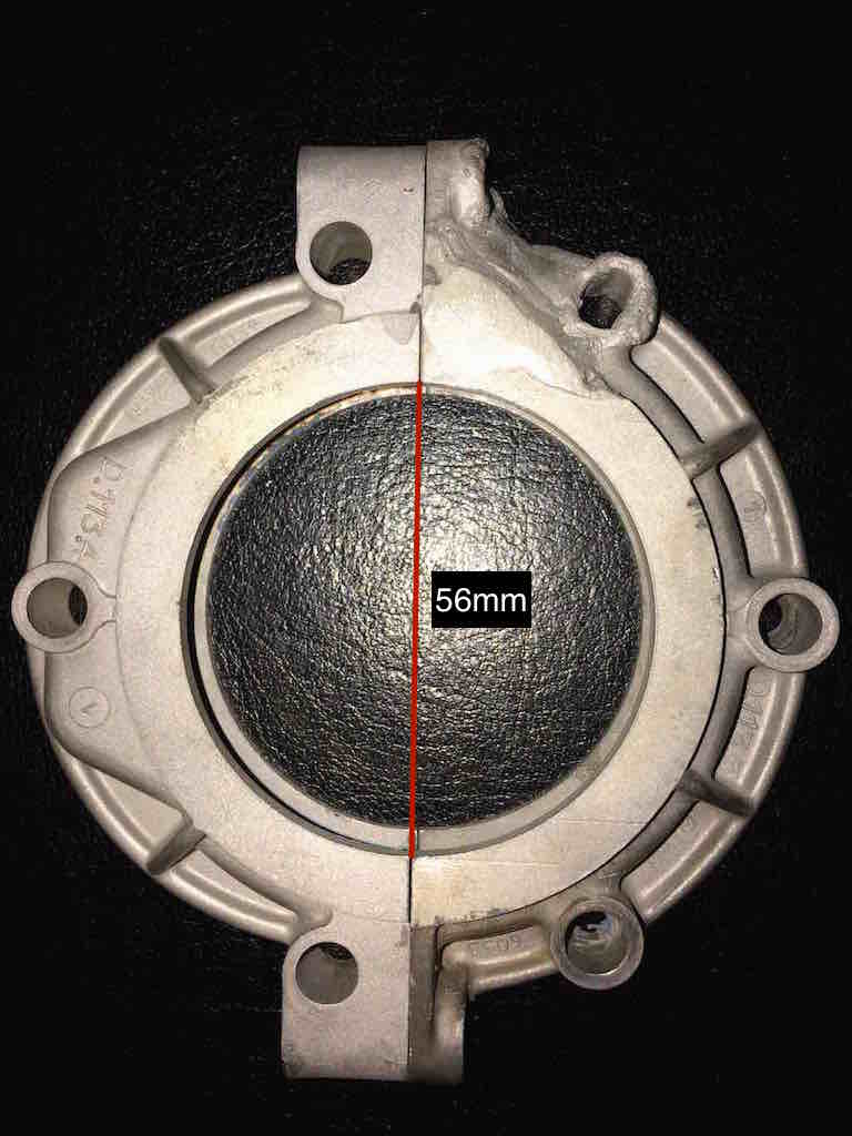

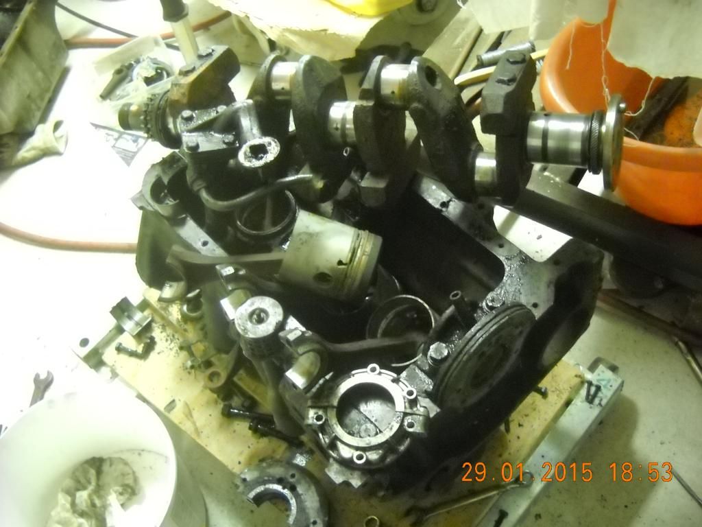

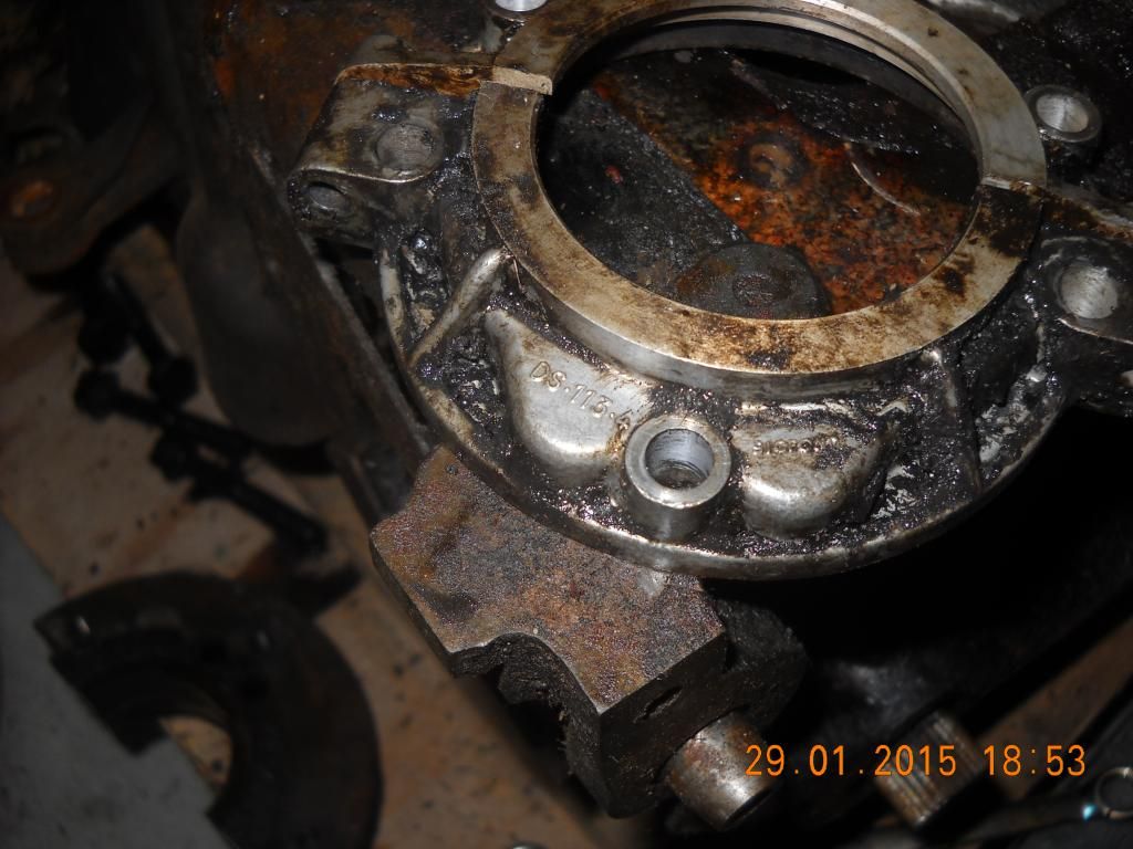

Tripyrenees wrote:
My car came off the line in the 12th April 1955 and stood in a barn since 1972. I have had a few explanations as to why my bottom end is part 11D (DS) and part Perfo (Original Traction) as the engines changed to D from May '55.
Here is what it is supposed to look like.
Looks very similar to me? Same part number can be seen...
This engine came with -63 ID, with engine from ID Familiale -59 according to engine number plate...
January 29th, 2015, 10:39 pm
Hi Jasu
Just sent an email - just need to check the diameter of the inside to make sure it is 56mm. To me, if the part numbers match then it should be the same part, but the Frenchies on the TU list are adamant that the ID engines had a bigger diameter on the crankshaft.
January 30th, 2015, 9:35 am
Posts: 501
Location: Korpilahti, Finland
Yes it seems to be 56mm. As you see, parts are much cleaner now...
We tried to found about mention of different diameter crankshaft, but all we found was these parts were used till -66. Crank itself alters in somewhere (don't remember when), there is "short" and "long" crank, early is short and with long crank there is a damper outside the timing cover...
January 30th, 2015, 10:32 am
That is the one for sure - Thank you :D

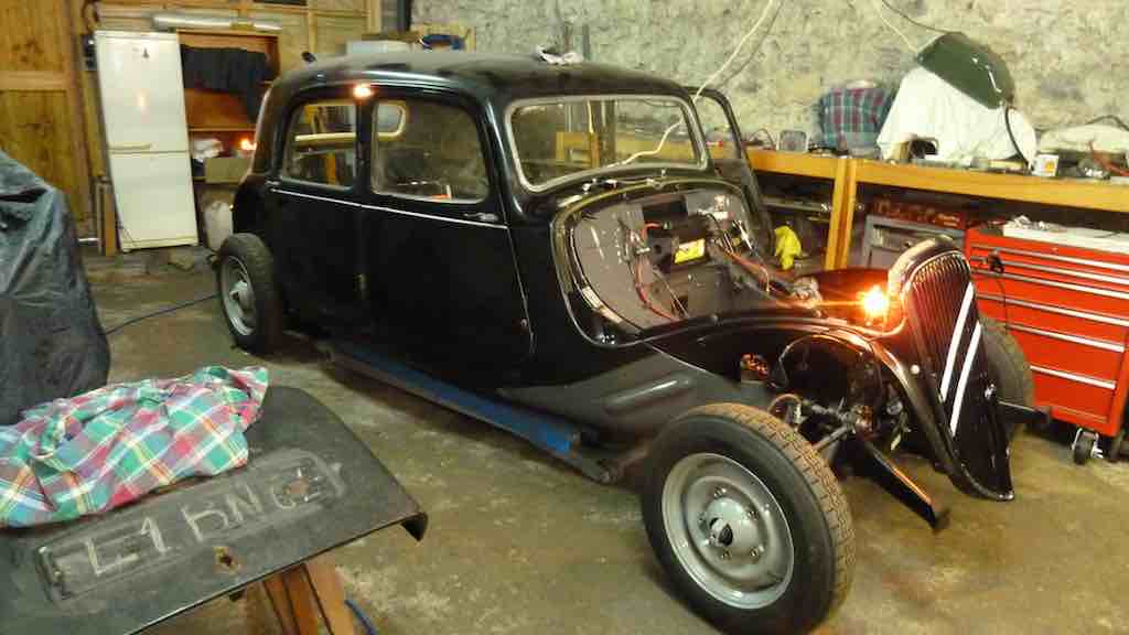

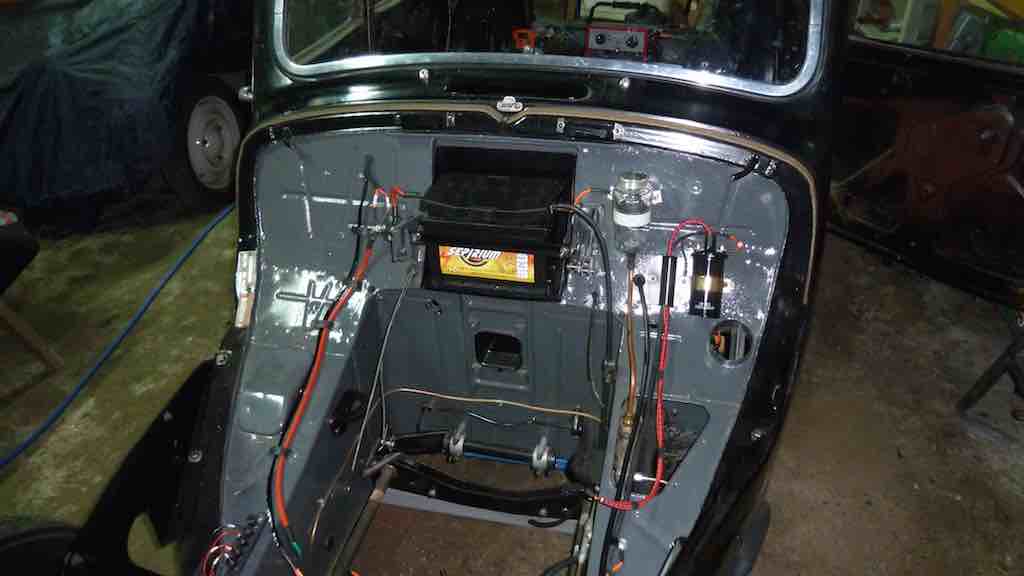

It has been a while but I have been busy at it.

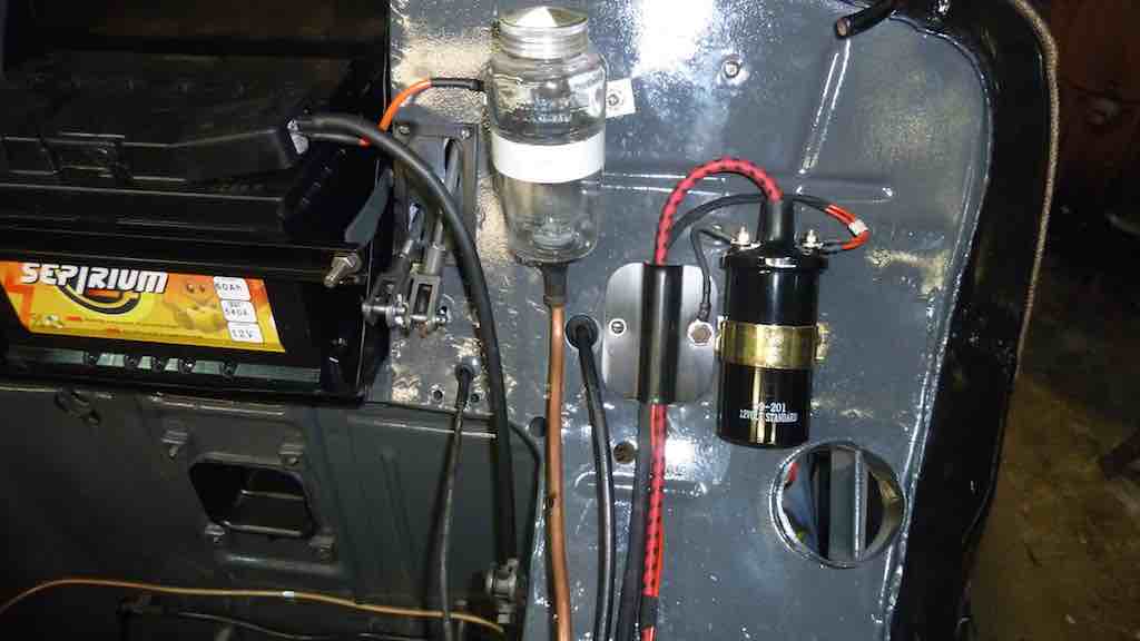

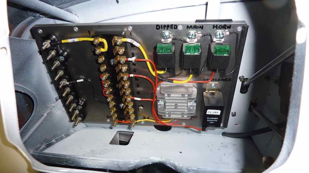

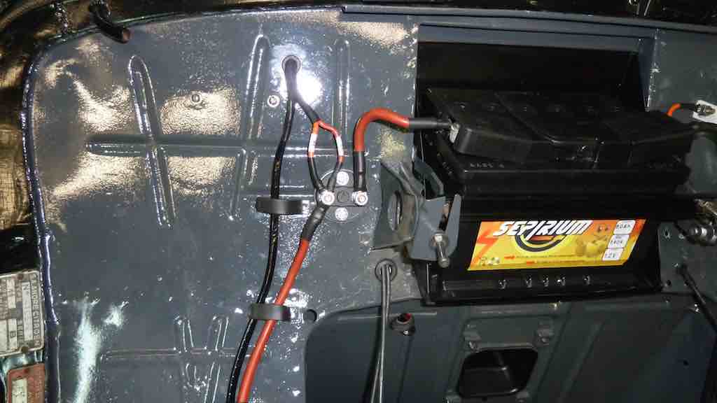

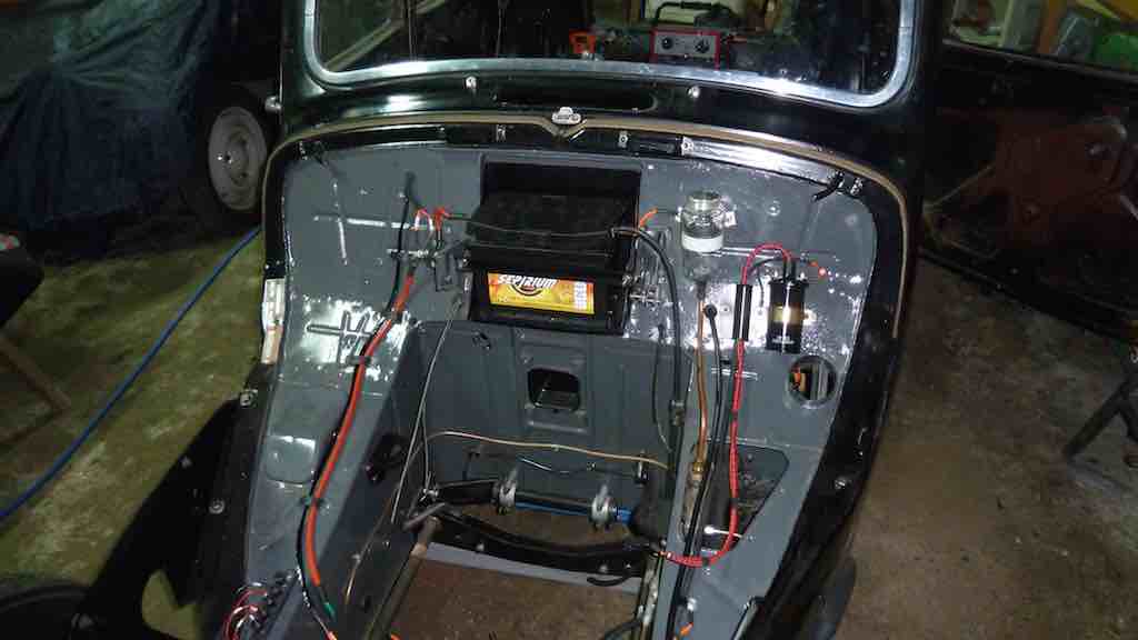

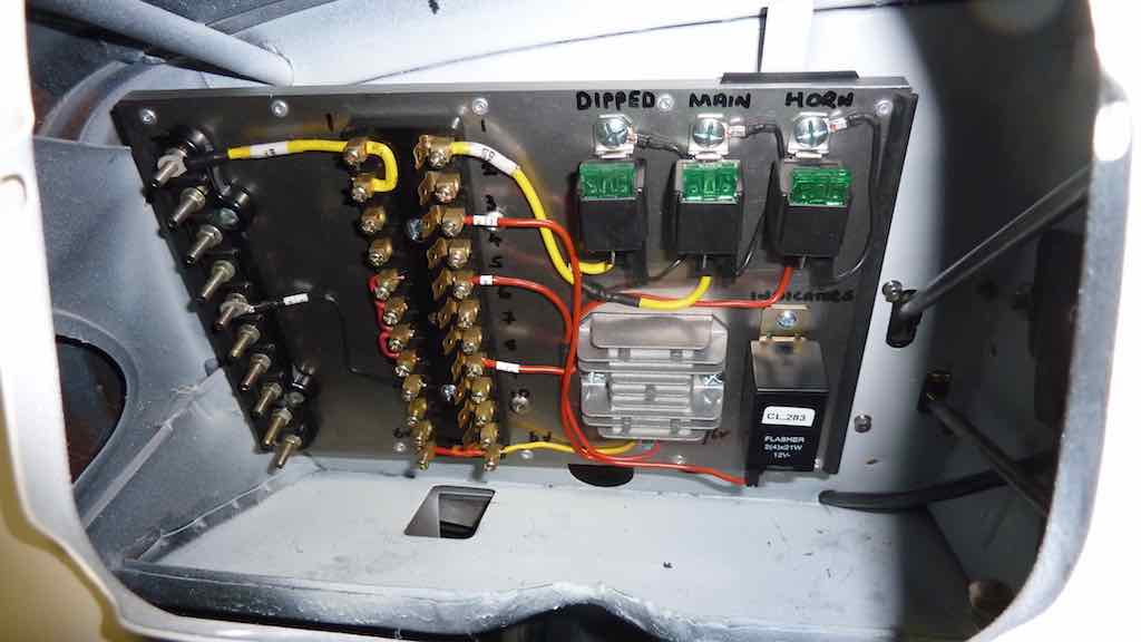

The whole car has now been rewired. All 12 volt with wiring looms, relays and fuse box. It looked quite easy when it was on paper but it is a big job. About 4 days of work but it is near enough done. Just some tidying up to be done once I have tested all the circuits.
I created a new plate where I bolted all the new electrical parts onto and then this just bolts onto the original fixings as I did not want to start drilling into the bulkhead, although I have had to for some other parts. This unit is totally hidden by the dash but is easily accessible.
I tested the first circuit, being the indicators. I did make one mistake though. I did not realise the indicator switch I bought (original 60's) was also the flasher unit so I was trying to trigger it by a 12 volt flasher I bought. So at least one piece can go and leaves room to extend the 6 volt converter if needed.
The front end is starting to get some colour now. I picked up a 12 volt coil at the Bourse last week and a battery cut off switch so every wire is now in place....ready for the engine :D
