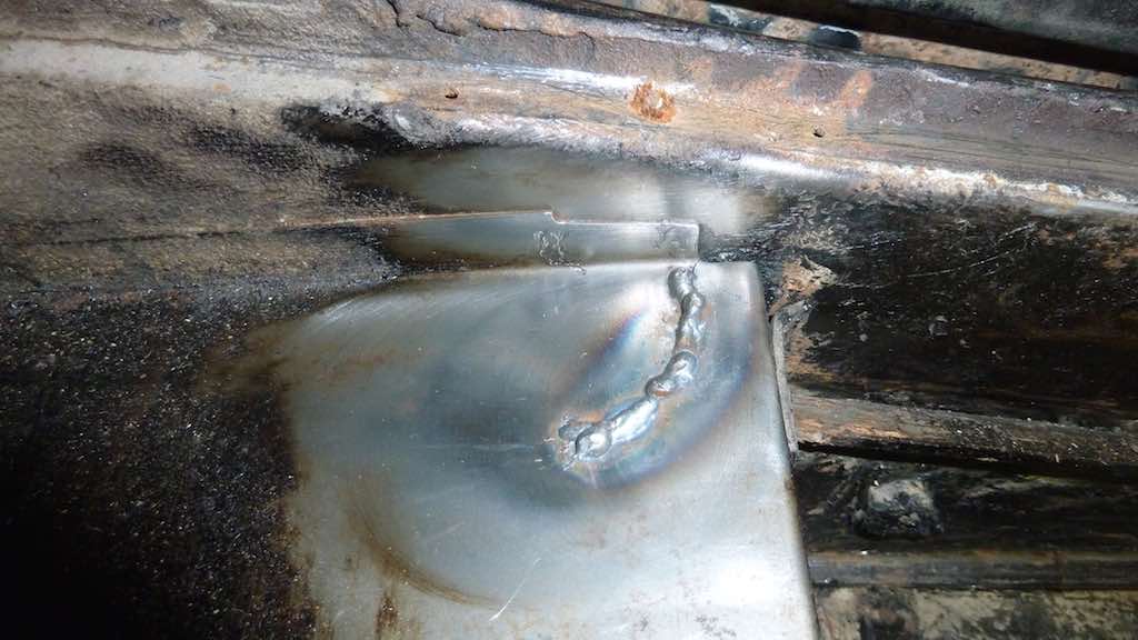

I had to weld the rear seat area where there were small cracks in all 4 corners - too many passengers in the back at one time I think.

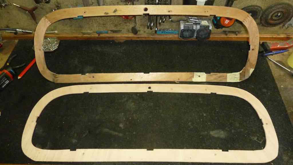

I made up the rear winder inner frame - I can't believe they charge €33 for this.

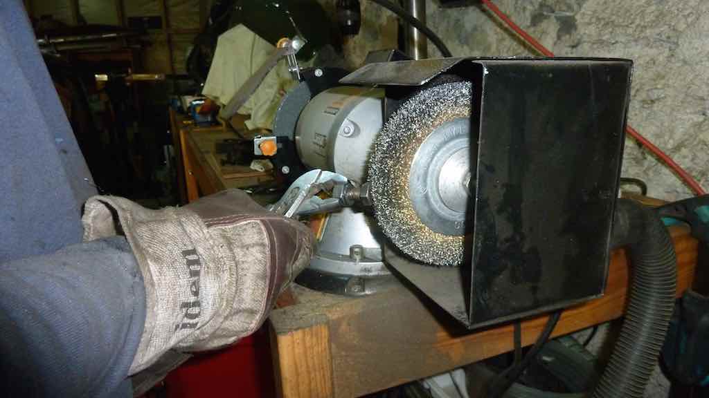

And more and more wire wheeling and cleaning. I have wire wheeled every single nut and bolt so far. It takes an age :? - I have decided to start rebuilding the front of the car which means cleaning all the parts and trying to remember where they all go.

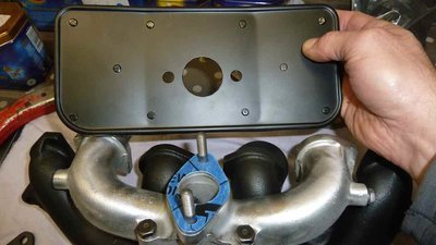

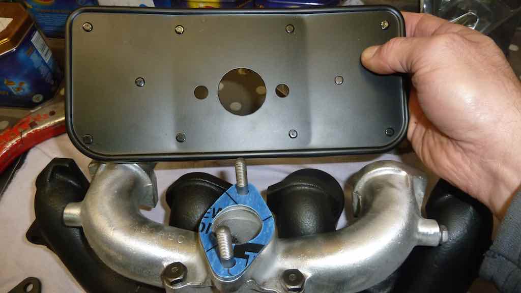

Pain in the arse though, I just received the Carburettor heat shield that sits on top of the inlet manifold and the holes are in the wrong orientation. I don't know if there are different models but all the ones I have seen go along the head and not across it.

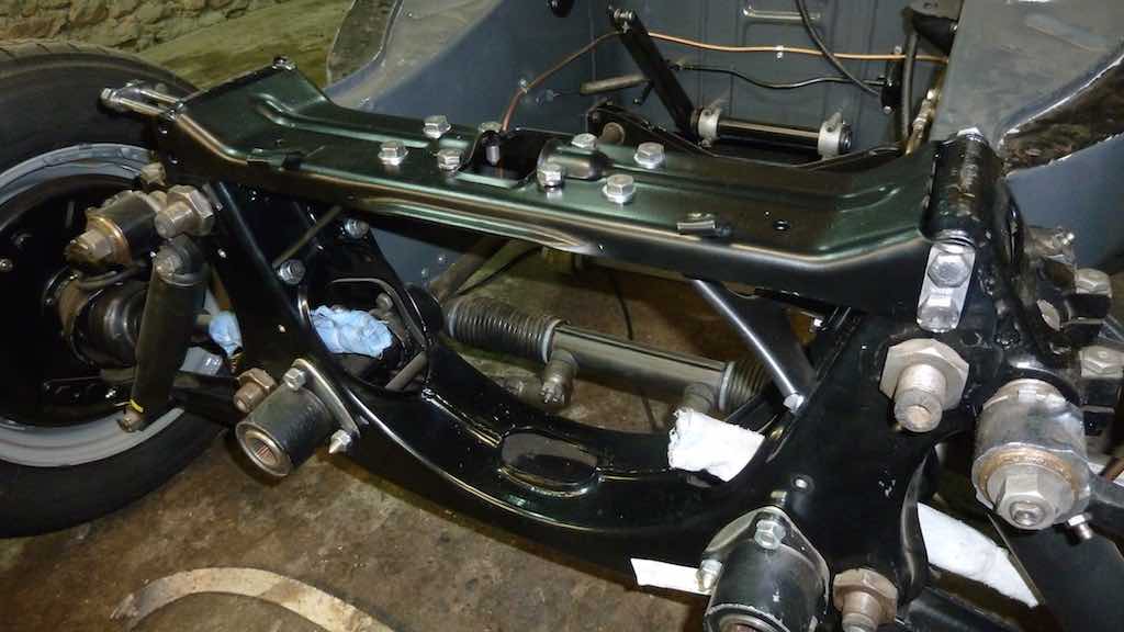

I have bead blasted, primered and top coated the cross brace and supports for the gearbox - this was in a right state (as is everything with this car). I have put it all loosely in place so nothing gets lost or damaged.

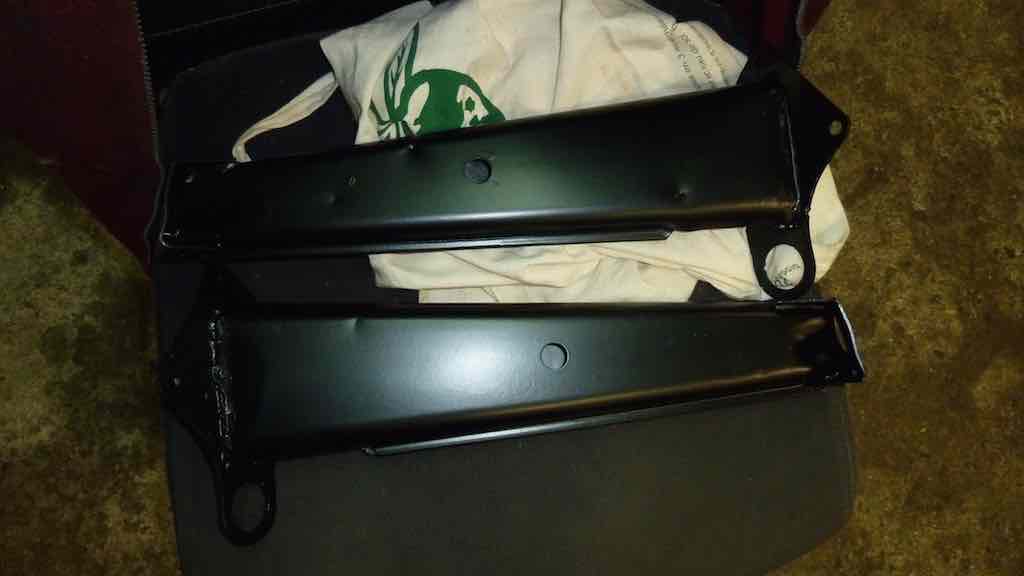

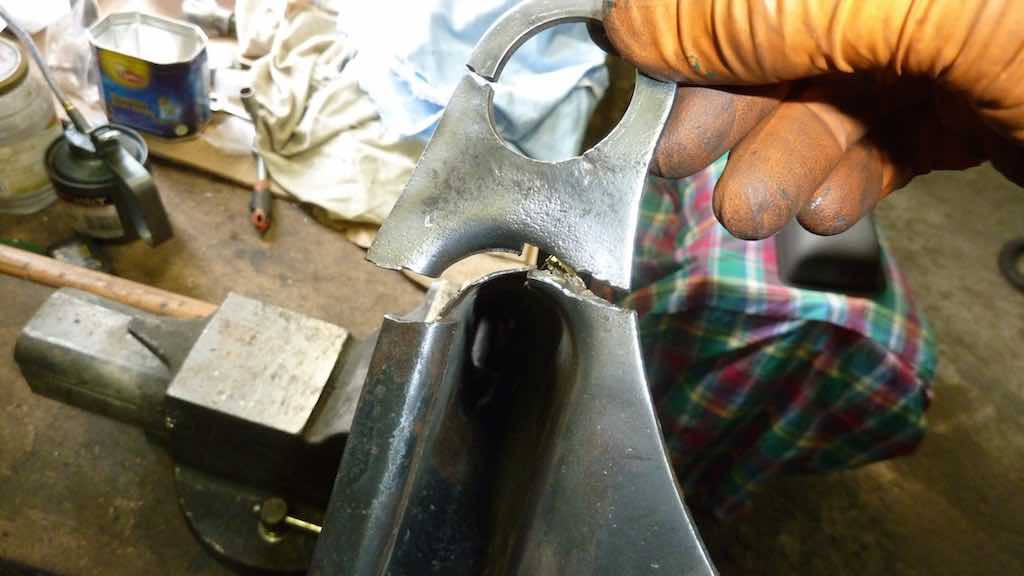

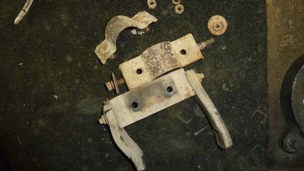

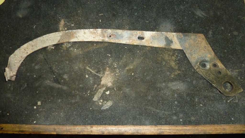

My bumper bracket has had better days. The right one had snapped and cracked the left one just had cracks in it. I think the previous owner really did learn to drive in it. The rear of the car has quite a few dents and bumps too.
I have welded this up now and they are in paint drying for tomorrows finish coat.

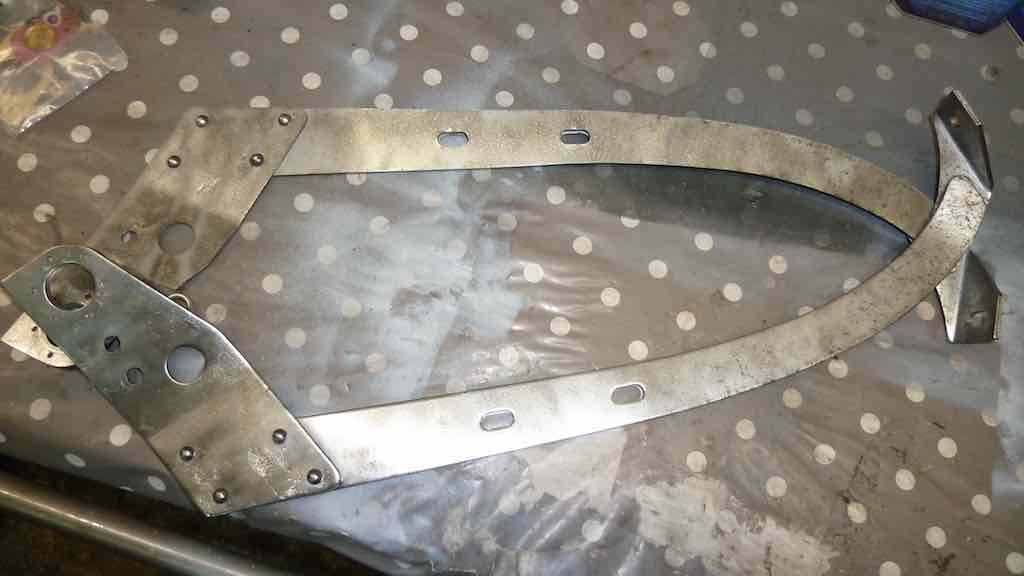

The next parts on the list are the wing brackets - these seem to be twisting in every direction as well. But other than dirt and surface rust they are in pretty good "structural" shape :lol:

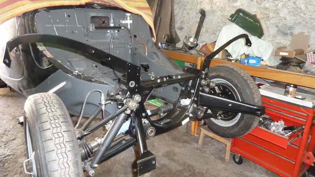

Lots going on today. I fitted the front wing supports and the bumper supports, mainly to get them off the bench but I bet I will regret it later on when I have no shins left. :lol:
Of course, they were cleaned thoroughly, primered and painted.

Back on the car

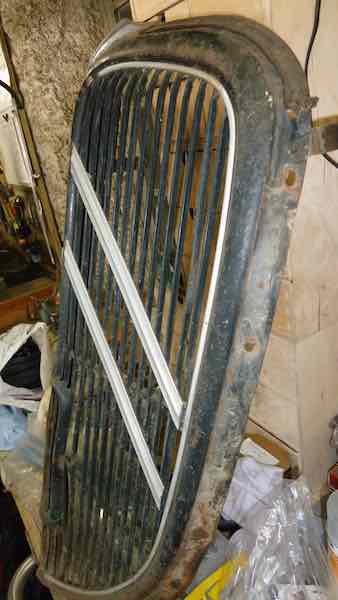

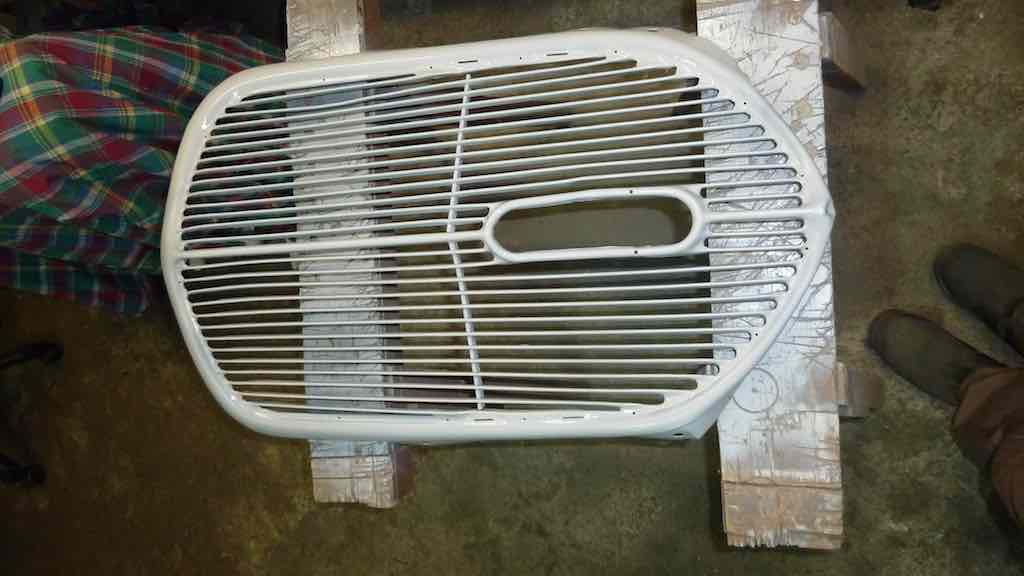

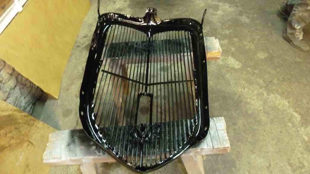

The grill is not in bad condition. A little out of shape but no rust at all. Here it is pre blasted.
And afterwards with a coat of primer to protect if from the damp air.

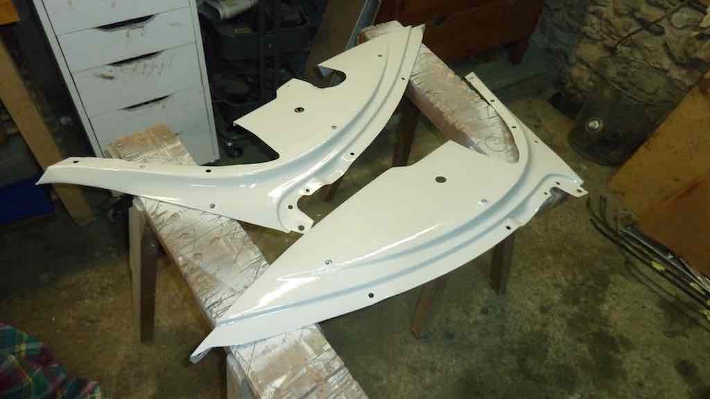

And the inner wings too

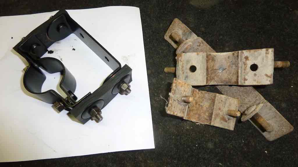

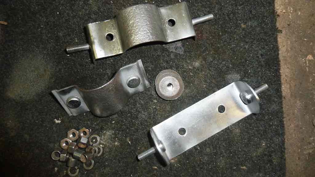

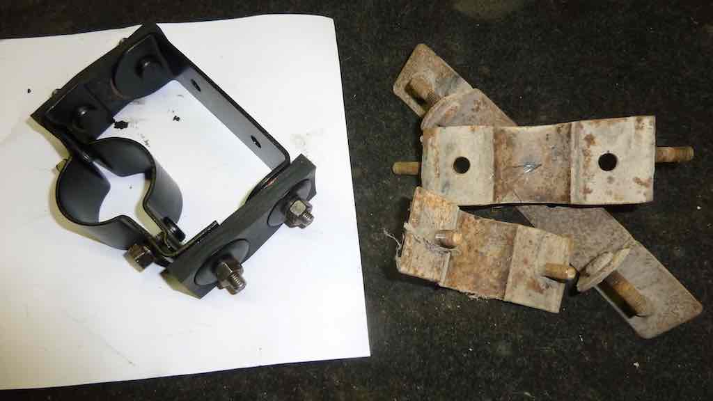

I started also on the exhaust brackets - at first I was going to throw them and buy new but when I saw the price at nearly €30 a set I decided to spend an hour cleaning and painting them, only renewing the rubber bands.
A little micro sand blasting and wire wheeling later.
And some paint

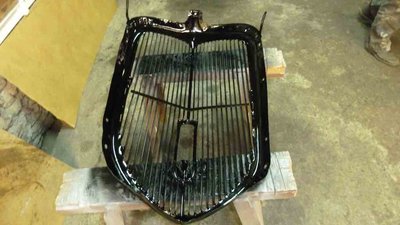

Put the first coats of final paint on the front grill - remember this is purely for protection for the next year. The car will have a respray at some point in 2016 but until then I just want to enjoy it.

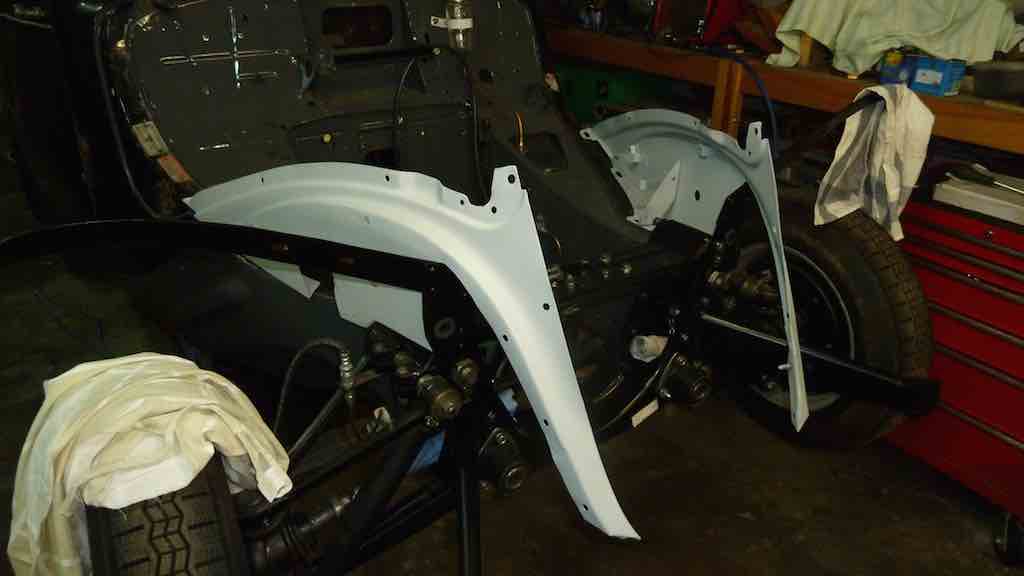

Placed the inner wings in position and they seem to fit back on OK. Will get these painted up tomorrow and fitted so I can start on the rewiring task.

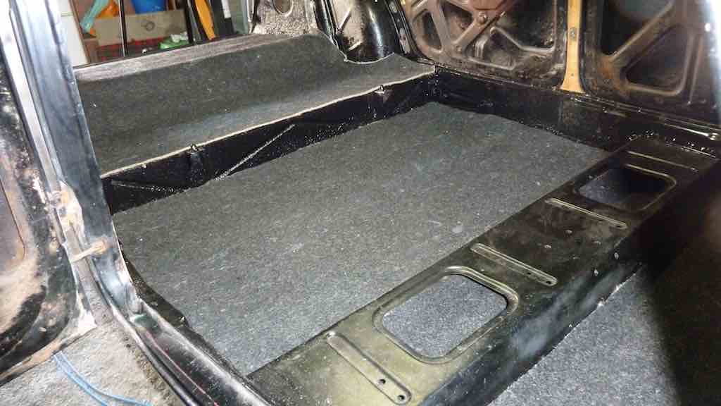

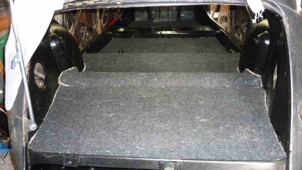

I also installed the underlay inside - This will protect the floor while I am working in there, but soon after this photo was taken I covered it all again with sheets and rubber mat, just to make sure.
This car is a little longer than a 2CV and the last re-carpet I did was on my 4L, just a tad smaller.
