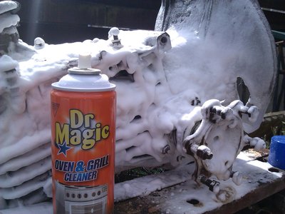

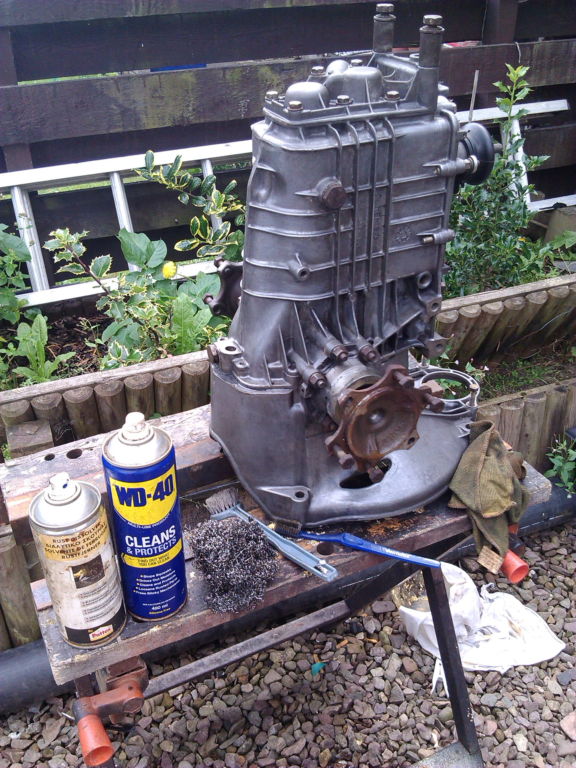

DrMagic oven cleaner from your ££ shop, B&M or the 99p bit in Asda brings engine cases up a treat as well as de-coking the heads ....best bit is it doesnt seem to eat the ally, rinse it off with hot water and then spray with wd40 and make sure its dry or itll end up furrier than those heads.
put the valves in a drill ( either pillar or just a B&D in the vice) and spin them up and de coke with a bit of hack saw and then either emery or steel wool to polish them right up.

Thanks Sean, I'll go down the cheapy shop tomorrow and get a load of that stuff. I have to get my vice restored before I do too much, reckon I'm going to powdercoat it white.

I couldn't find Dr Magic but I bought some other cheapo pound shop oven cleaner, It's not too bad but I'm still going to have to pressure wash the engine to get most of the crap off. I reckon there's good money waiting out there for the person who invents a spray on engine cleaner that makes all the accumulated shite fall off and leaves the engine shiny and sparkling with absolutely no effort at all.
No Asda near by :| soften the real claggy bits with brake cleaner first
