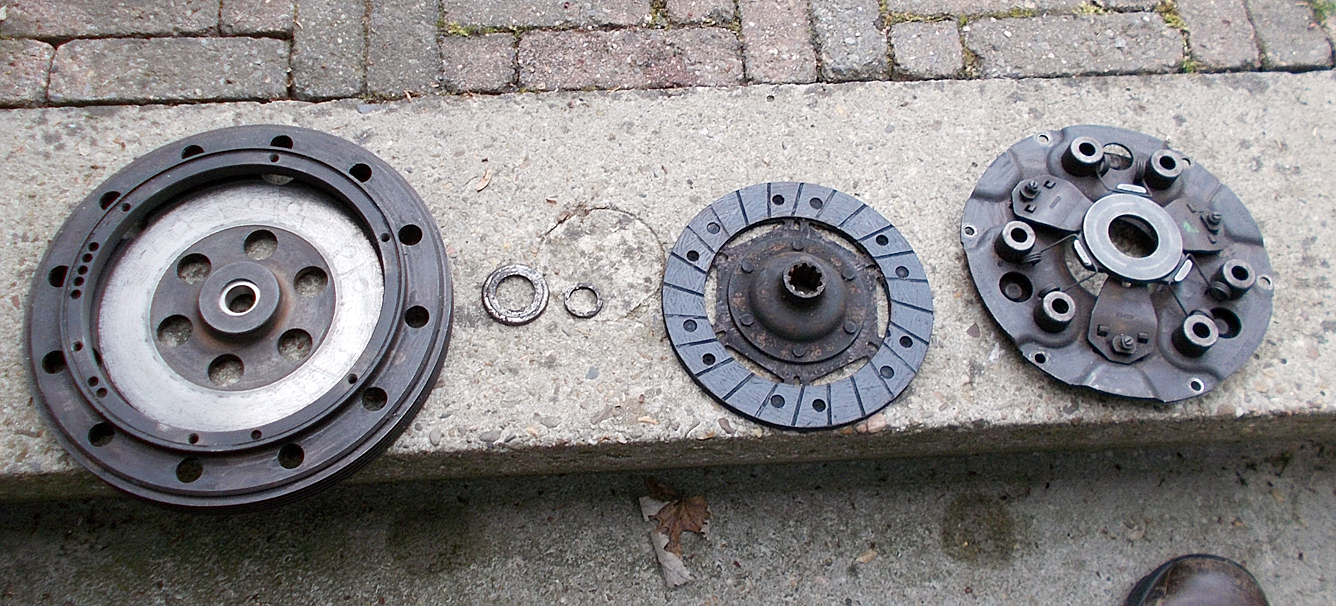

I am preparing a "new " centrifugal clutch unit for the green 57. Geo helped me cleaning the clutch drum on the lathe. THANKS. ;)
Here all the units parts only thing not here the special left threaded so called H-nut and the centrifugal clutch shoes who are on the cars flywheel.

Cool! Never driven one. But I want it on my - 58. A couple of days ago I got a complete centrifugal clutch unit, just need to find a box with the threaded input shaft. Or maybe just a shaft and change it?
How many different versions are there?
Vennlig hilsen, Eirik
And a Heinemann Z412 -80
April 26th, 2018, 7:30 pm
Posts: 2290
Post Re: AZL 1957
As far as i know there are 2 versions one for the 2cv and one for the ami. De difference is in the centrifugal shoes those of the ami are a few mm wider. But with some extra rings between engine and gearbox you can fit them too. And the later versions have a clutch plate with more smaller spline. You can swap the input shaft but the front bearing of the gearbox has to go out. There is a specially shaped tin ring that holds the oil back. Between engine and gearbox are thick spacers. It's nice to drive in city traffic. But in off-road conditions it can be a pain in the ass. The clutch cuts of at low revolutions. In mountain use it can be tricky too.
