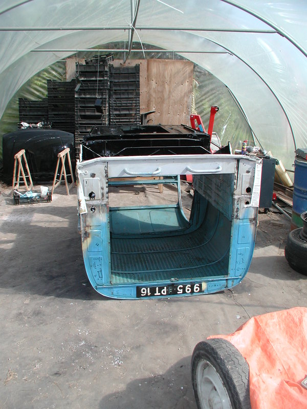

Is it ok to roll/flip a van body on to it's roof to work on the underneath? Provided it's sitting on mattresses.
Harley
Ask Geert here on the very forum too
He did it even without Matrass :lol: :lol: :lol: :lol: :lol:
A Matrass can catch fire when welding/grinding..

No matresses !!
It seems that if they catch fire they burn like hell!
You could use old tyres

lpgo wrote:
Harley
Geert, did you brace the body shell before you rolled it over?

Smiffy, I braced it before I took the shell from the chassis , as you can see in this picture.
ImageOnderzijde by geert1953, on Flickr
The most difficult bit is to turn it on one site. I used some old tyres to support the A and B post and the back of the van while turning over.
Best is to have some help .
The last bit ( turning it on the roof) is much easier , but you need some help as well to prevent the car rolling over and ending on the other site instead of the roof.
Mind you, you need some space to turn !
Shall I come over and give you a hand ?

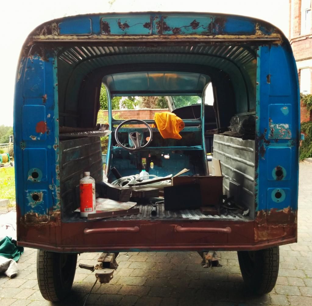

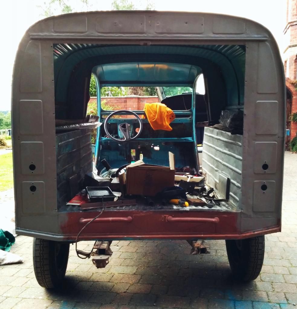

Quick rub down.
Nice bit of undercoat.
