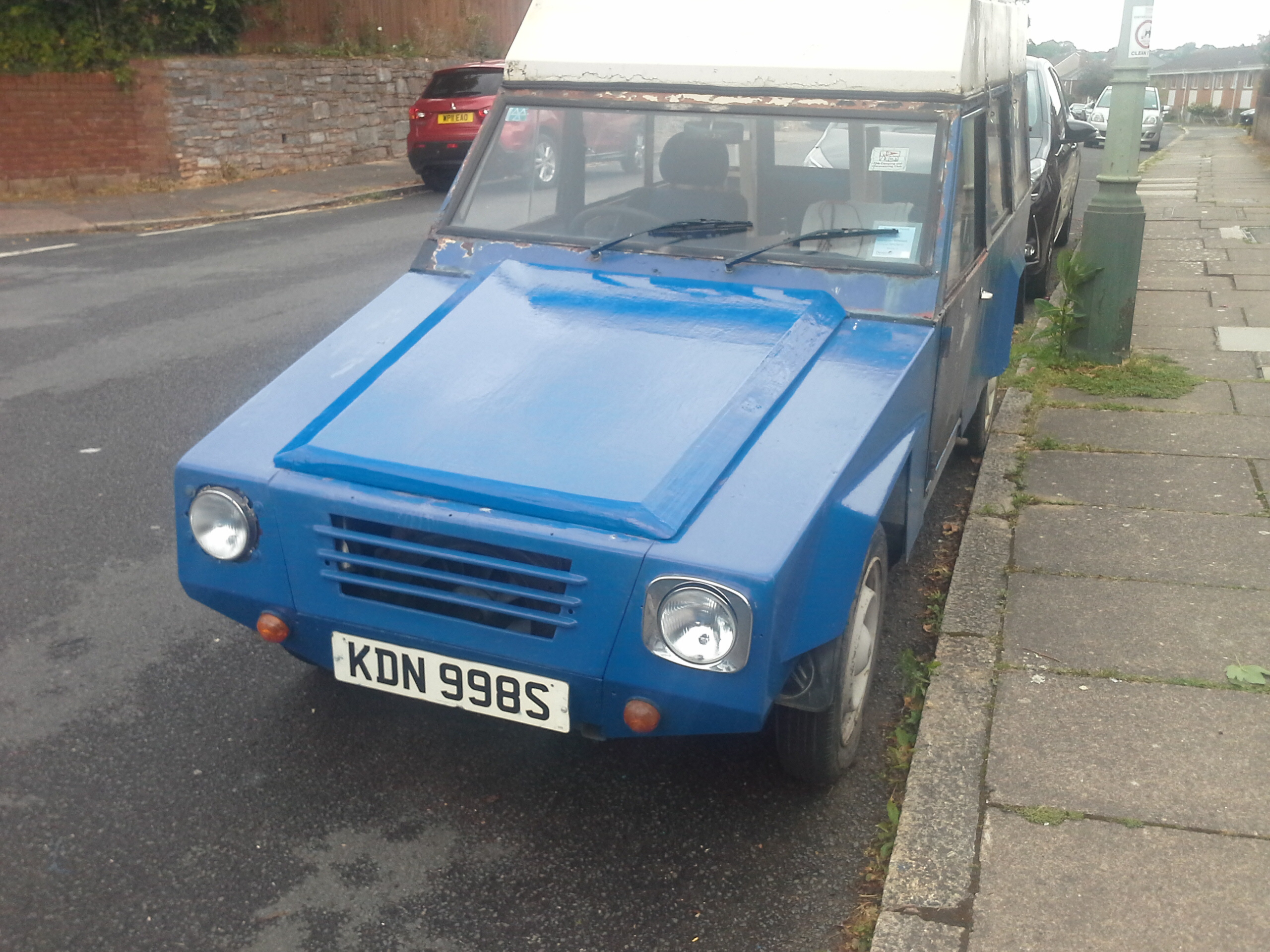

Some more progress.
Though, I think I will wait for the wind to drop before attempting to wrangle with an 8 x 4 sheet of plywood. :lol:

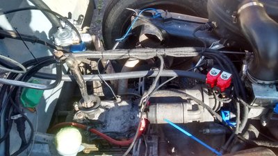

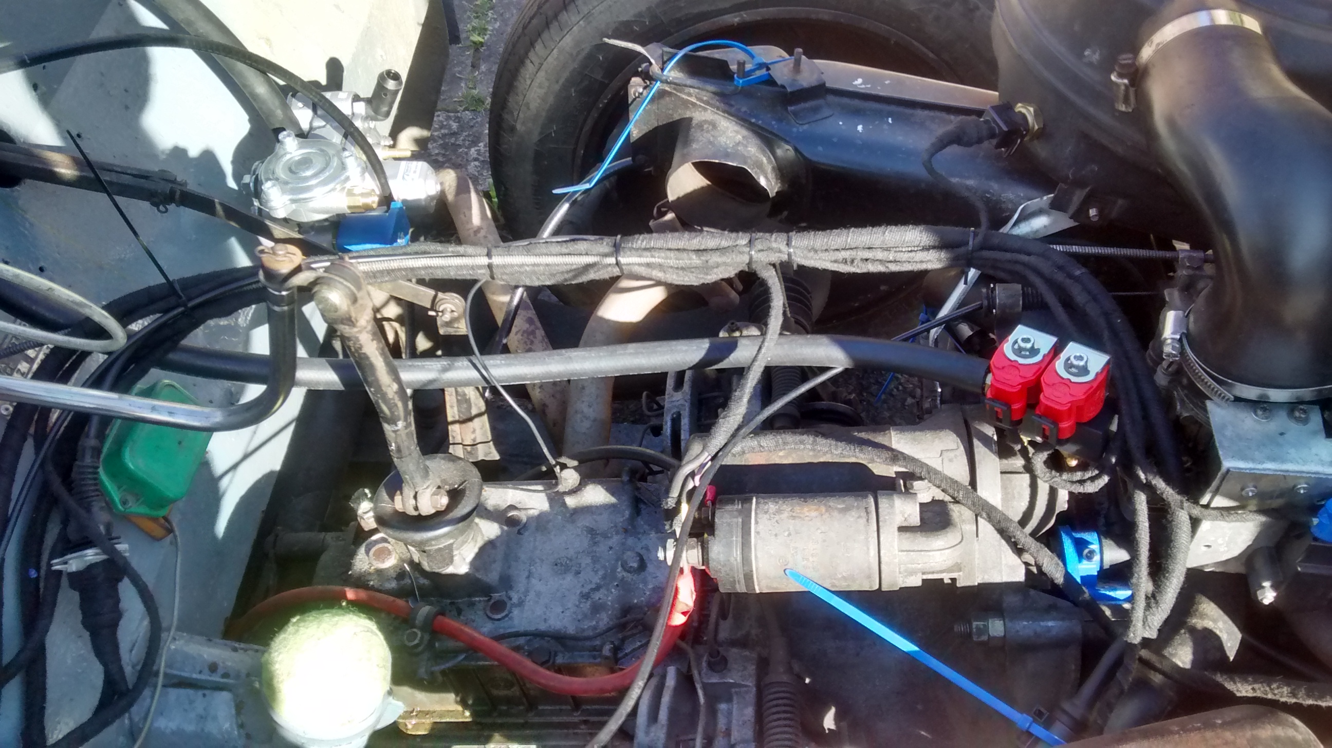

I'm wating for some waterproof electrical connectors for the head lights to arrive in post before I put the bonnet on.
I am reluctant to take any more off, before I get the bonnet done, so tidied the wiring a little in the engine bay. I've put the lpg injectors and reducer in place to help determine the routing of the wiring loom.
I ended up taking the dash out to remove the old head light loom. I was never very happy about the head light wiring going over the engine. So it will go down the bulkhead, along the chassis to one head light (and horn and indicator, then across the front to the other light And indicator.

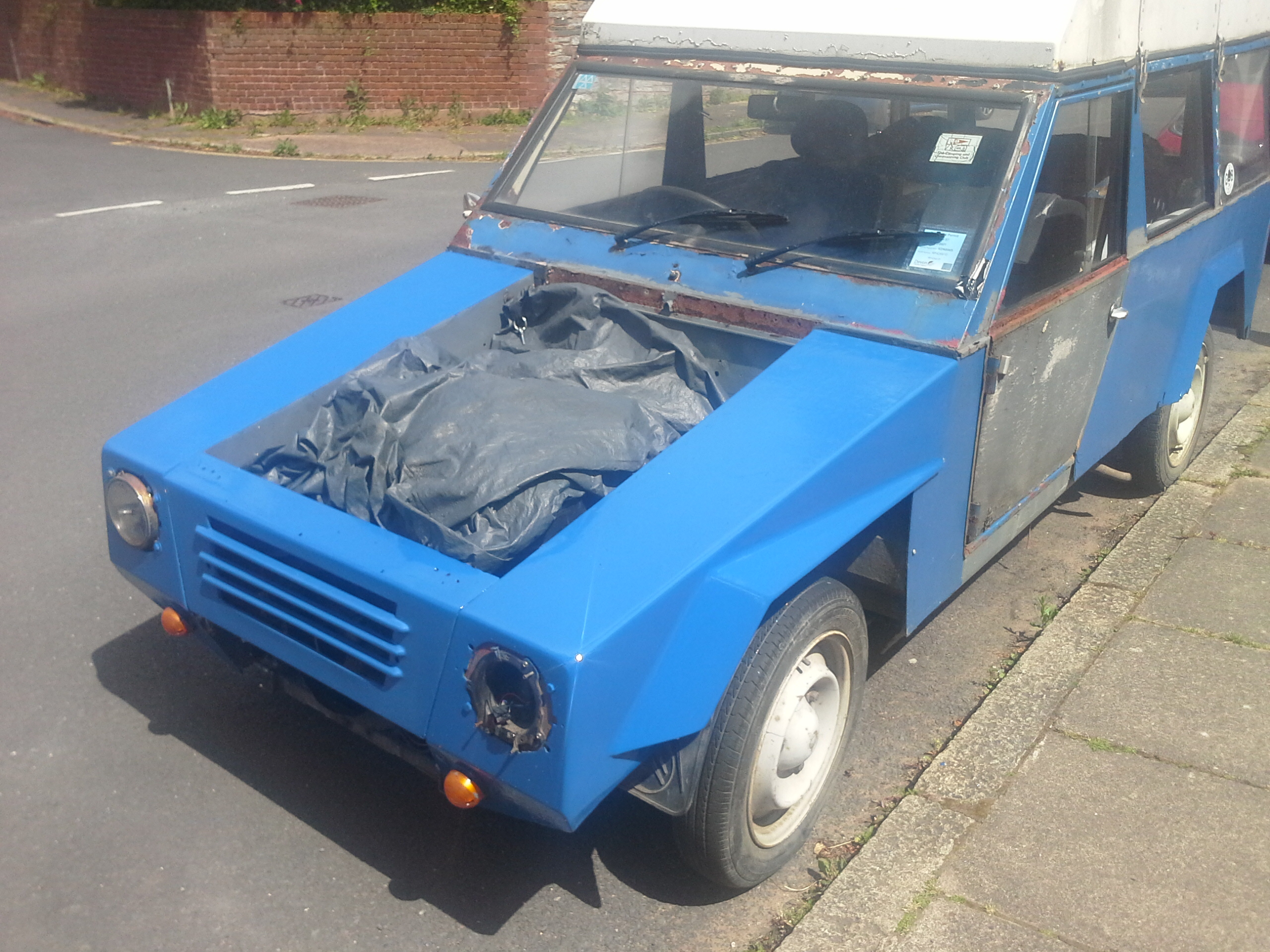

Starting to get the front end together. :)
