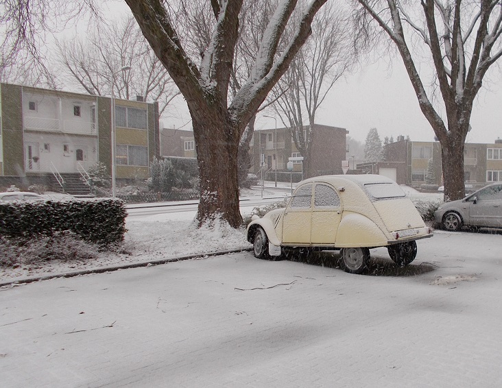

Post Re: AZL 1957
Ready for winter service.
