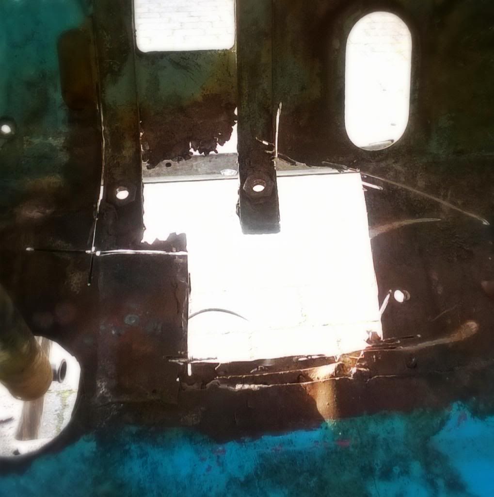

Finally got some time to work on the van yesterday.
After my slough of despond concerning the bulkhead last month, I went back and had another look. It wasn't as bad as I'd feared. In fact, it's really good, apart from a section around where the pedals go.
So I got busy with the impact wrench and angle grinder, and cut out the rot:

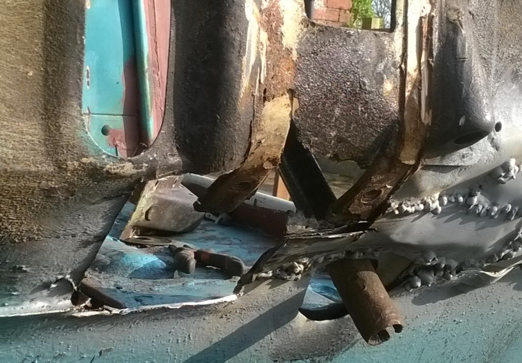

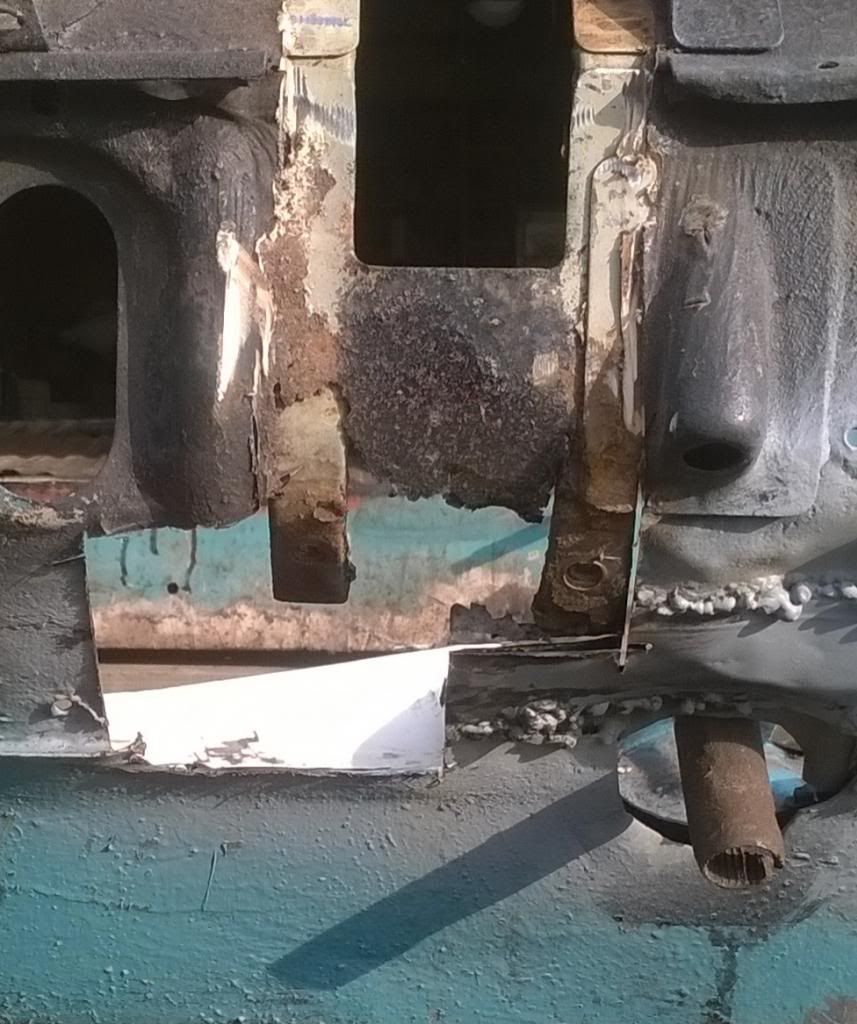

Then I carefully welded new bits in place. Setting the Portamig to lowest setting really works well on thin A-series metal.
Forgot to take pics of the end result... I'll bag some later in the week.

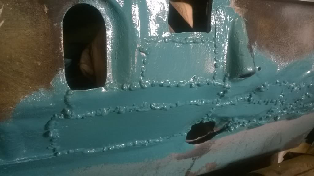

Whilst I'm full of admiration as you're clearly more fired up about fixing your 2cv than I am mine, but I think you'd be happier with your results if you bought a few abrasive flap wheels/soft pads/sanding pads (different people use different terms) and ground the welds back the welds to smooth it off.

Post Re: 1976 AZU250
I agree, it looks so much better and it gives you more satisfaction.
You're absolutely right, and I will be investing in those items in the next few days. However, like a kid in a sweet shop I wanted to try out the brushing paint that I bought last weekend! Totally arse about face, I know, but I just couldn't resist the satisfaction of painting. Also gave me a great opportunity to make little lights flash in my head off the fumes.
Another thing: for the first time ever it gave me the peace of mind of sealing the metal, rather than leaving it for months to fester before I have to spend hours making it good and rust free prior to painting.
Never been very good at strategic planning, me.
