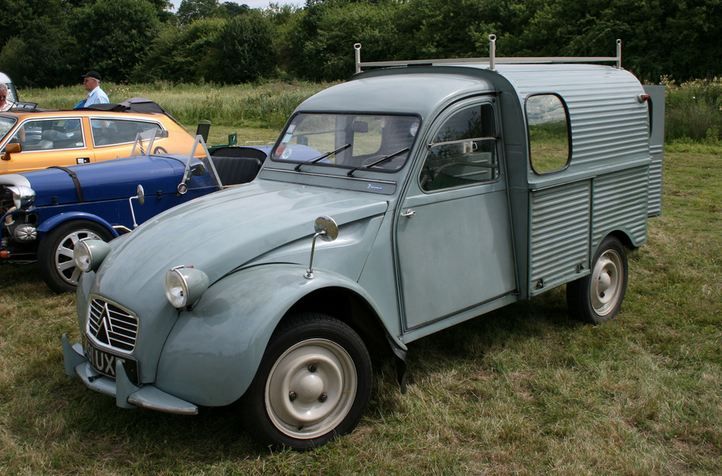

panelbeaterpeter wrote:
I'm quite set on Vert Cactee, AC 513
Warning: I'm very colorblind, but I don't think that van is Vert Cactee (registers day winner Brian Mark's?)
My van is two-tone Vert Cactee (AC513) and Gris Kandahar (AC133):
The van you've pictured, I'd say is AC136, Gris Rose. Note Gris Rose changed in September '67 to a slightly different colour and was assigned AC140 :ugeek:
Last edited by samfieldhouse on December 4th, 2012, 2:54 am, edited 1 time in total.
December 4th, 2012, 2:48 am
Post Re: My new 2CV, running restoration. In theory..
EDIT: My van is supposed to be AC513/AC133. I see that if you google 'Citroen vert cactee' you do indeed get a pic of Brian's van... interesting :?
For reference, Tim Jessop's very brightly 2K'd AK in Gris Rose:
