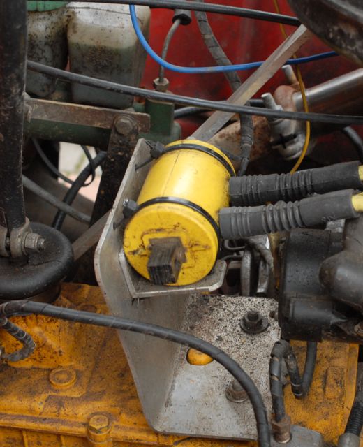

A solution for mounting a Harley coil
Thanks SP, I'm undecided between the gearbox & the aircleaner stay at the moment. I was thinking about how to keep the leads clear of the heat exchangers but I've found some suitable corrugated tubular metal tube which should do the trick. It's MOT time next week so I'll get that out of the way then see about the coil.

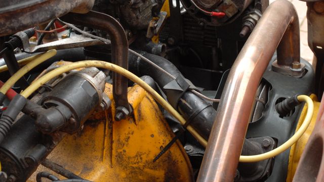

Hi BW,
Routing of leads.
I havent got heat exchanges now, previously this worked OK, the cable tie keep the lead in place.
Leads are not those that came with the coil as I damaged one pulling it off the coil!
The replacements are copper, can find the supplier "link" at the moment

Leads are Silicone!
http://www.vehicle-wiring-products.eu/V ... minals.php

I decided to have a go at fitting my Harley coil last night and decided to mount it directly under the air cleaner in order to make it central to both spark plugs. I can't seee any reason why it shouldn't be OK there but I have simply made up a short loom (in the yellow shrink tubing) that attaches to the original LT circuit in case I need to revert back to a standard coil in the original position. The car seems to run OK now having given it a good run locally.
