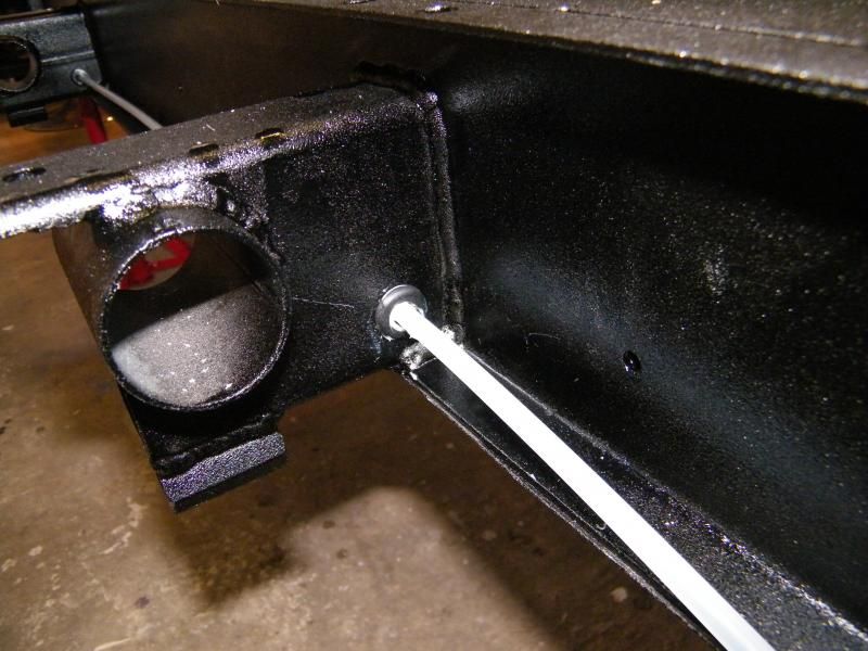

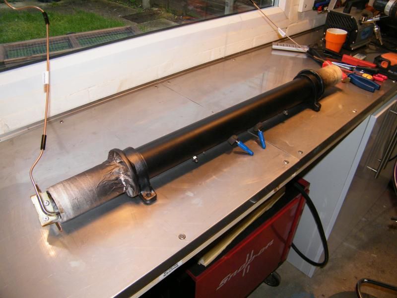

Done a few little jobs this morning. Fitted the rear brake pipes into the axle and fitted the fuel pipe along the chassis.

look great but didn't you have to put the rear wheelarms on it first?
November 17th, 2014, 8:49 am
I reckon I can get the arm over the pipe, but if not its only one nut to remove the pipe, it wasn't as hard as everybody makes out to get the pipe in the axle.
Well Russel that's because you don't have the arms attached ... :lol: :lol: :lol:
Now you have to bend the pipe to put the arms on. I wouln'd do that, the pipe can go out of model doing that, so then the corkscrew is rubbing against the tube.... and that is definitly a no go...
So take the brakepipes out put the arms on and start over and then you see it isn't as easy
(it can be easy if the brakpipe is made correct)...
bon chance
