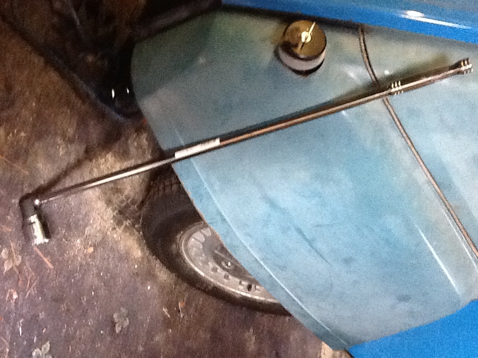

First some tool porn, bought this bad boy just to undo the fan bolt.. What a pig but it did the trick though!!

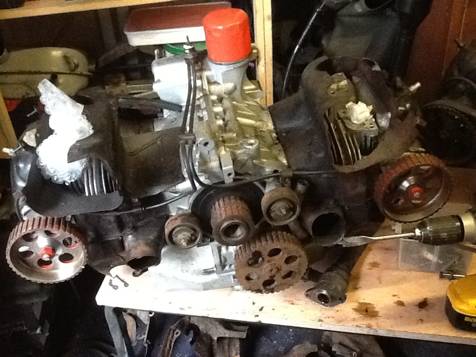

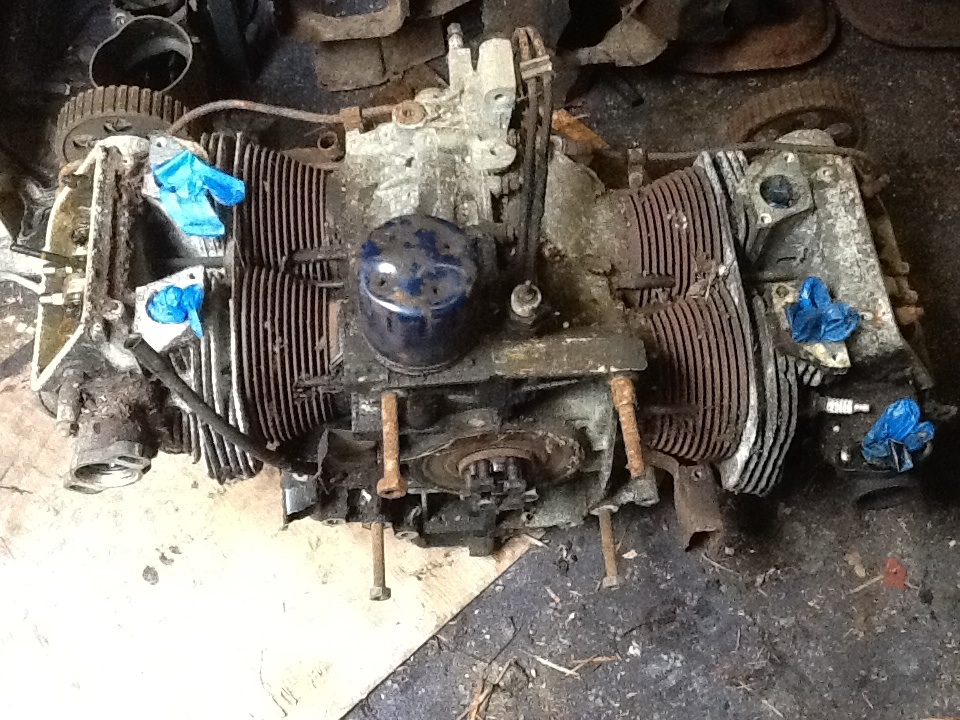

Next started pulling one of the now 4 engines I have, and started to build up one of the others, going to bench test it first before it goes anywhere near the car!!
Top one good one, bottom one shite one, been useful for bits though...
Just about to send the carb and inlet manifold off to get ultrasonic'd cleaned as they are in a right state!!
Was also thinking whilst its out getting the fly wheel lightened aswell, but seems to be pretty light already!! So don't think I'll bother!!

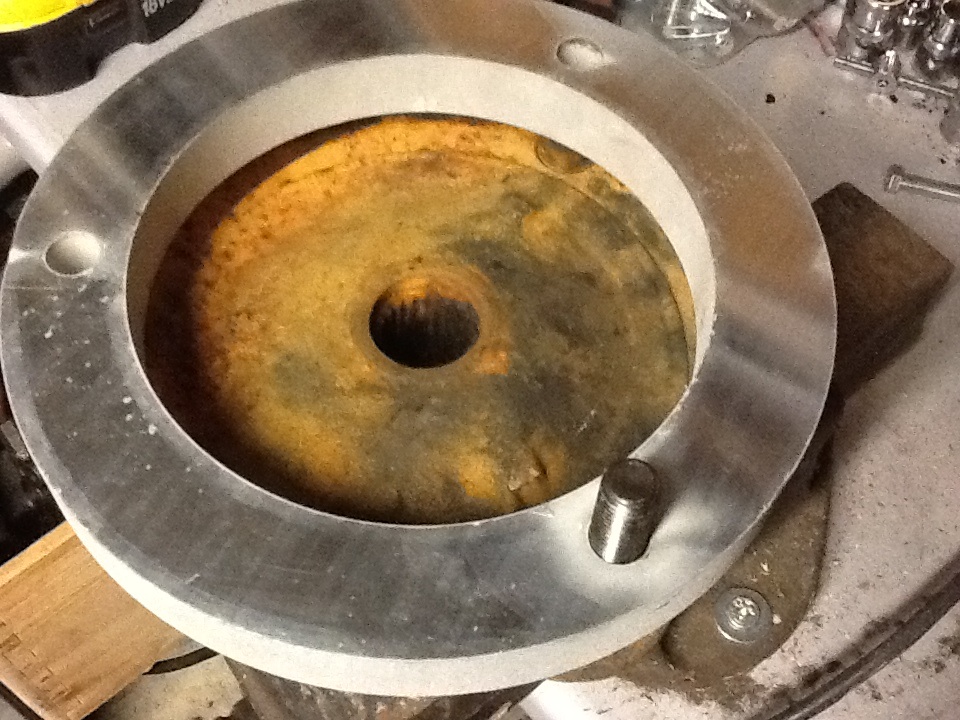

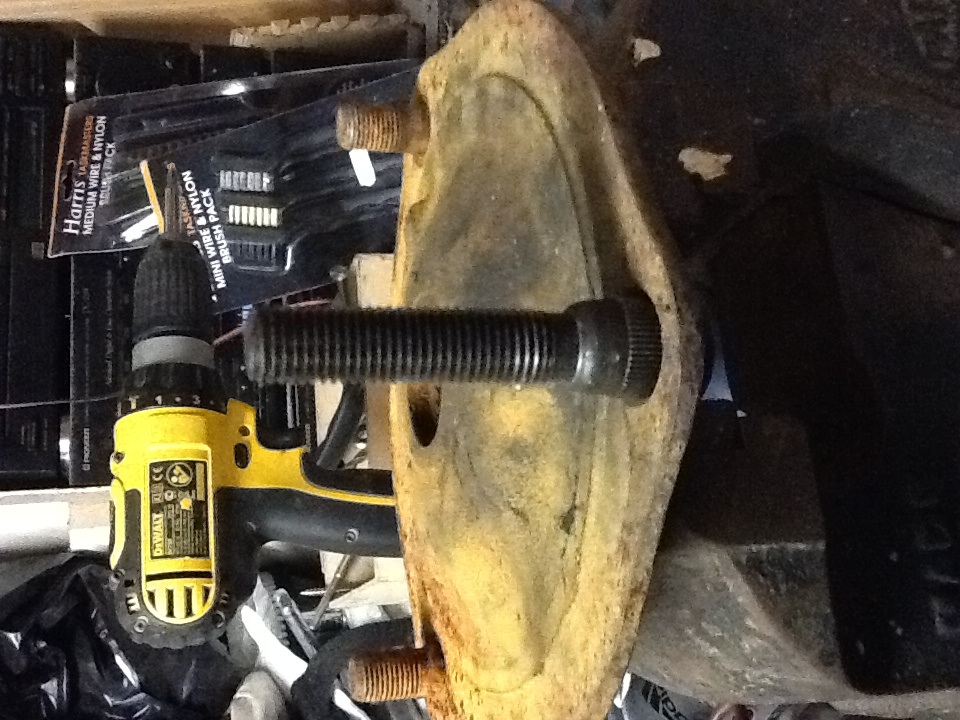

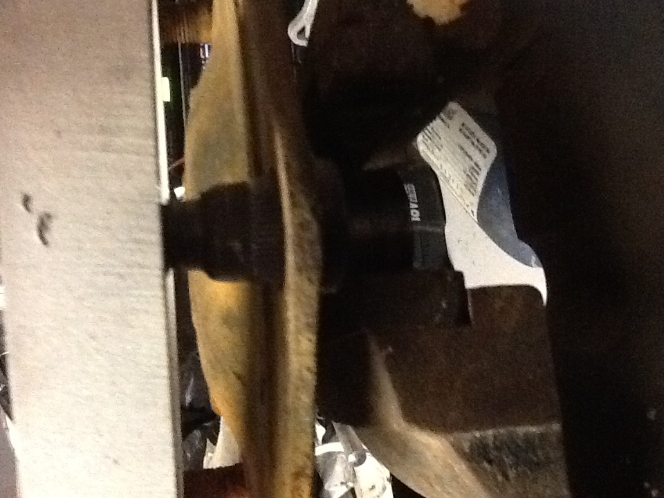

Then for joolz benefit have had a go at fitting the spacers, ran into problems though, the long stud I have found fits perfectly, spacer just doesn't seat down properly, will need to get the spacers drilled out at the bottom so the bottom of the stud will seat up against the hub nicely...
And the holes need opening up by a fraction aswell..

Good to see some action. I've had one of these spacers cut for myself now, and have just been having a play with it over the weekend. I was going to warn you that they were a bit tight on the studs, if I do any more I'll add a fraction to the hole diameter.

yes mine r a bit too tight, I've just given them to a friend to open them out at the bottom and open up the holes a fraction... Should be back middle of next week...
Got a few new engine bits on order aswell, and once the spacers come back, it will be time to strip down the front hubs and fit those big old studs!!
