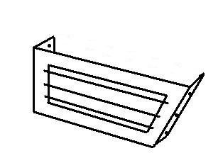

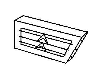

I'm going to have a go at making a flat front next week and see what I prefer I think Louise. I have been leaning towards the flat front, but then again the current one is unique and I like being different!!
The old Goat has suggested I could even incorporate some chevrons into the grill, so I'll see what I can come up with-what do you reckon?

I like the top one myself, Bertie, FWIW! 8-)
Look forward to seeing what you've managed to produce...
