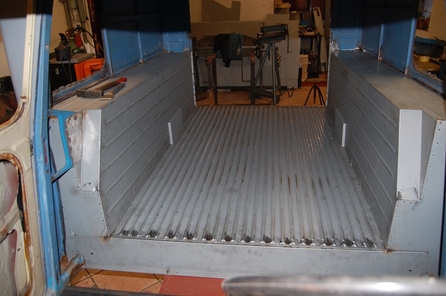

ACADIANE SIMON KAROSERIJA VARJENJE BARVANJE SESTAVA (156)1.jpg [ 200.54 KiB | Viewed 21618 times ]
