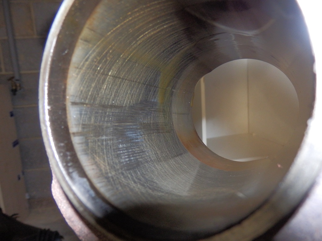

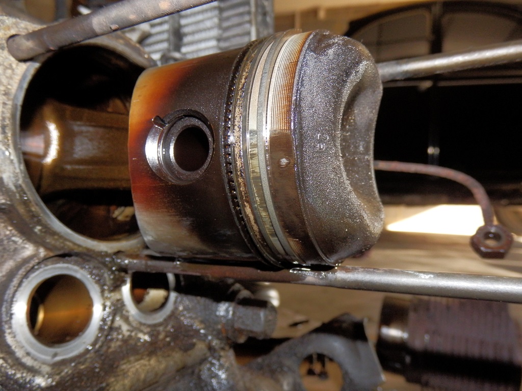

Hi guys,
Had a little bit of time tonight to get the barrels off and have a good look, and start cleaning. I had thought from looking quickly with just the heads off I was OK, but this seemed to stick out to me.
This is my first time doing proper engine work, but this looks out of place to me. Is this too far gone, or am I worrying too much?
Thanks.

Post Re: 1985 Black Spécial
The barrel and piston in those photographs show evidence of a partial seizure, most probably due to overheating from over-advanced ignition timing, with the top ring and scraper ring looking to be 'nipped' in their grooves and also 'scuffing' of both the piston and barrel.
There's staining due to excessive blowby showing below the oil control ring as well.
Time for a new set of barrels and pistons, as well as adjusting the timing so that this doesn't happen again, unfortunately... :(
Thanks Ken, more shiny new bits heading my way from ECAS it seems. Hopefully when I get it back together it will be better than ever. :)
